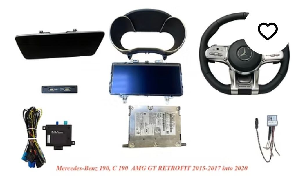

The NTG 5.5 retrofit package include an OEM IC, OEM Comand 5.5 Head Unit Unit, OEM Middle screen and wiring harness/adapters. It costs $4k from CryptoAutoService. They are an official partner of Carsystems who manufactures the retrofit adapters for the IC and Steering Wheel.
You can do installation yourself if you are comfortable removing the IC, Radio Unit, and middle screen. Otherwise you can pay a shop to do it. It will take 8-10 hours of labor and requires modification (cutting/trimming edges to fit perfectly in our W190).

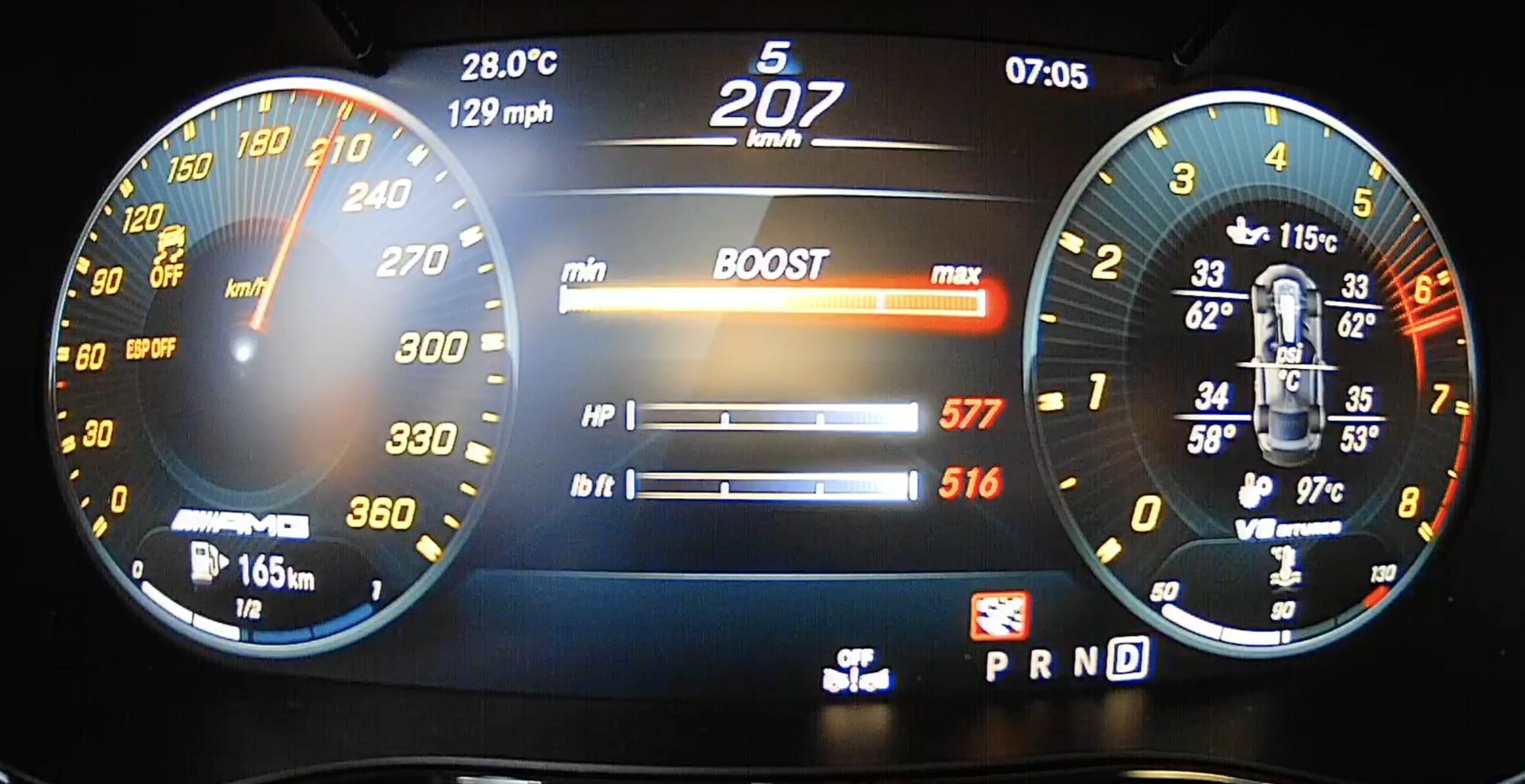

Originally Posted by sevenhead
I like the tach front and center. I would like to see the oil and gearbox temperatures in that side panel
I like this view with the speedometer on the left and useful information on the right side. For the middle section, I usually have odometer or music so I can easily toggle between songs with my steering wheel buttons.

I like this setup, including for on-track usage:
