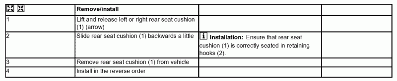

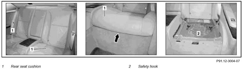

How do you remove the rear seat in a 2007 s550.
Attached Thumbnails S550 rear seat removal-w211-rear-seat-back-1.jpg   S550 rear seat removal-w211-rear-seat-back-2.jpg   S550 rear seat removal-w221-rear-seat-back-3.gif

Seems that CL w216 has the same system how the center storage is held in place, can someone tell what kind of tool is needed to remove it and what is the right direction to push? I've tried with small screwdriver but no luck. Driving me crazy and don't want to break anything.
Thanks in advance.
