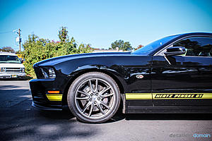

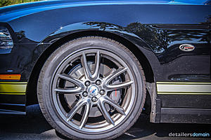

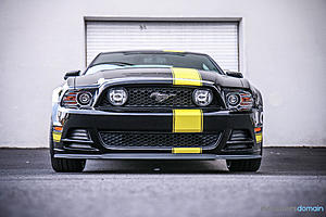

Before

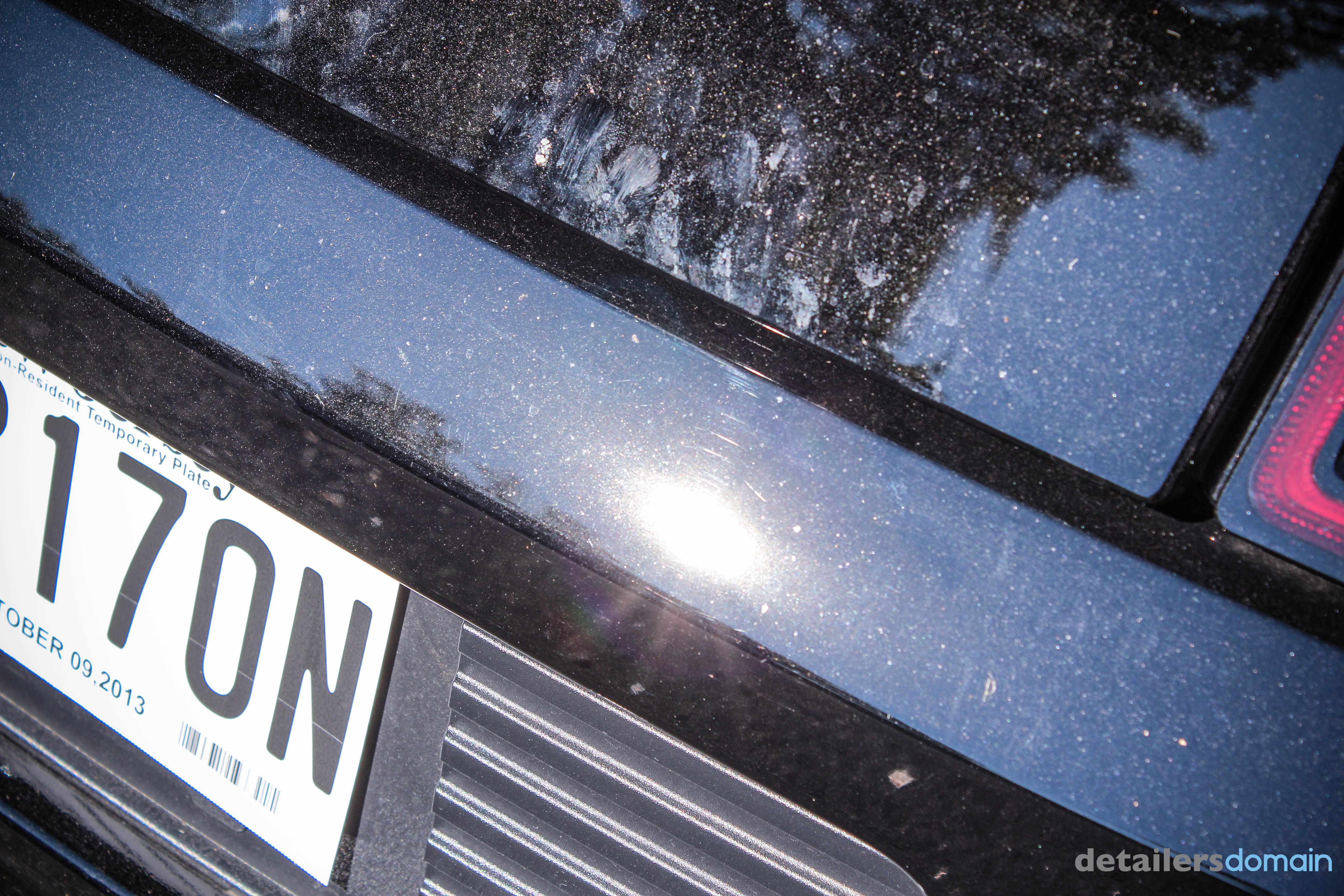

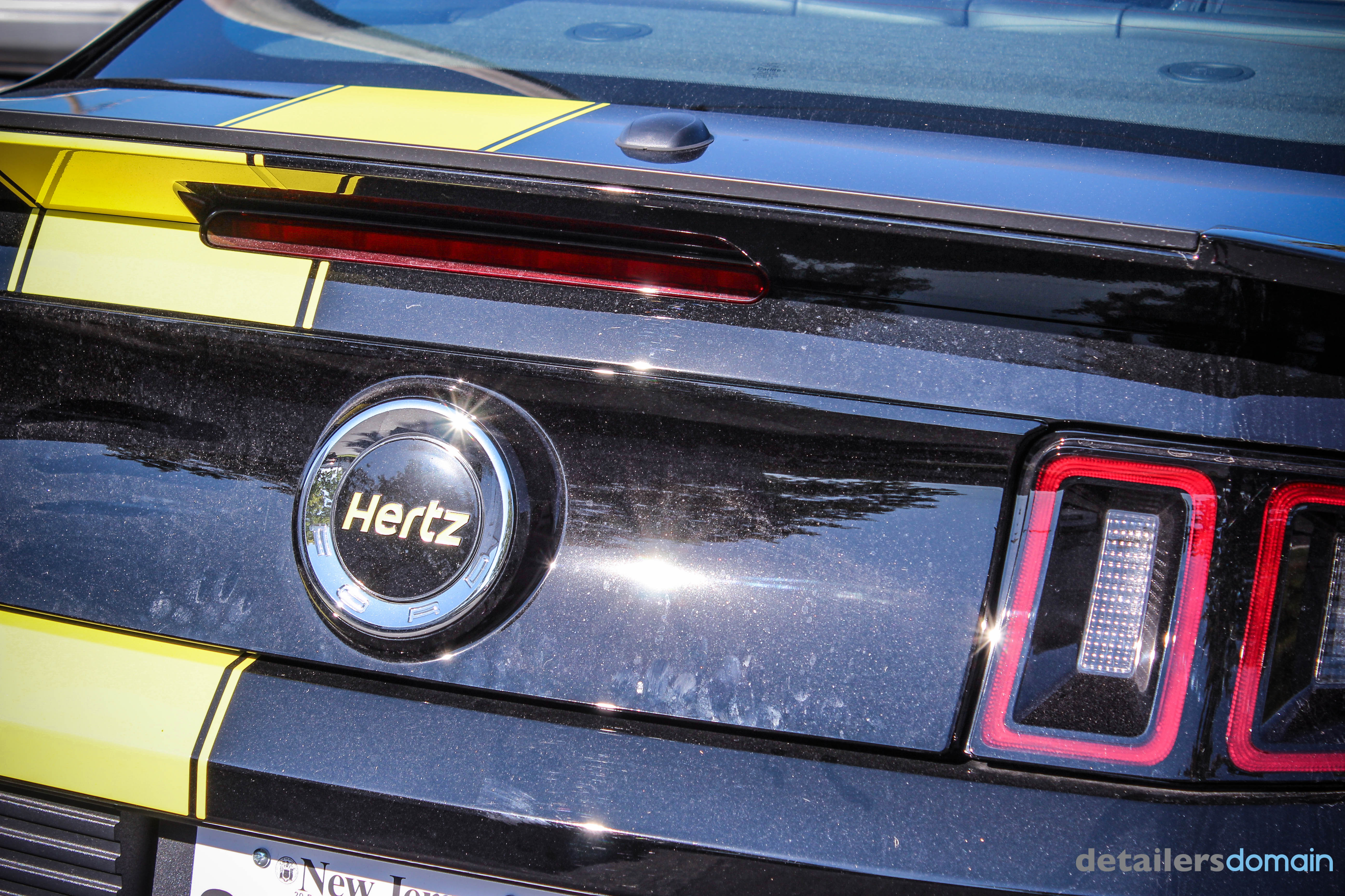

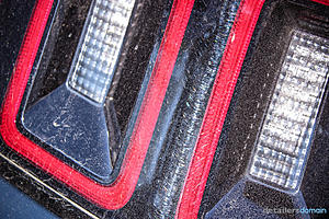

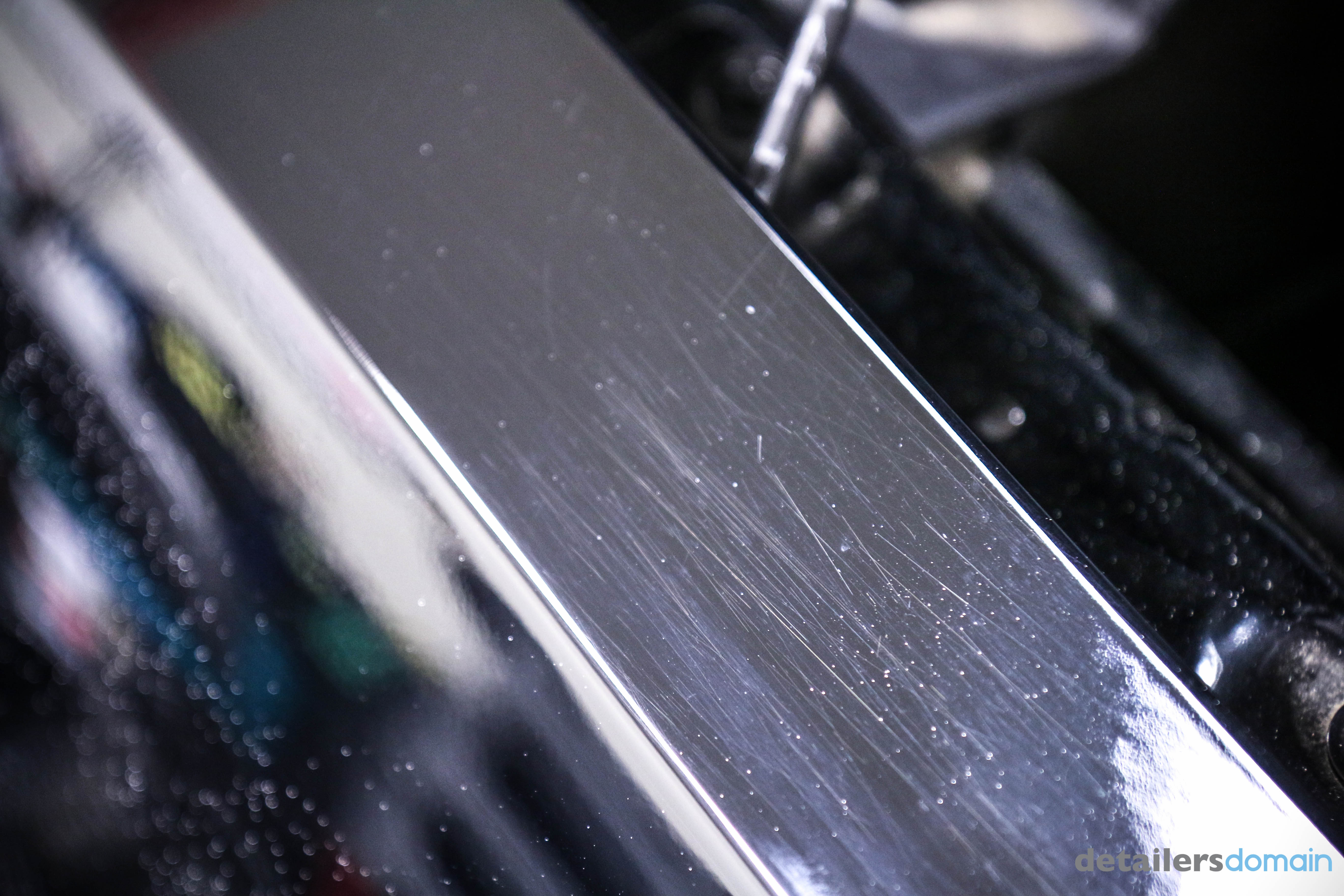

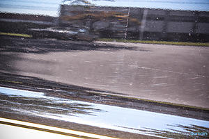

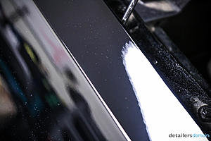

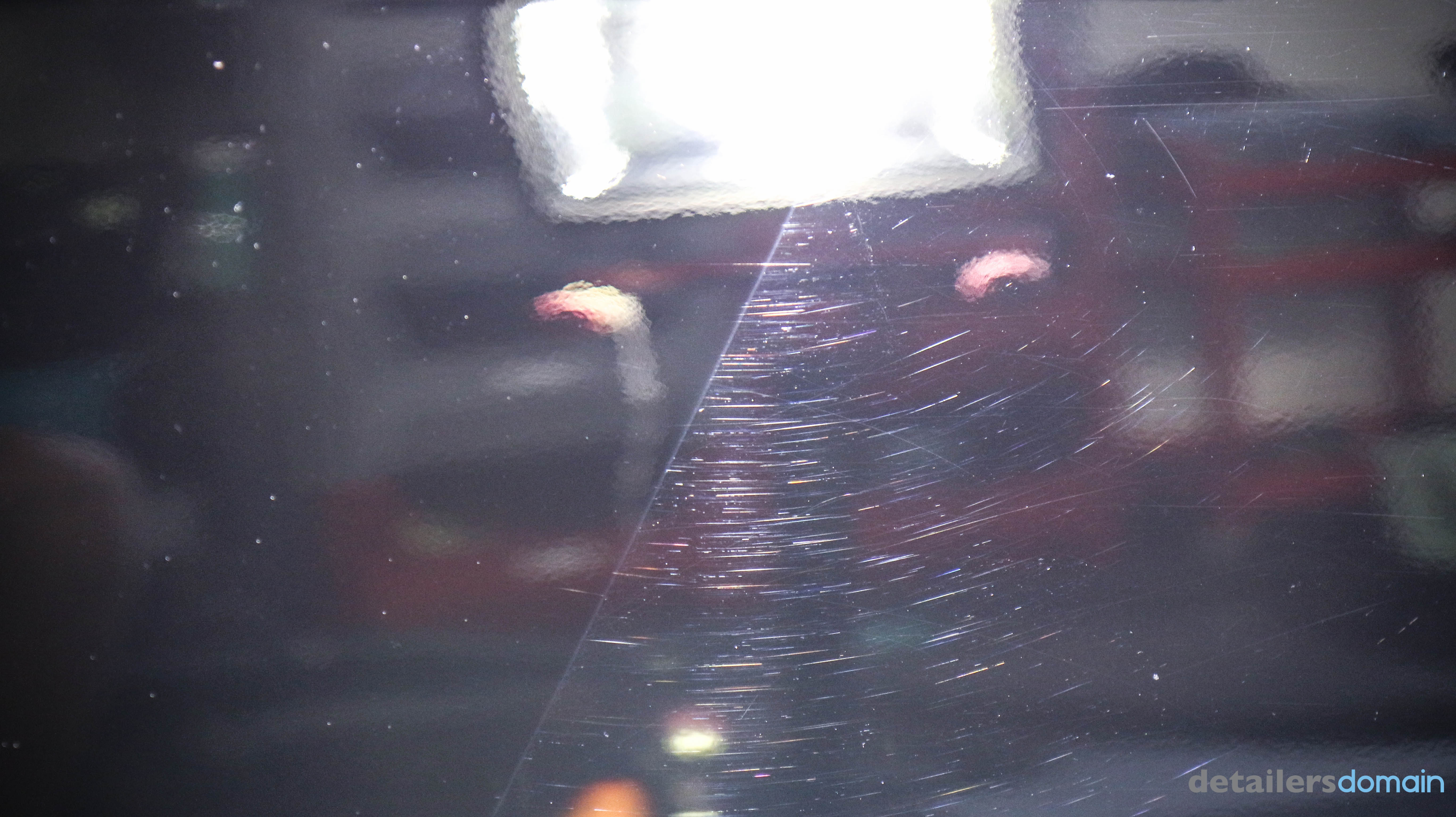

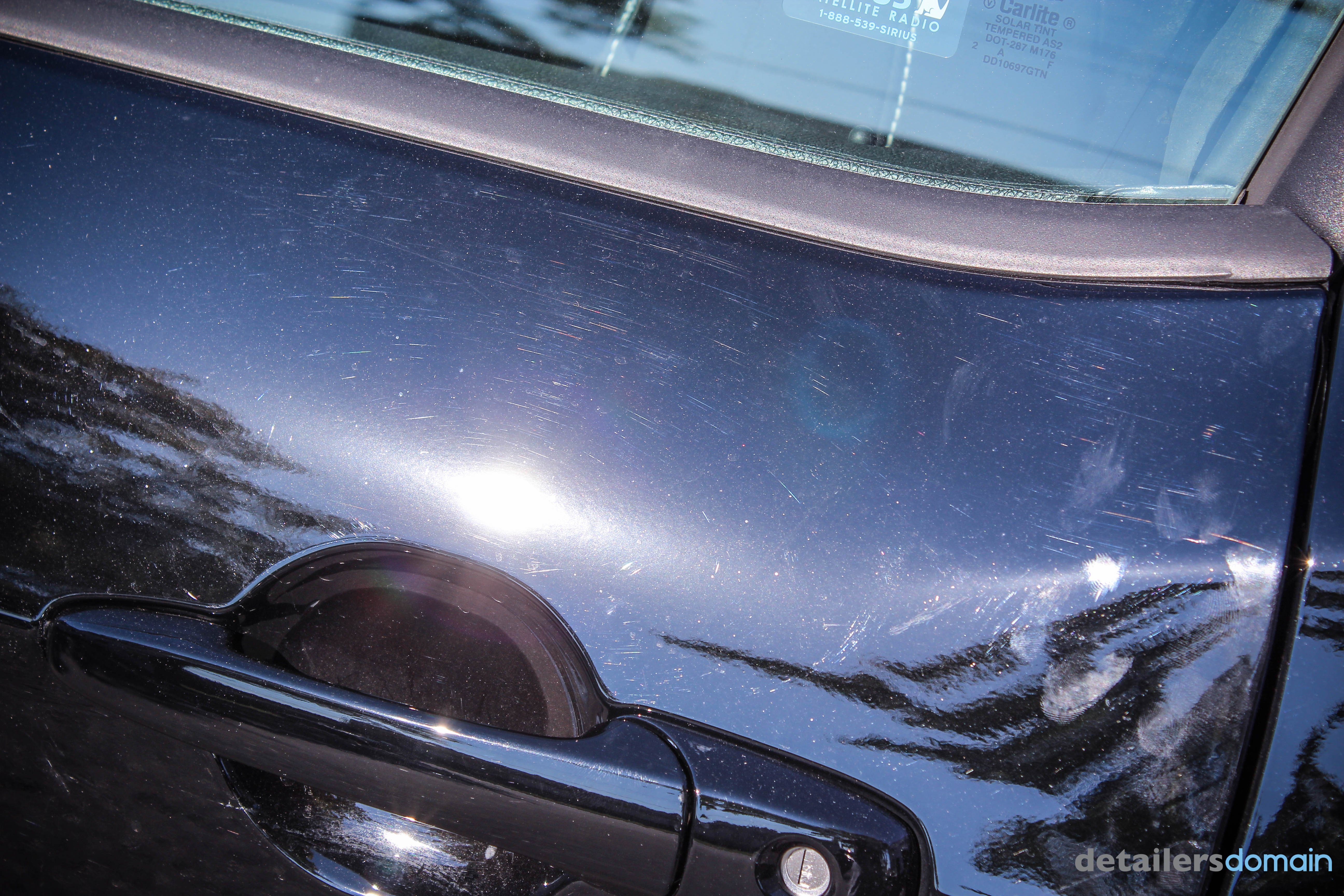

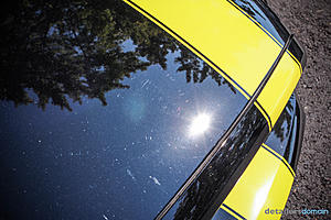

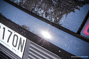

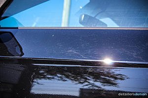

Defects and imperfections were all over the car. Rids, swirls you name it.

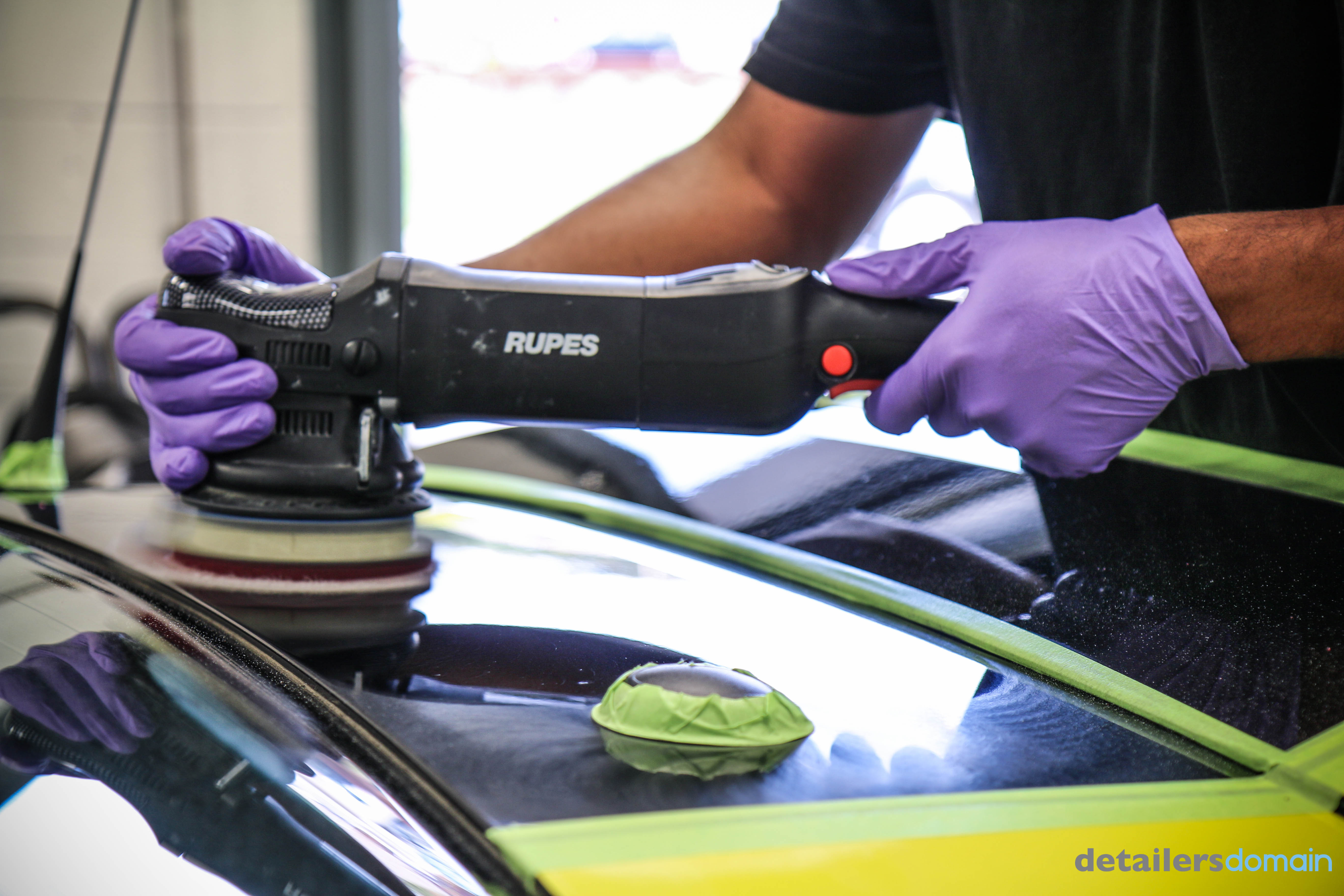

Paint Correction - Compounding and Polishing were necessary to remove paint defects. We were able to use the Rupes LHR21 in combination with Menzerna FG400 and a Meguiar's Microfiber Cutting Pad to remove the defects. Sonax Perfect Finish was used to bring out the depth and gloss in the paint.
