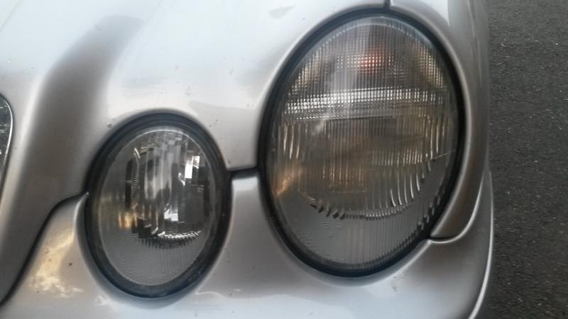

Its a common problem with polycarbonate headlight lenses.
They mist up
Not with water, but with gunk and look like this;
So what to do?

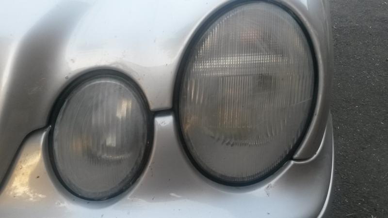

When the bride bought the CLK, the headlamps were a mess. We bought an expensive headlamp restoration kit and spent hours working on the lenses.
It only cleaned them up a bit. They were still awful and useless at night.
Until the other day when I got out a bottle of METAL Polish.
Certainly it is more abrasive than glass polish, and care really really needs to be taken around paintwork, but the result speaks for itself.

Just what i was going to say a polish up with cutting cream .

I also needed to use wet-dry sandpaper on my E320 lenses to cut to a polishable clarity. After that I used plastic polish on a drill buffer followed by paint sealant.
