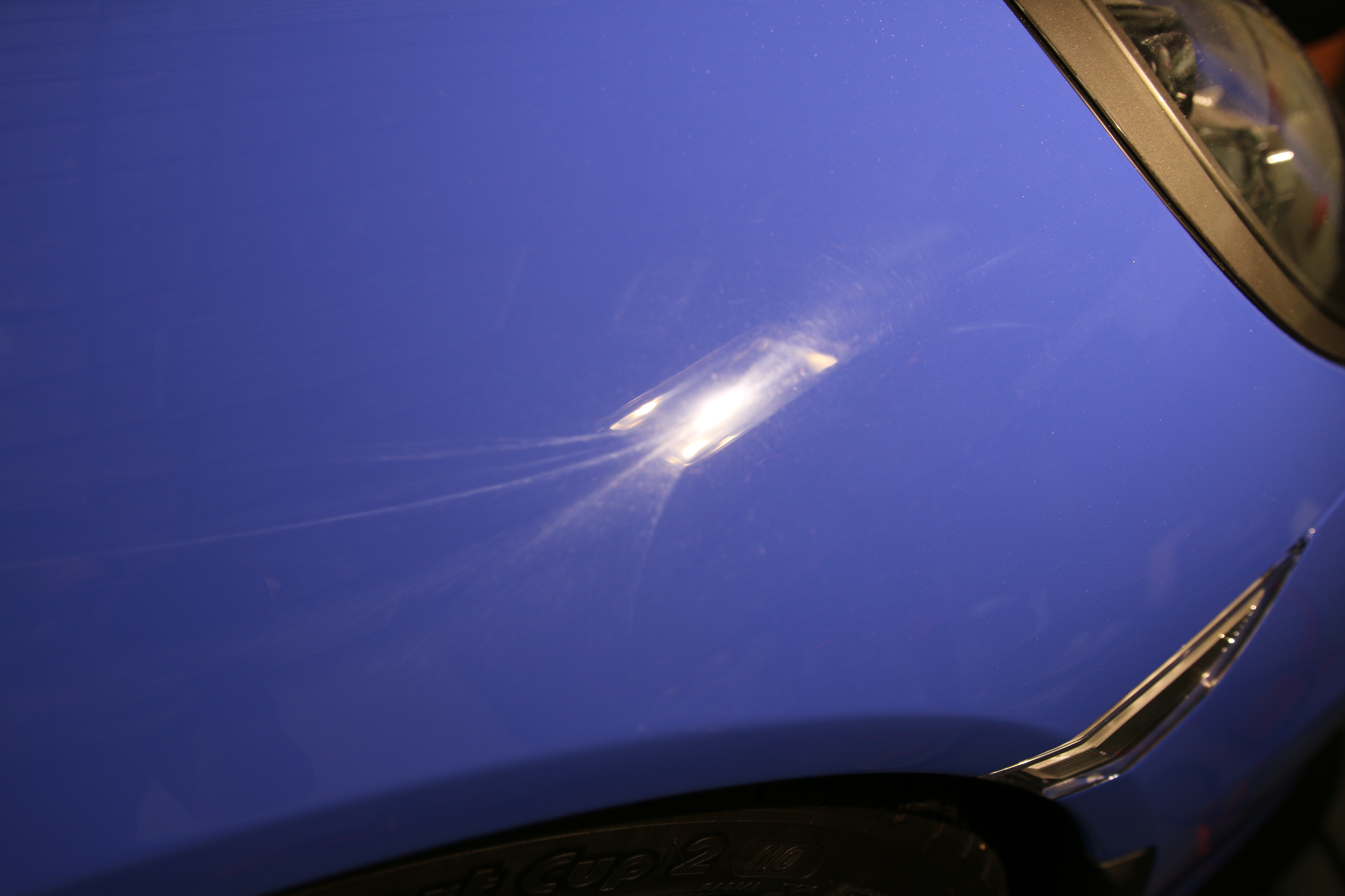

We were lucky enough to work on this very rare paint to sample Porsche 911 GT3. This Maritime Blue Porsche 911 GT3 we believe is 1 of 2 in North America. (would love to see the other 1 or others out there) We received this car in pretty bad shape in much need of a full paint correction. After a full paint correction we were able to bring out the color with Modesta BC-04 a glass coating that seems to make everything look like a hard candy shell. Take a look at our process. I hope you enjoy as much as we did.

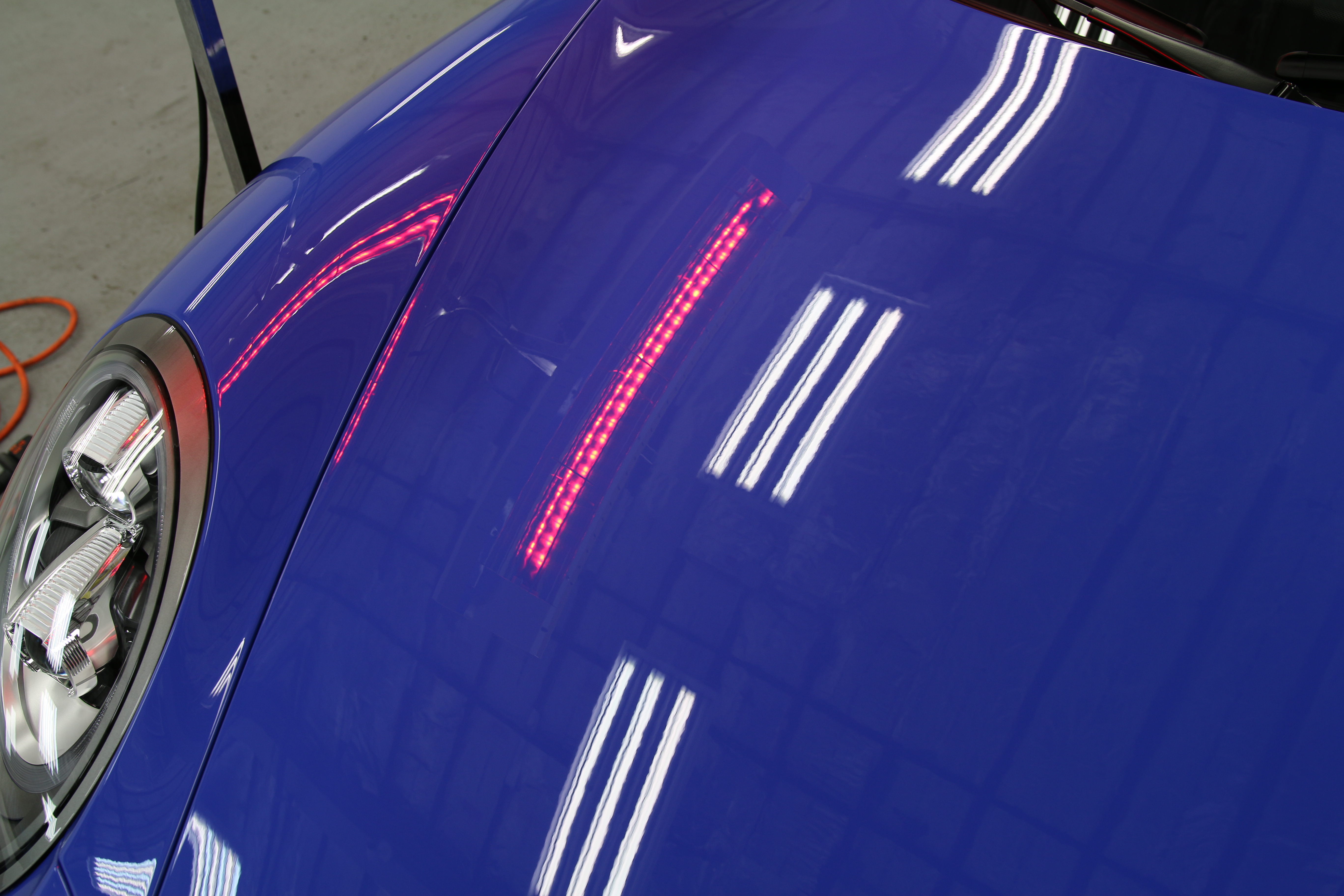

Before
WOW! Modesta BC-04 on a Maritime Blue - Paint to Sample - Porsche 911 GT3-img_3876_zpsfhe15aal.jpg
WOW! Modesta BC-04 on a Maritime Blue - Paint to Sample - Porsche 911 GT3-img_4293_zpsryvg6ucr.jpg

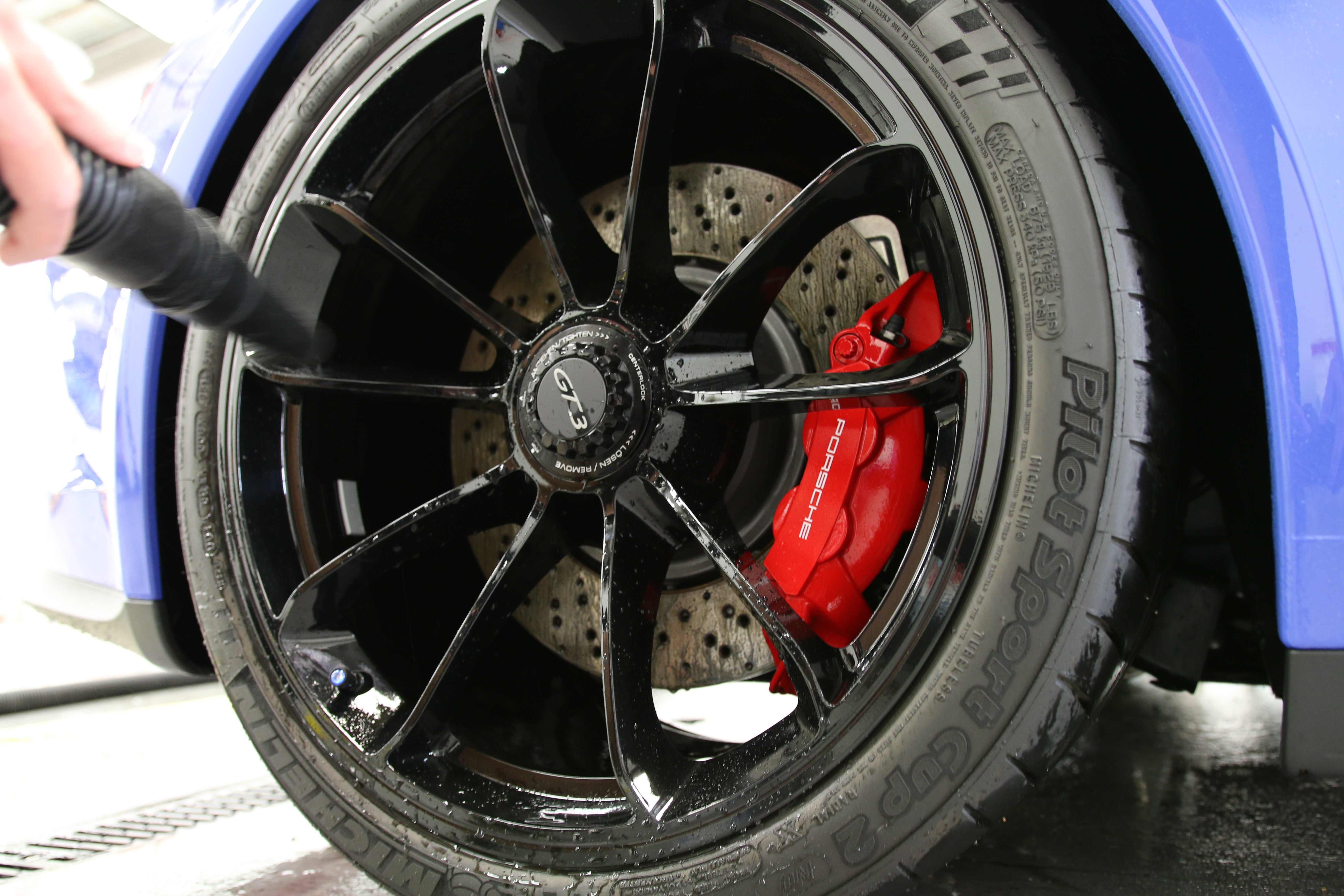

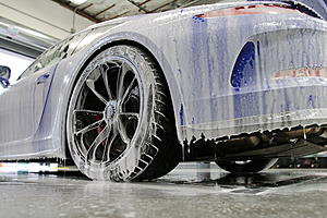

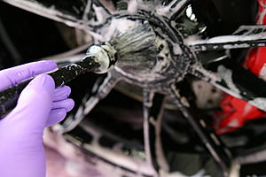

Wash and Prep for Paint Correction
WOW! Modesta BC-04 on a Maritime Blue - Paint to Sample - Porsche 911 GT3-img_3919_zps6tmdr0gb.jpg
WOW! Modesta BC-04 on a Maritime Blue - Paint to Sample - Porsche 911 GT3-img_3928_zps7pqq90v0.jpg
WOW! Modesta BC-04 on a Maritime Blue - Paint to Sample - Porsche 911 GT3-img_3952_zps3vn2e8fh.jpg
WOW! Modesta BC-04 on a Maritime Blue - Paint to Sample - Porsche 911 GT3-img_3963_zpsksnpxyof.jpg
WOW! Modesta BC-04 on a Maritime Blue - Paint to Sample - Porsche 911 GT3-img_3975_zpsdu7xcisd.jpg

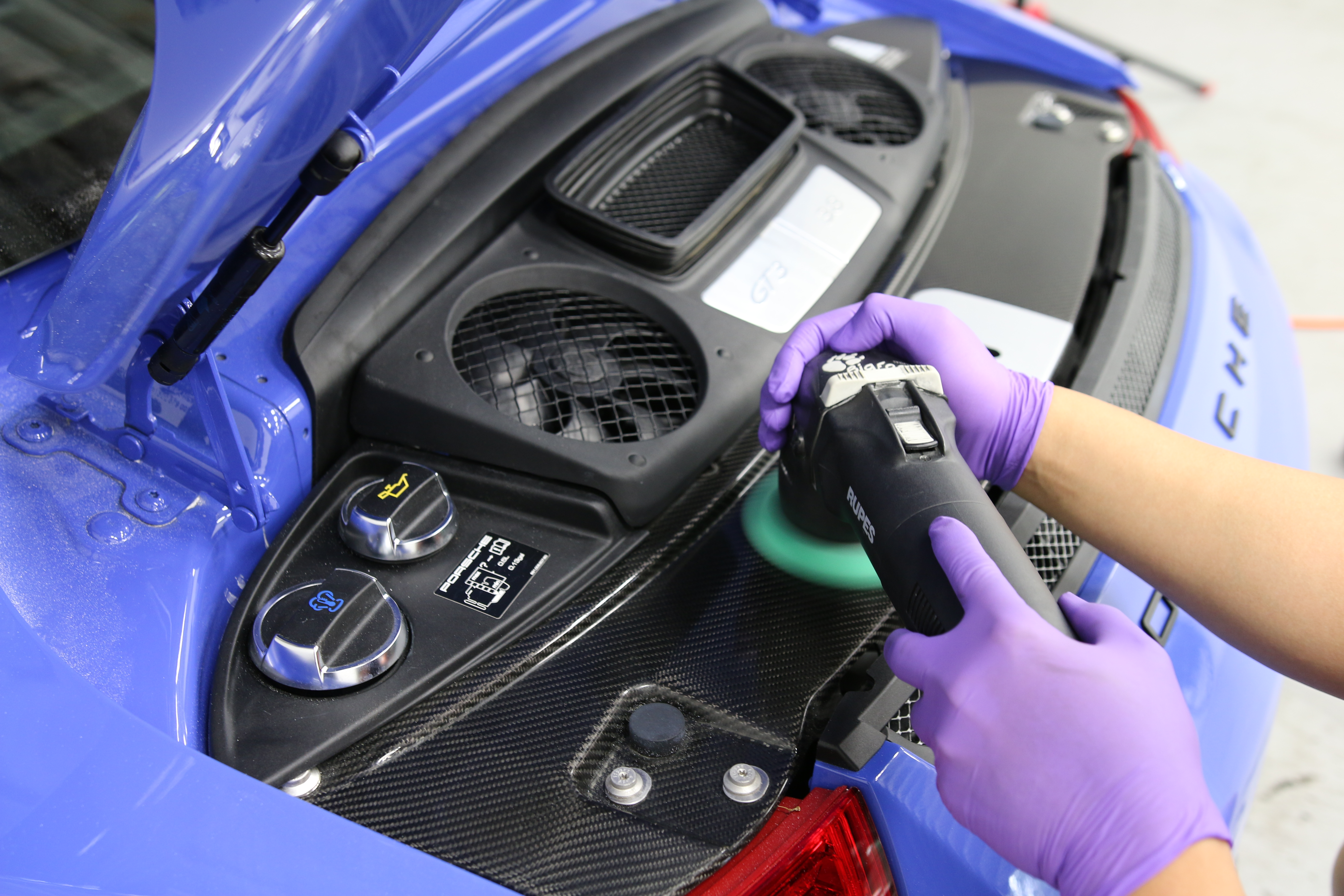

After polishing
WOW! Modesta BC-04 on a Maritime Blue - Paint to Sample - Porsche 911 GT3-img_4296_zpsz8dsn9pn.jpg

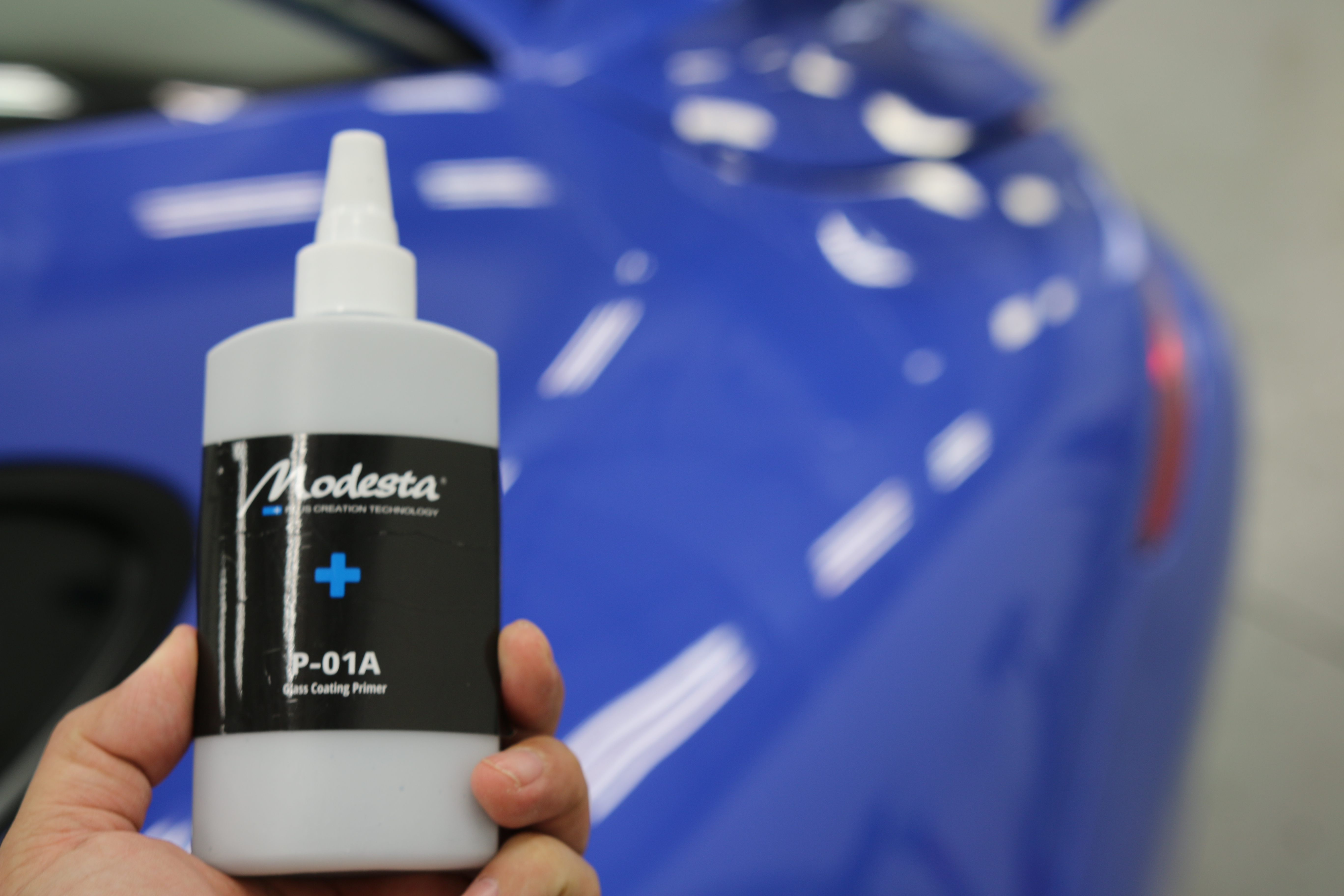

Modesta Primer
WOW! Modesta BC-04 on a Maritime Blue - Paint to Sample - Porsche 911 GT3-img_4378_zpssreglkr0.jpg

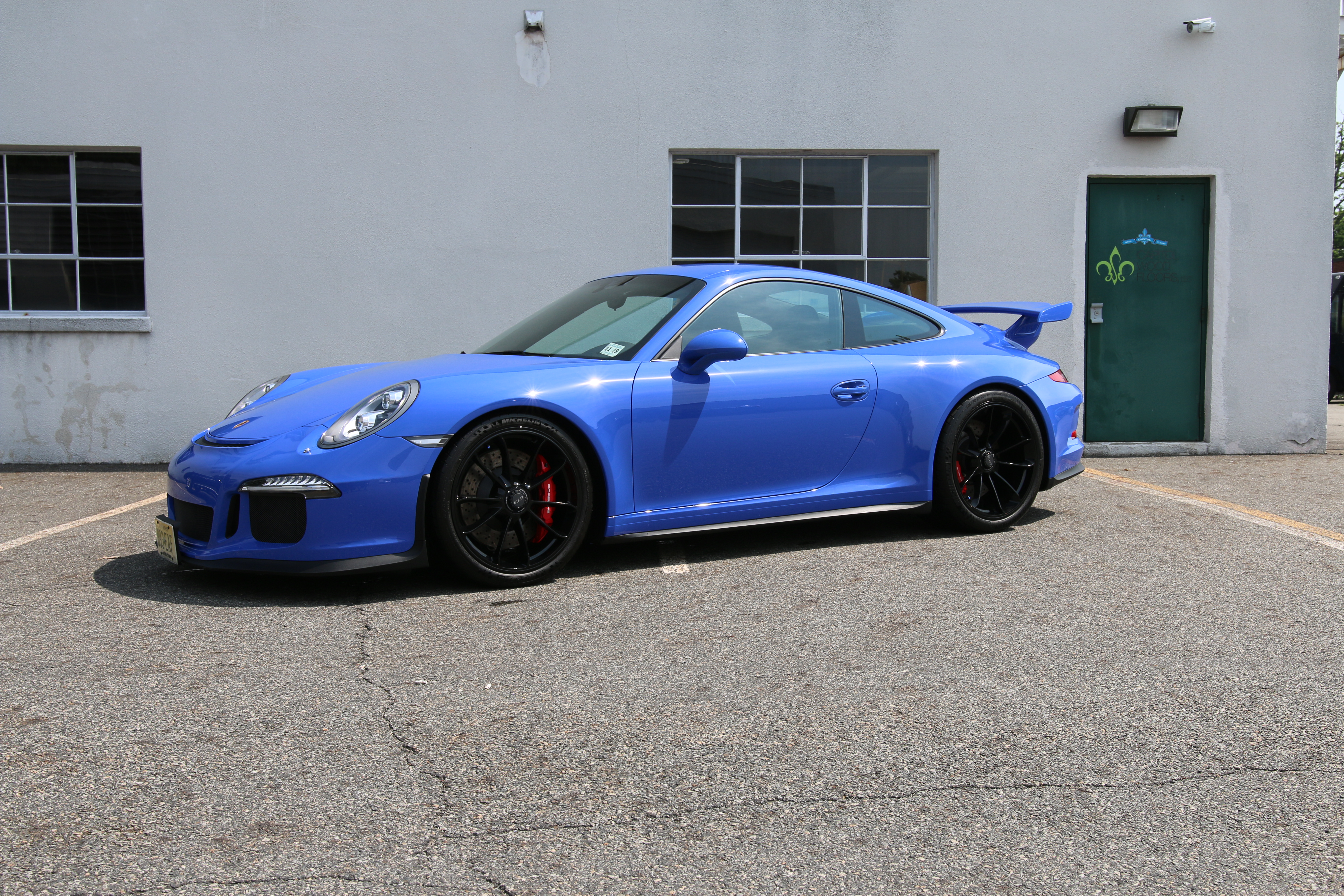

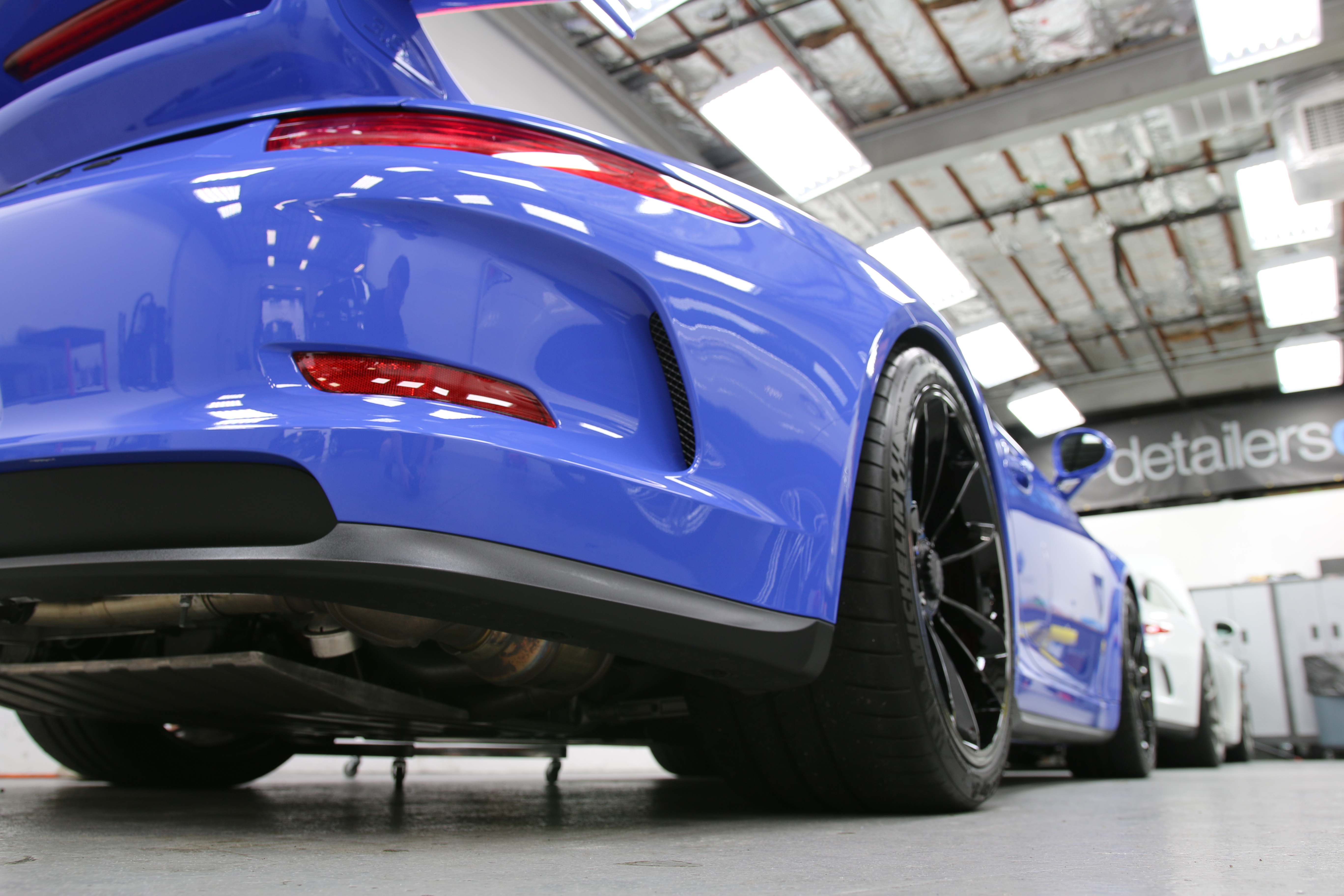

Afters
WOW! Modesta BC-04 on a Maritime Blue - Paint to Sample - Porsche 911 GT3-img_4412_zps3tey0fn3.jpg
WOW! Modesta BC-04 on a Maritime Blue - Paint to Sample - Porsche 911 GT3-img_4426_zpswucck6oo.jpg
WOW! Modesta BC-04 on a Maritime Blue - Paint to Sample - Porsche 911 GT3-img_4447_zps1duj87fa.jpg
WOW! Modesta BC-04 on a Maritime Blue - Paint to Sample - Porsche 911 GT3-img_5214_zpsicwkjy7h.jpg
For more pictures and a more in depth article please click here - Modesta BC-04 Glass Coating on a very special Porsche 911 GT3
