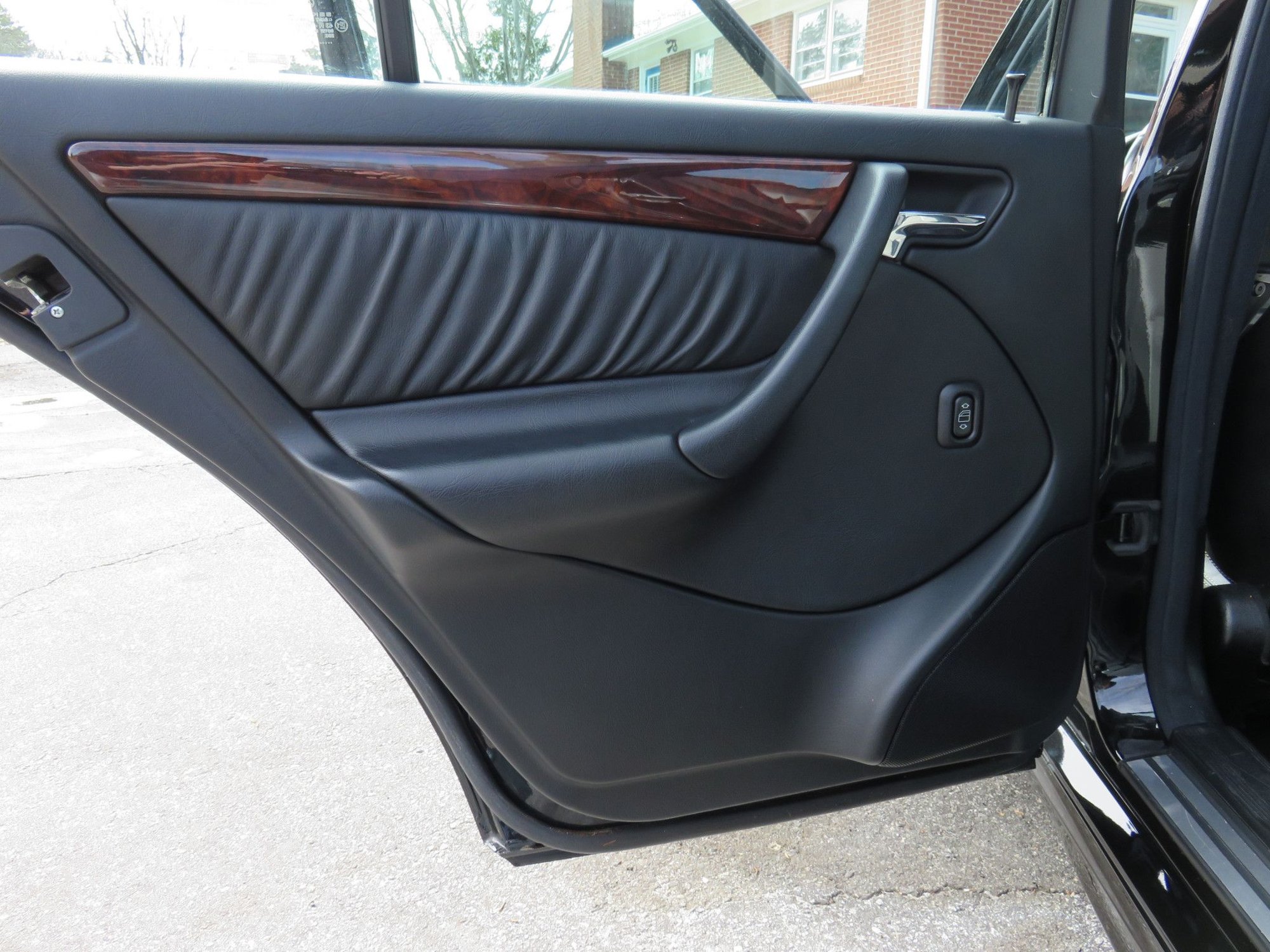

How to clean interior dash and panels back to factory look
Factory look is usually satin dull finish without any grease on it. Whats the best way of achieving this?
Heres a picture of how I want it to look and bottom picture is how it looks.

Use a de-greaser, a light one.
Zep or simple green diluted etc

Or use a microfiber cloth/towel dampened in a very dilute solution of water and dishwashing liquid soap. Wipe with the dilute soap/water solution, then follow with a clean microfiber cloth dampened with plain water. Repeat as often as necessary.
