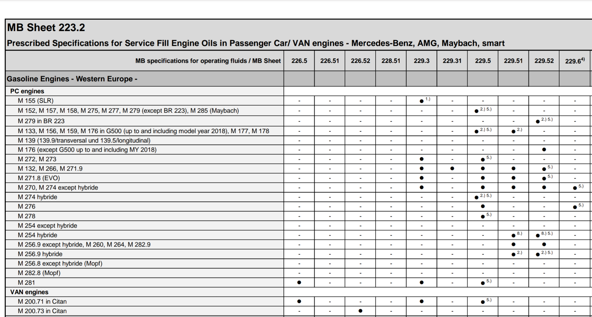

Originally Posted by Diabolis
MB 229.51 is (or was) a specifically formulated oil for DIESEL engines, not gasoline, and you are again completely wrong about what causes the gelling. Just because you believe the earth is flat it does make it so.
Somebody forgot to tell Mercedes Benz. Look at all those gasoline engines they listed under 229 51. You better call them up and tell them about their mistake before its too late!
