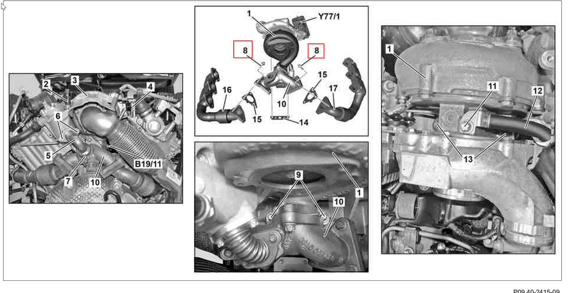

I attached a few pdf's to this reply.
The bolts that need to be renewed are the ones on the exhaust side in the red boxes. Although, often the old ones can be re-used I have to admit, when they brake or wear out, then the job is raised to the next level of "fun"
I am not sure if this is relevant for your model, but pay attention to the little cooling pipe (12) in the picture above. There is a little o-ring rubber seal where the pipe sticks into the engine - I would recommend renewing this o ring. If it starts leaking there, because of bad o ring, then there is no way to change this o ring without lifting the whole turbo again.
BTW: all pdf's are for my ML350 WDC166.024
Viel Erfolg
