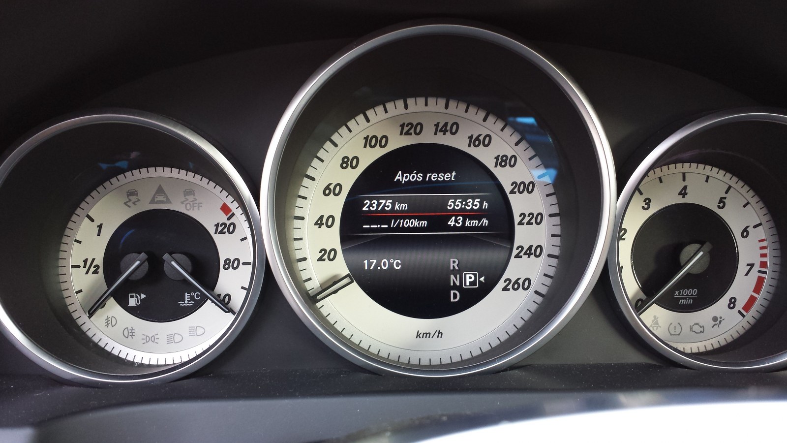

Hi guys,
Since I bought my 2013 E500 and after I made a reset to the mpg it had registed on the cluster, the mpg never was showned again!
I have done 2300km since then and still no total mpg!
Do I have to do more miles or what!?

That's very weird. I don't think you have to drive more. I believe it calculates as soon as you reset it. So if you reset again, it just does the same thing? I'd bring it in if that is the case.

I've just did another reset and let's see if it do anything to the mpg calculations!

The reset did the trick!
Thanks for the feedback.

I found out after an new software update on the ECU that the MPG was not showing again, and that was what happened the other time!
Had to do a new reset again yesterday!
