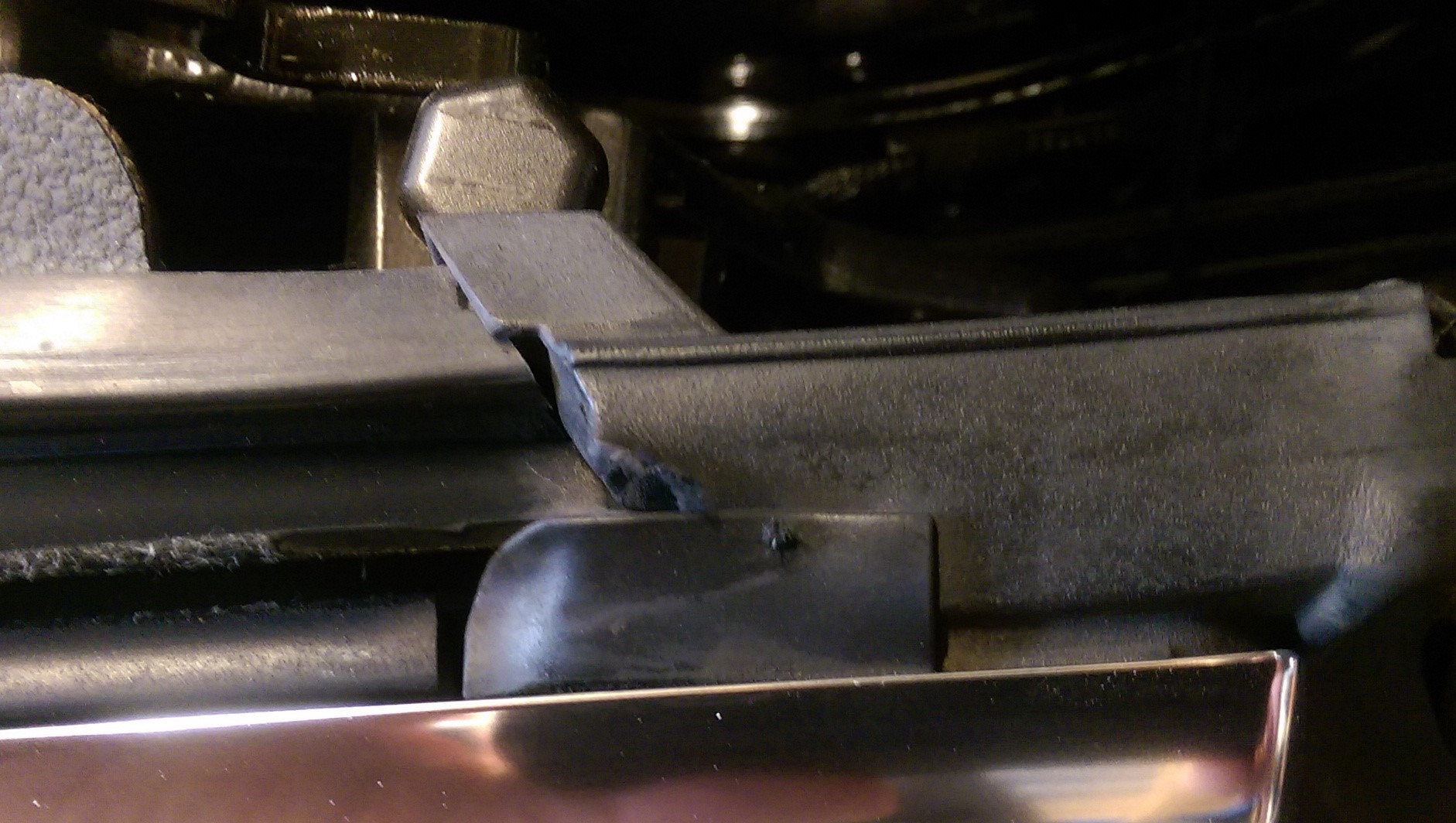

Hi guys here are a couple of pics
one is the drivers side with it missing the other is the passenger side which is still in place!!!! You can see it is glued to the chrome strip only!!!
Just for info this stops excessive water getting into the car, the water does not literally go into the car but the compartment inner within the car shell, the excess water actually vacates the car via drain holes in the base of the long sill !!!!!
Also from experience if these drain holes become blocked, you will hear water sloshing around as you drive, had this problem and it was my dealer that cleared the problem.......

I did try a temp fix by supergluing a piece of rubber as a replacement, but the window actually rides against this as it goes up and down and the roof, when closed, actually sits on this piece. So after a few attempts have given up and have ordered the whole trim piece, as it is a long piece will have to take my time, I believe it only a press fit and no clips..........

Part arrived today and whilst the original fault is just a small piece of rubber, the strip comes with the window rubber connected.......
Now the bad news fitted it myself, removed the old one easily, BUT when I tapped in the new piece did not realise how soft the chrome strip is so have dented it in 3 places AAAAAAAAAAArgh..... it is staying on on for now just not let my eyes drag over it!!!!!!!!
