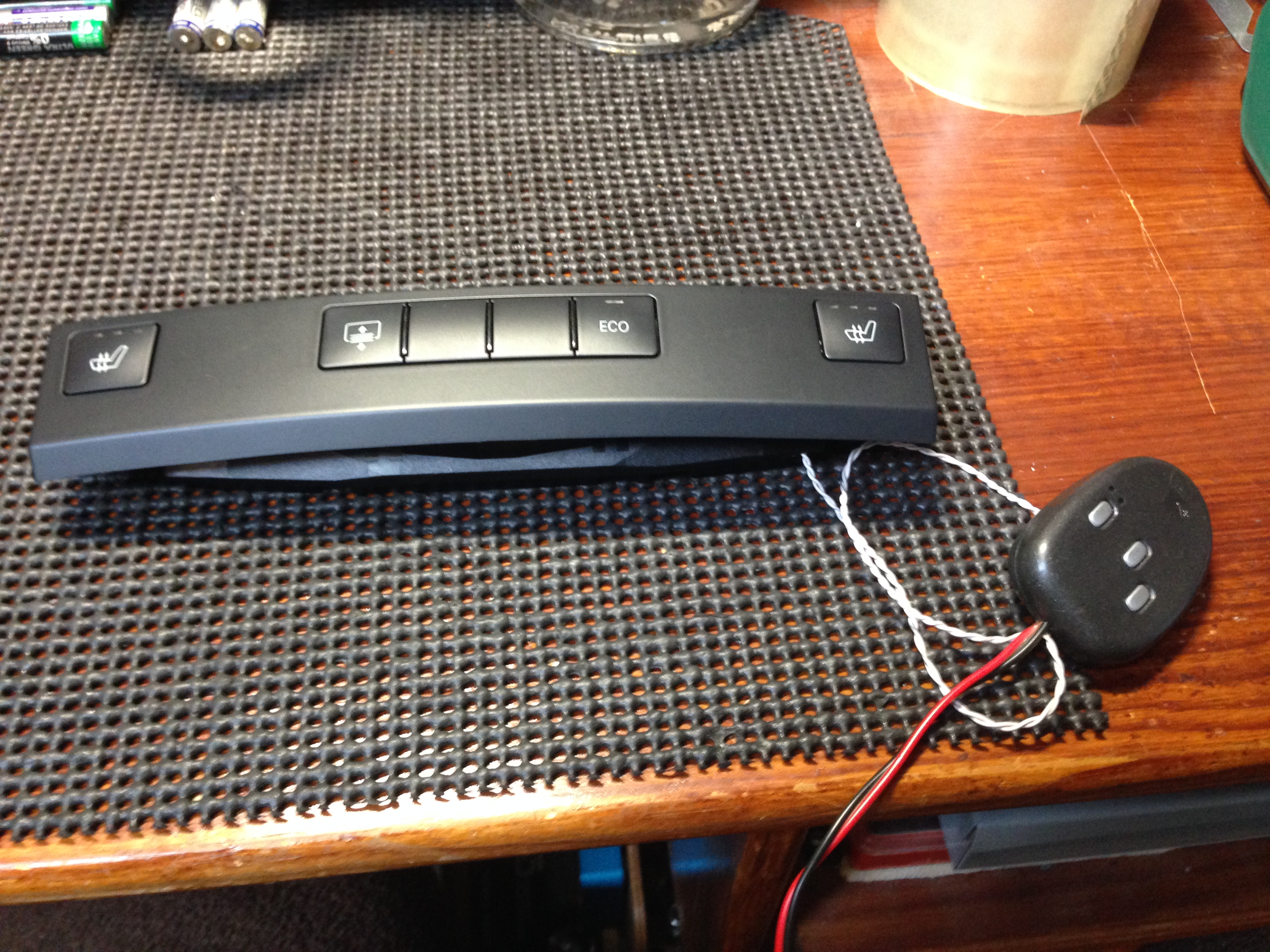

So, like I do in all my Cars, Here is the DIY of Home Link, of my "Black".

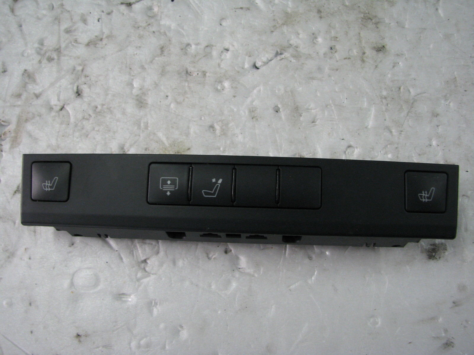

I bought the Module with the Key I need on Ebay.

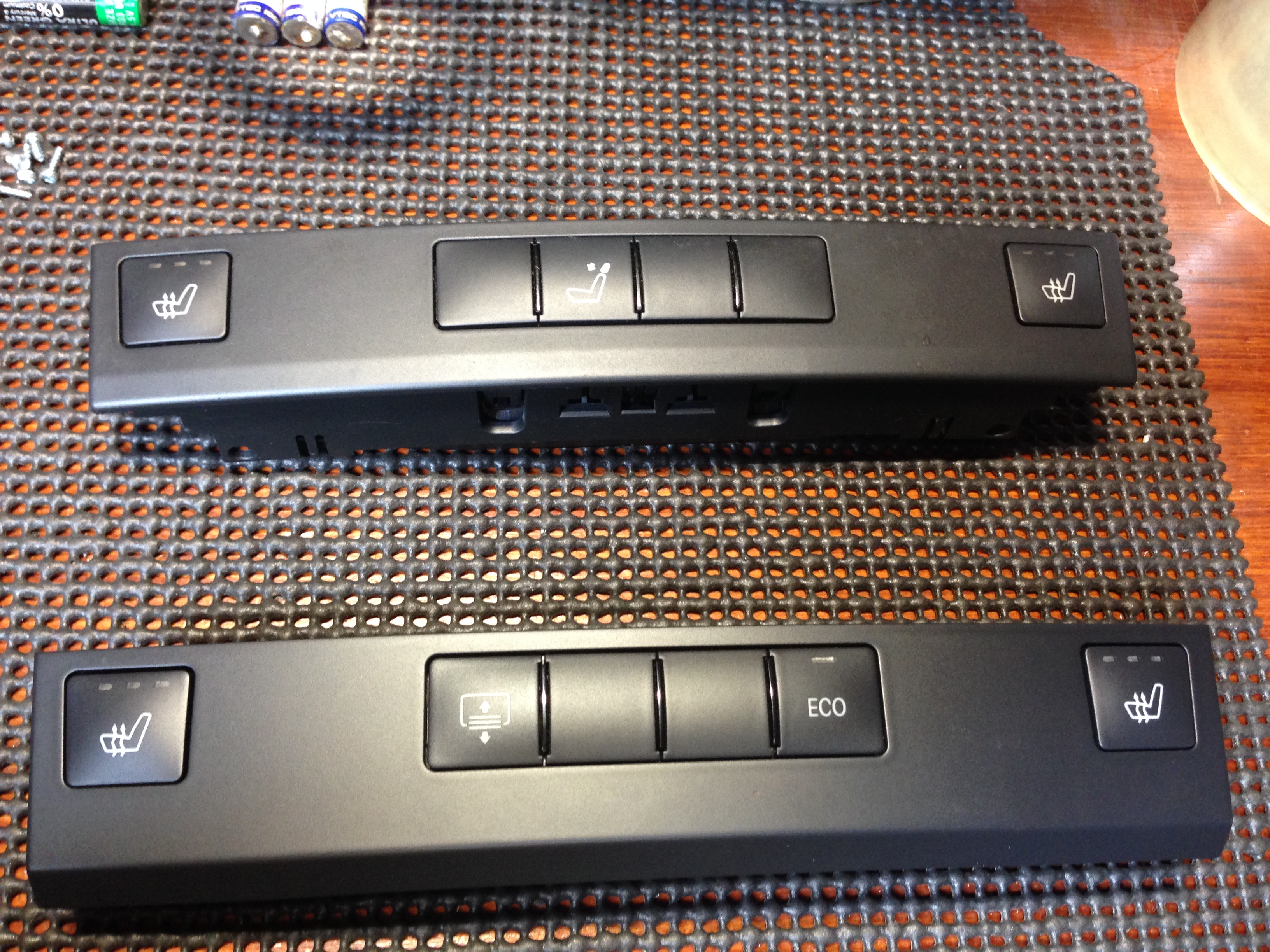

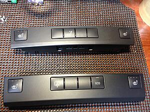

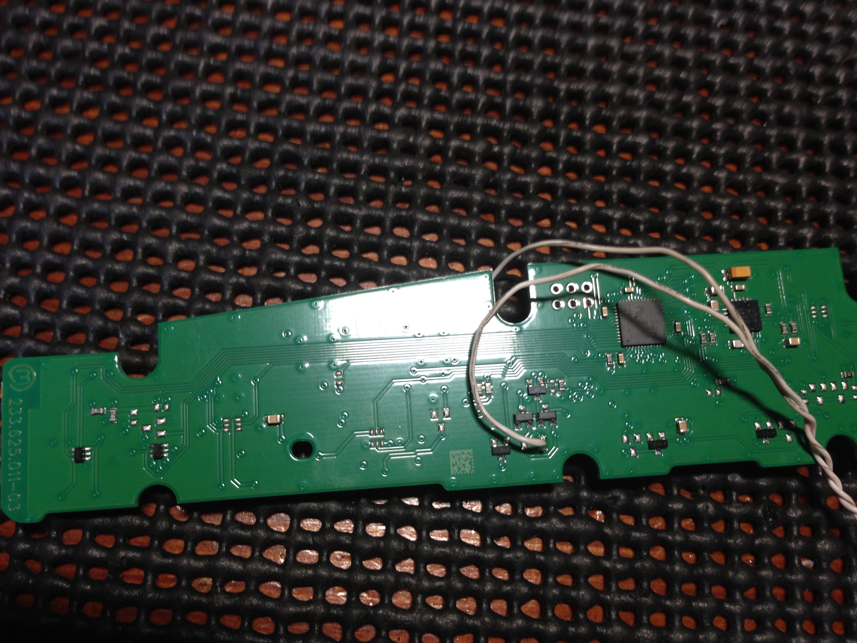

I install the key on my original module, because the circuit boards are different.

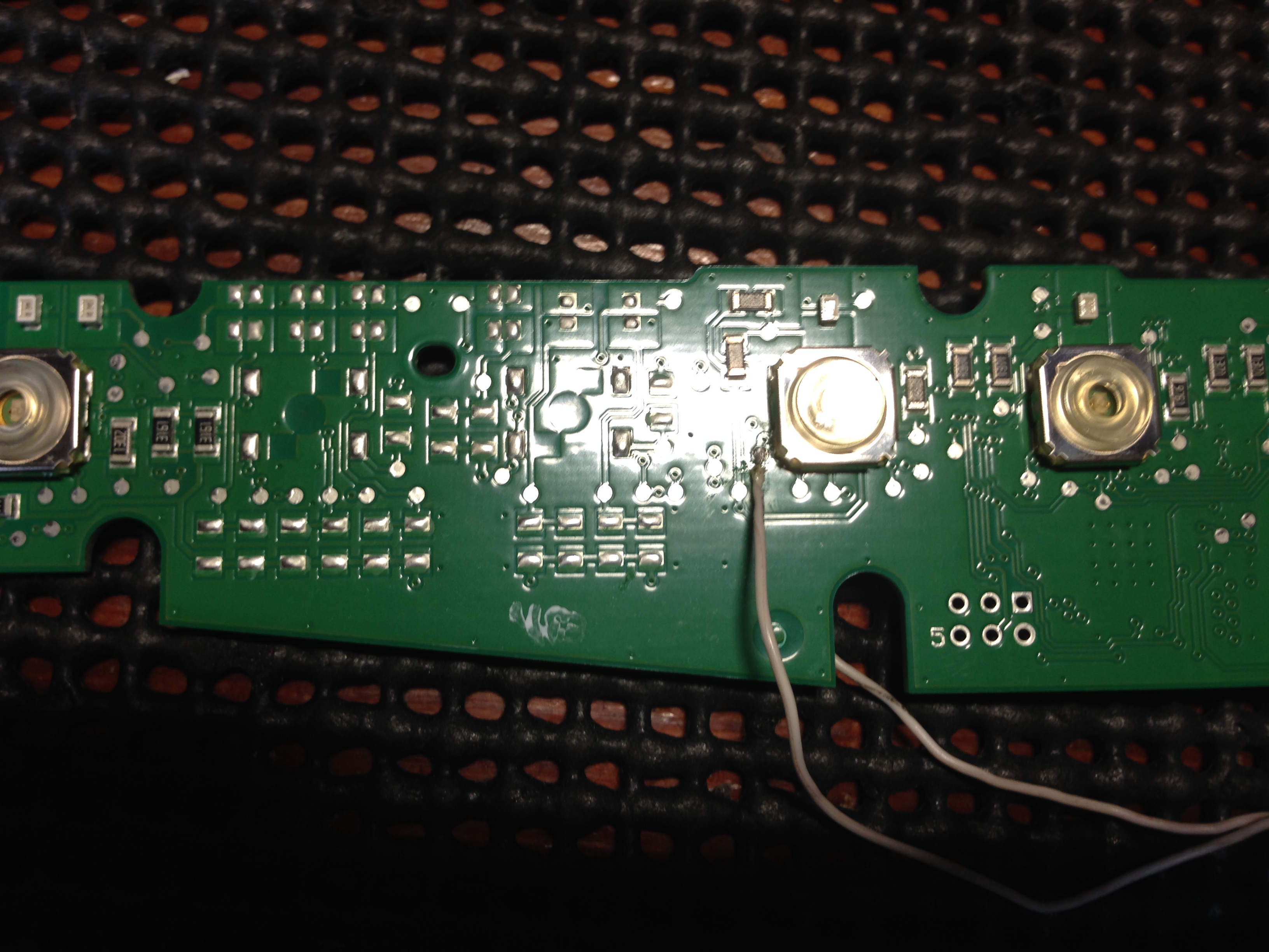

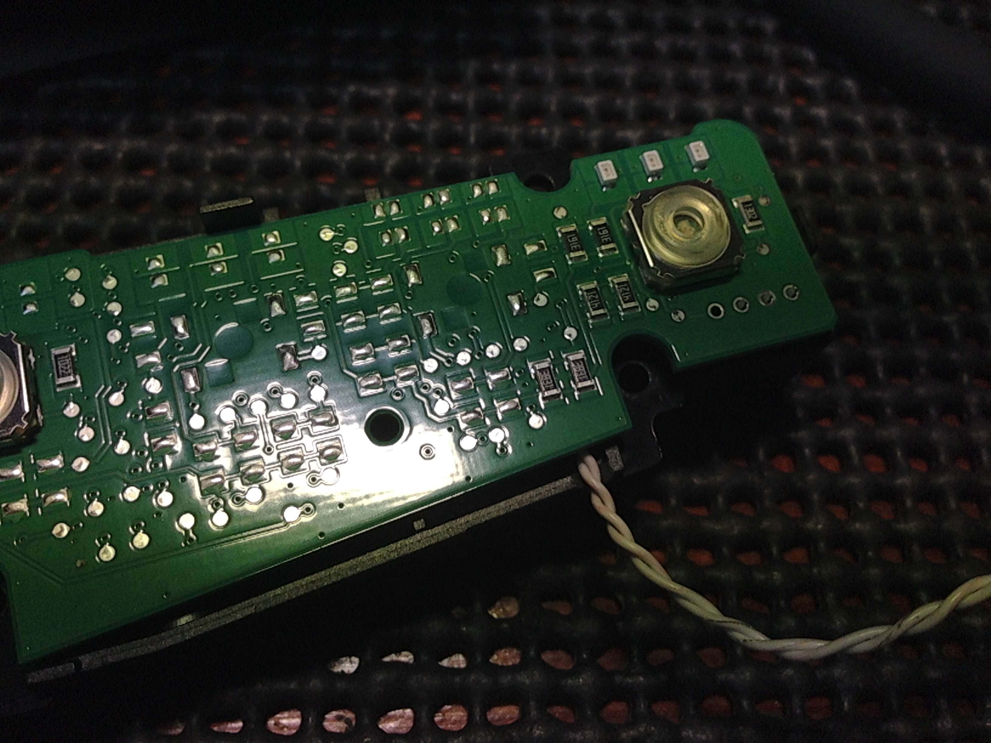

I weld two wires on the remote button that performs the opening of the gate and at the other end I weld them to the board corresponding button.

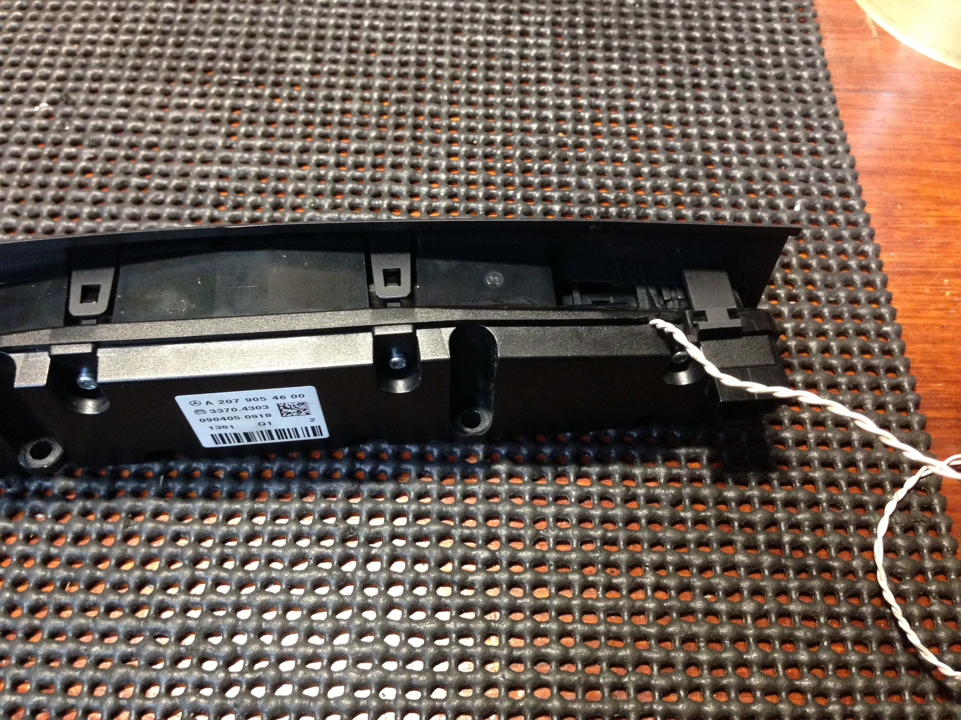

A small cut to don't pinch the wires:
The part ready to install:

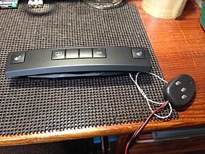

I weld two wires on the contacts of the battery in the remote and at the other end I dug them to a positive and a Vehicle Mass.
Thus avoiding the use of a battery. (This operation can only be performed if the remote uses a 12V battery).

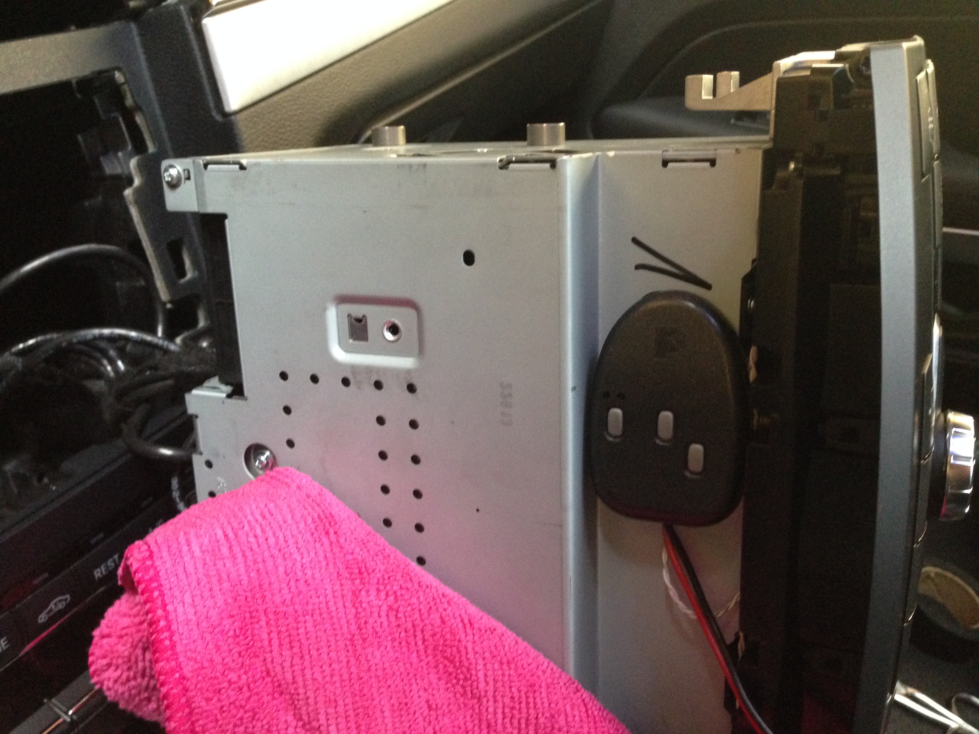

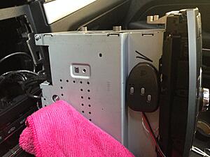

I applied the remote with double-sided tape behind the block:

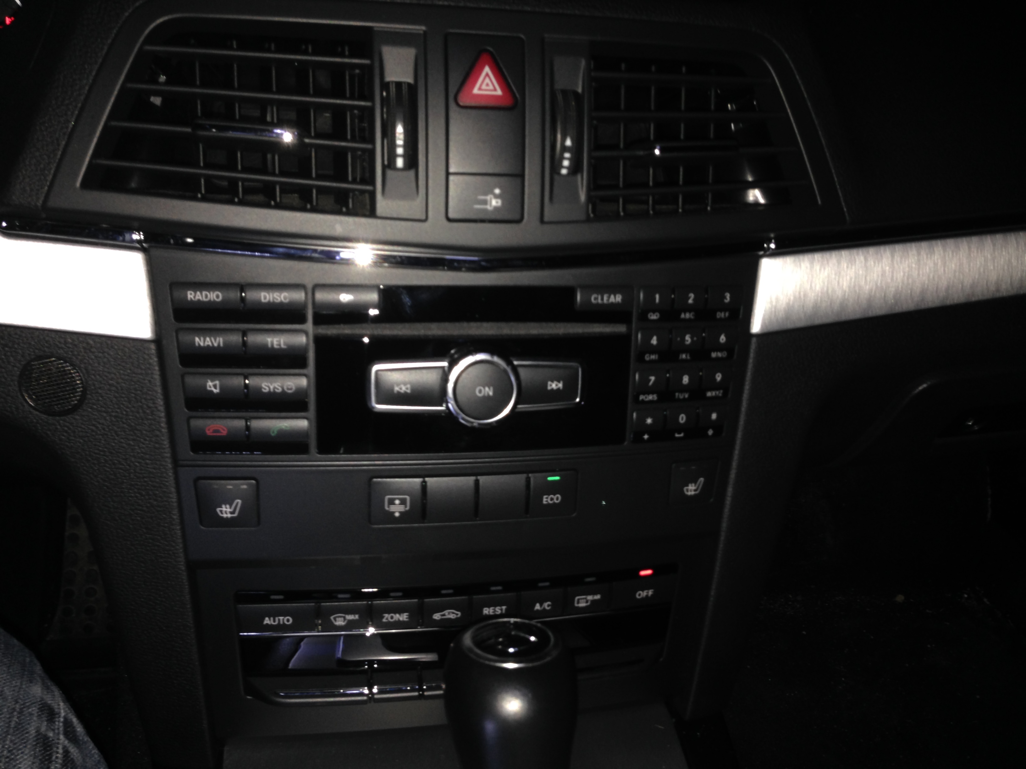

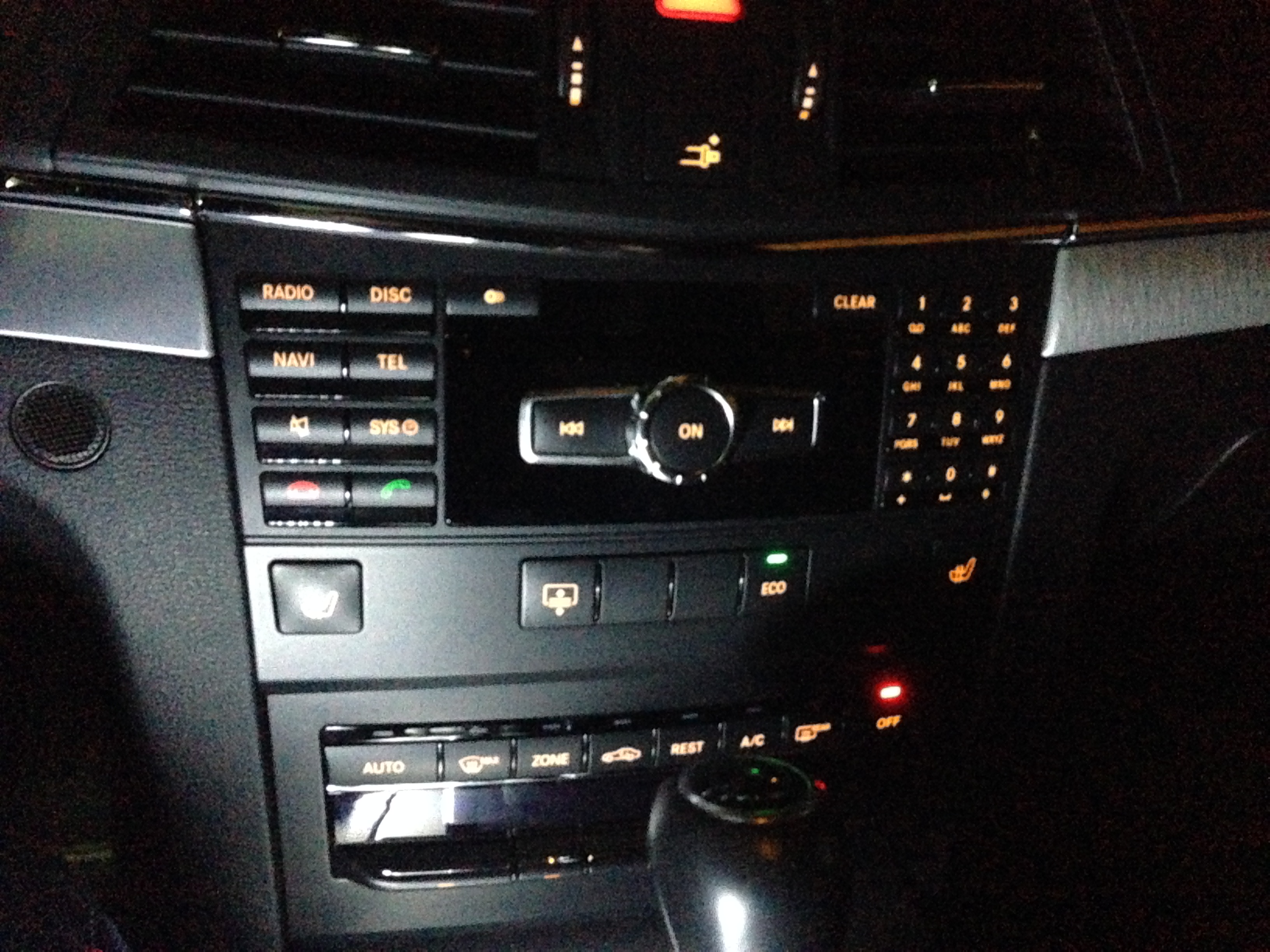

The FINAL Assembly:
