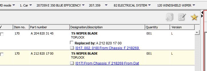

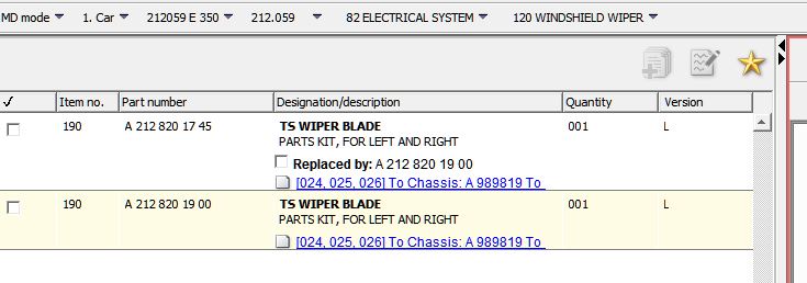

Can anyone confirm or give insights into the following regarding wiper blades:
1) Are they the same as the E sedan? (hope so, cuz' a lot of places don't list the coupe separately in their application guides)
2) Got a part number or reference that can work at say Auto Zone or Advance?
Thanks!

207 (coupe) MB part # 2128201700
212 9sedan) 2128201900
Attached Thumbnails Wiper Blades for a 2014-capture.jpg   Wiper Blades for a 2014-capture2.jpg
