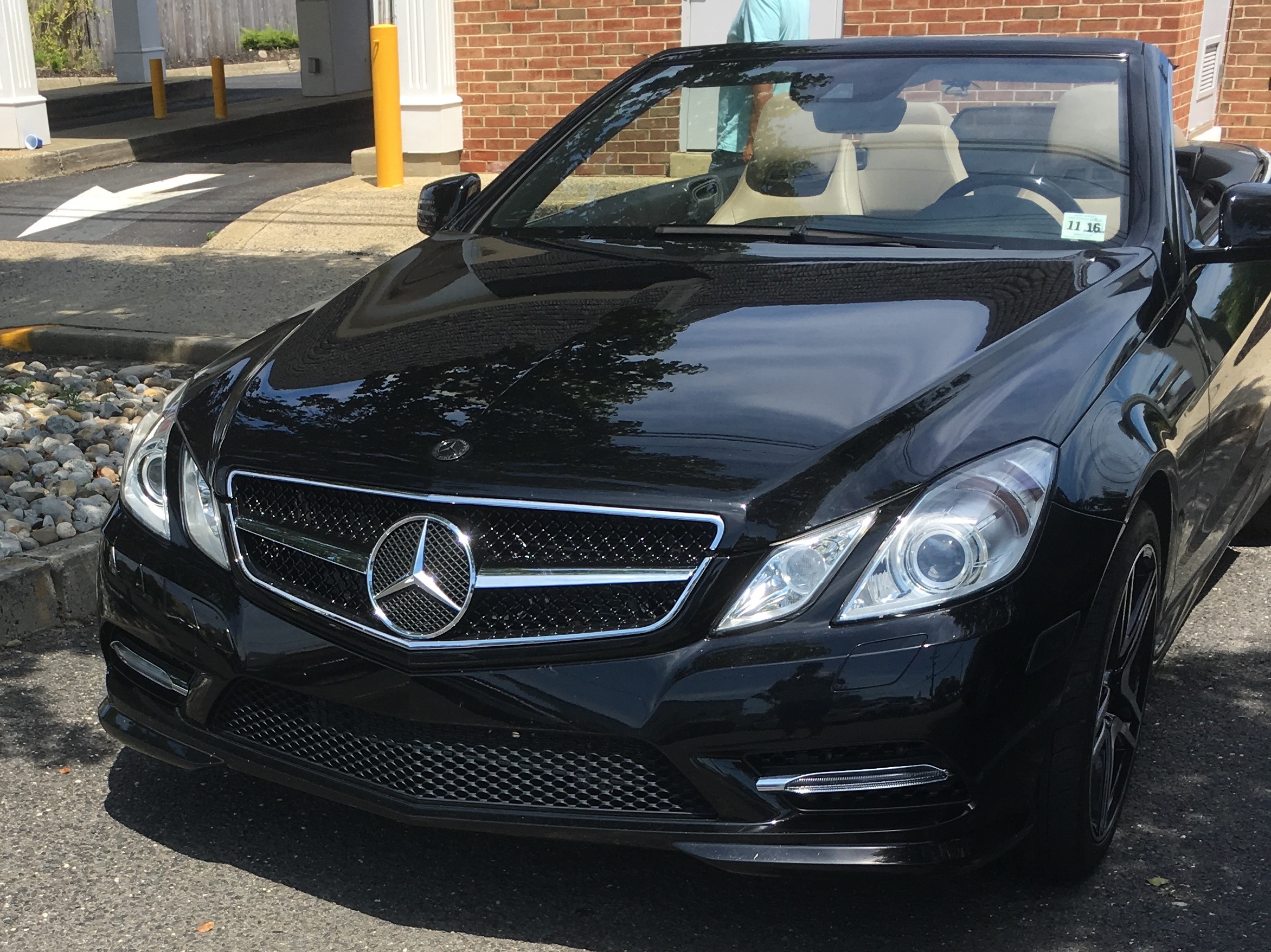

Post a pic of the front of your car so we can see what bumper you have.

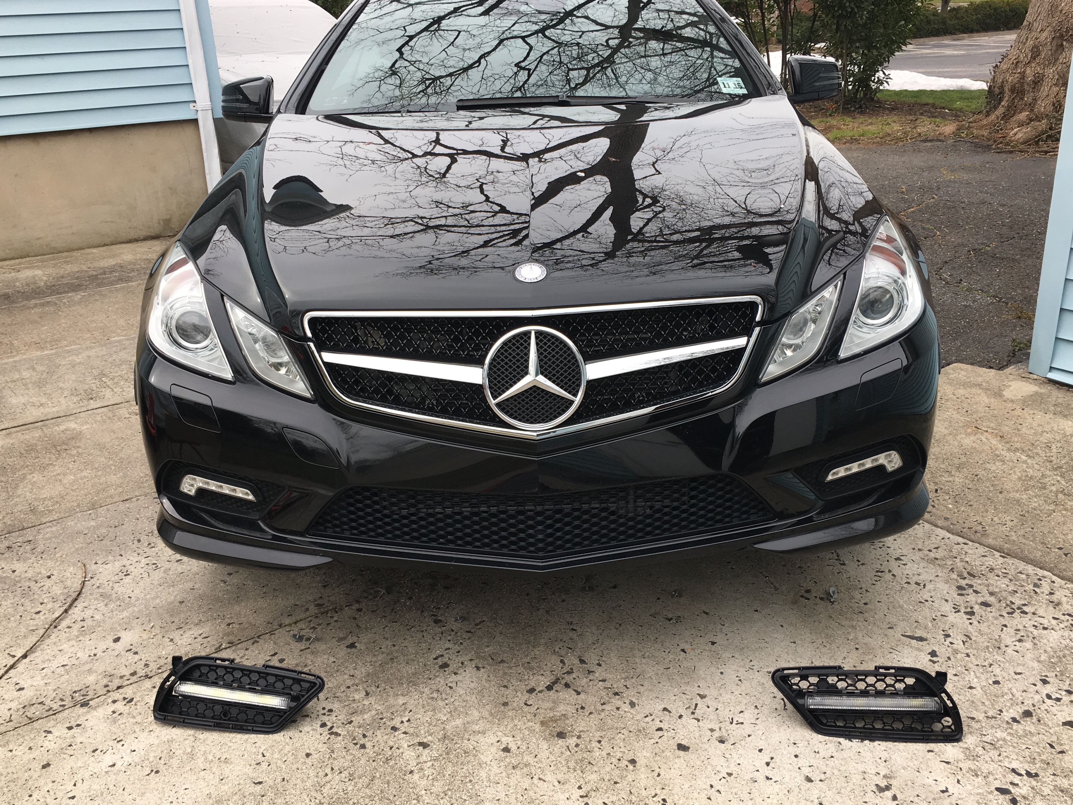

have attached some pics. hope this helps. can put more up if needed.

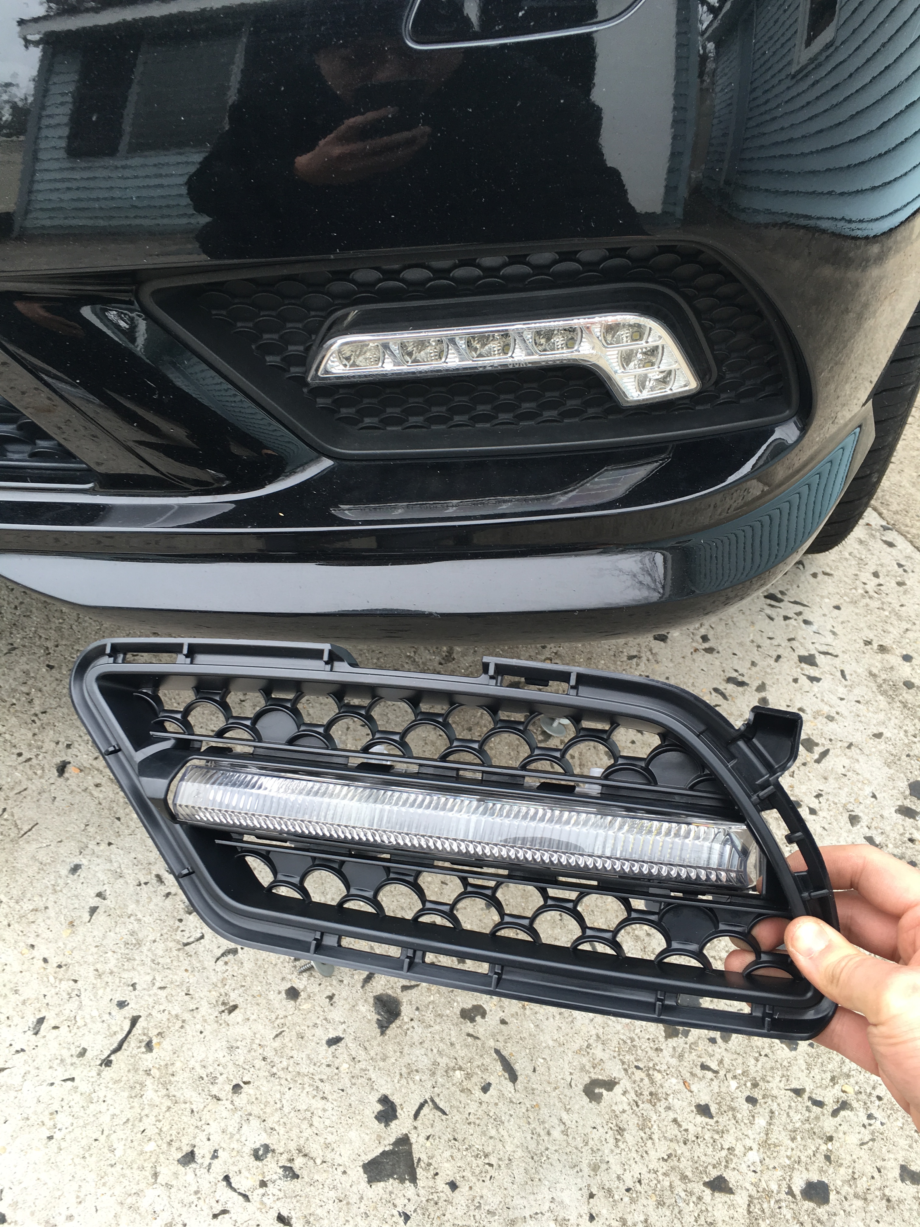

I did it on my car but for the AMG bumper and I can tell you that the part numbers you have won't fit your bumper. They are labeled wrong as well. The top set you have listed are the chrome covers and the bottom set are the black mesh grills which are all for the AMG bumper.
Your car has the non-AMG bumper where the outer grill is shorter and wider.
You're going to need 6 parts total (3 for each side). The black mesh grill, the DRL LED light, and the chrome trim.
The DRLs I bought off eBay for $203 shipped were A204 906 89 00 (Left) and A204 906 90 00 (Right) and they fit perfectly. They seem to be the same between models but I can't guarantee it for your car.
Sorry I don't have the part numbers you need but at least you know the ones you have now won't fit your car. Hopefully someone else can get you the right ones for the non-AMG bumper.
