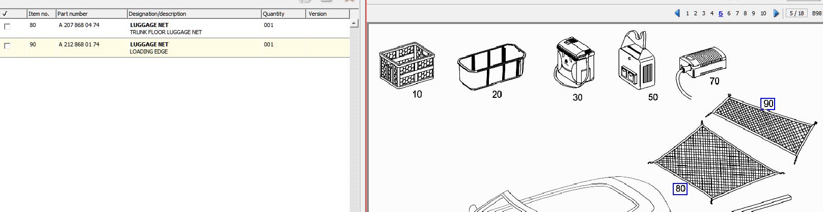

Hi Guys,
I just bought an ex-Demo E400 Cabrio here in Australia. Loving the car so far!
I noticed in the accessories catalogue there is mention of 2 types of cargo nets for the boot. I had hoped to re-use the net out of my old Audi S4, however my cabrio only has 2 mount rings close to the boot opening.. nothing on the back ( seat end) of the boot.
How does the A207 868 0474 net mount at the rear?
does anyone have a pic of the "cargo net - load sill" version (i presume this is a vertical one at the front of the boot? A212 868 0174
Thanks guys!

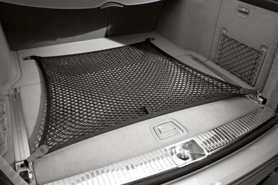

Floor net, lashing eyelets part # 20486021149051 (black) mount to rear most floor panel see attached photo. Sill net 2128680174 can be viewed here (used across several models): http://www.ebay.com/itm/Genuine-OEM-...qiRdGg&vxp=mtr
