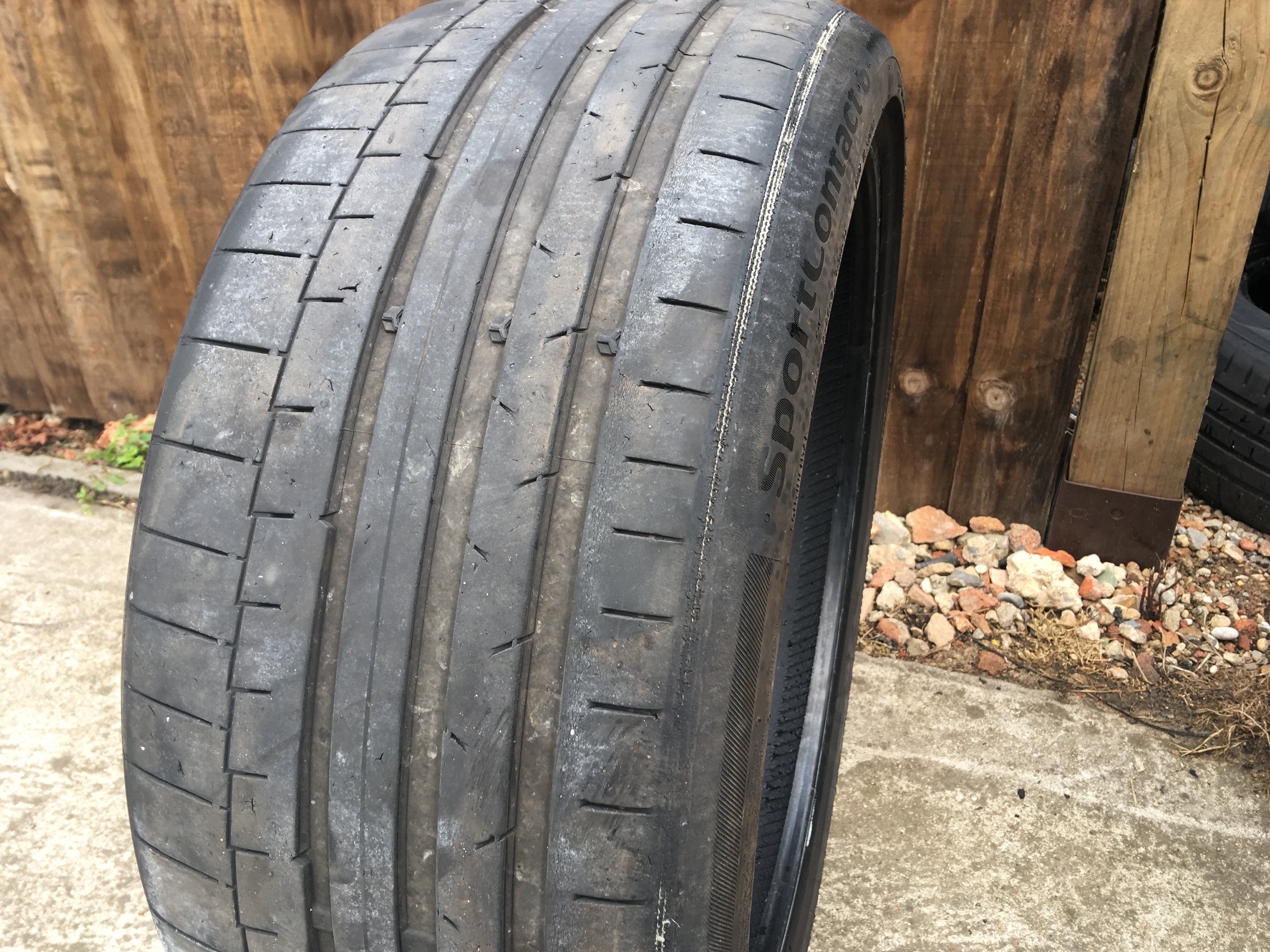

Please can anyone help?
I purchased my w207 e350 in March this year. It's the 3ltr V6 diesel AMG 2014
Within a week of buying had the wheels balanced and tracking/alignment adjusted. After 7k miles the front tyres have worn as shown in the pictures. This is Horrific and caused a puncture. When I returned to get tyre fitters they said that the alignment was only out a touch! I visited my Merc dealership as car is not 3 years old until sept, they were not that helpful but agreed to inspect the car next week for any suspension faults.
Tyres are 235/45/ZR19
Very worried as I bought this car to use for business covering 28k miles per year, all straight line driving.

Are both front tires worn like this? I once had an issue with one front tire. I found out when I took the car to the dealer for other service. The dealer pointed out to me and told me the tie rod needs to be replaced for $1K! I took it to a tire dealer and was told the tire was defective.
Yours could be defective tires. No bad alignment will cause this kind of unusual wear. Take the car to a tire dealer (not the one you bought from) and see what they say. If the tires are defective, you can file for tire warranty.

I have been working with tires for many years and I agree with Flash_Gordon that poor wheel alignment cannot create this type of wear alone. The wear goes too far down into the sidewall. If only this one tire on your car shows such wear then it is probably a rare manufacturing anomaly in the tire. Possibly the tread rubber was not centered well when the tire was built. Looks like a warranty claim for the tire manufacturer.
