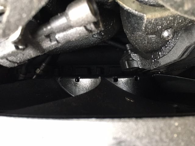

My theory is that I have a split pipe. I have crud behind the fan and looked fairly fresh. I will try and upload some images of that.
