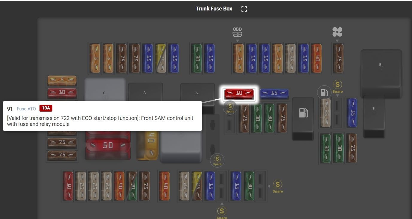

How is fuse #91 labeled on the vehicle's fuse chart?
Labeled, ECO start/stop function. Front SAM control unit.

Here's the fuse in question. Looks like a singular operation to me.

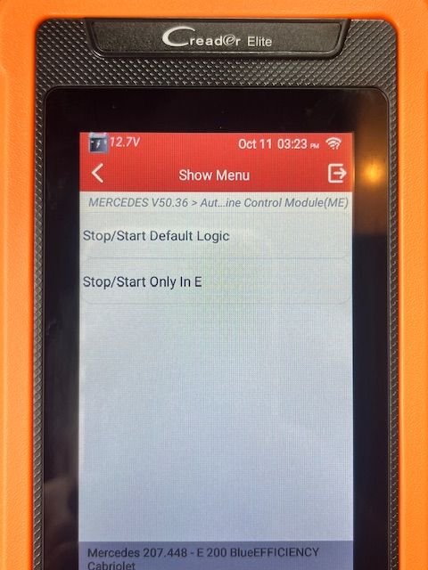

Recently I purchased the Launch Creader elite for MB and discovered that I have stored the following code: U1138 communication fault with the auxiliary oil pump in 7G-tronic transmission. Apparently, the aux pump is there for the start/stop system so that the gear can engage immediately.
In a later step I will reinstate fuse 91 and do the variant coding to switch start/stop to remember last setting. When done (this might take a while) I will report back.

Fuse 91 triggers U1138 code
Confirmed that #91 fuse removal triggers U1138 DTC. However, it is completely unnoticeable when driving ten thousands of kilometers.
Sadly, I was unable to code start/stop off or last remembered setting. Only possible to choose default or in E only.
So I pulled the fuse out again 😂
Take care,
Siepel

The latest software version in my Launch scanner is V50.45 for MB. You might try upgrading from V50.36 and see if anything changes.
