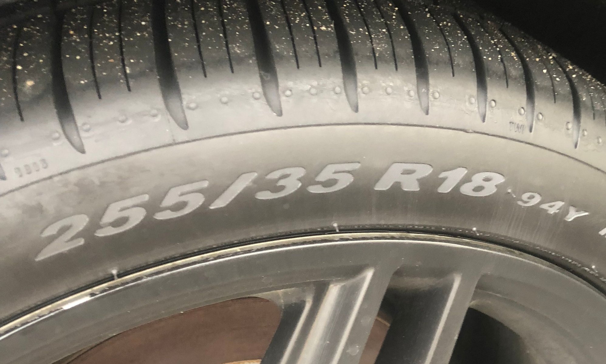

I wanted to change the wheels on my '13 e350 4matic coupe. There are a few reasons I want to change the wheels 1) I want a wheel that already has a black finish so I don't have to worry about plasti-dip peeling off (my current situation) and 2) I just want an overall change of the look.
I was looking for a staggered style which I read for a 4matic is possible but needs to be very precise. I went to take a look at my tires that are already on from the previous owner and I noticed the front and back tires are already different sizes.
As you can see the front tires are 235/40 R18 and the back tires are 255/35 R18. They are Pirelli P Zero all season tires btw.
So now my questions are:
1) What sz wheels would I need to buy for a staggered look?
2) What is a good offset to have?
3) Do I need to buy new tires as well to fit the new wheels or can I get away with using the Pirelli P zero tires I already have?
4) any wheel brand recommendations that fit the 5 x 112mm bolt pattern of the '13 e350 coupe?
