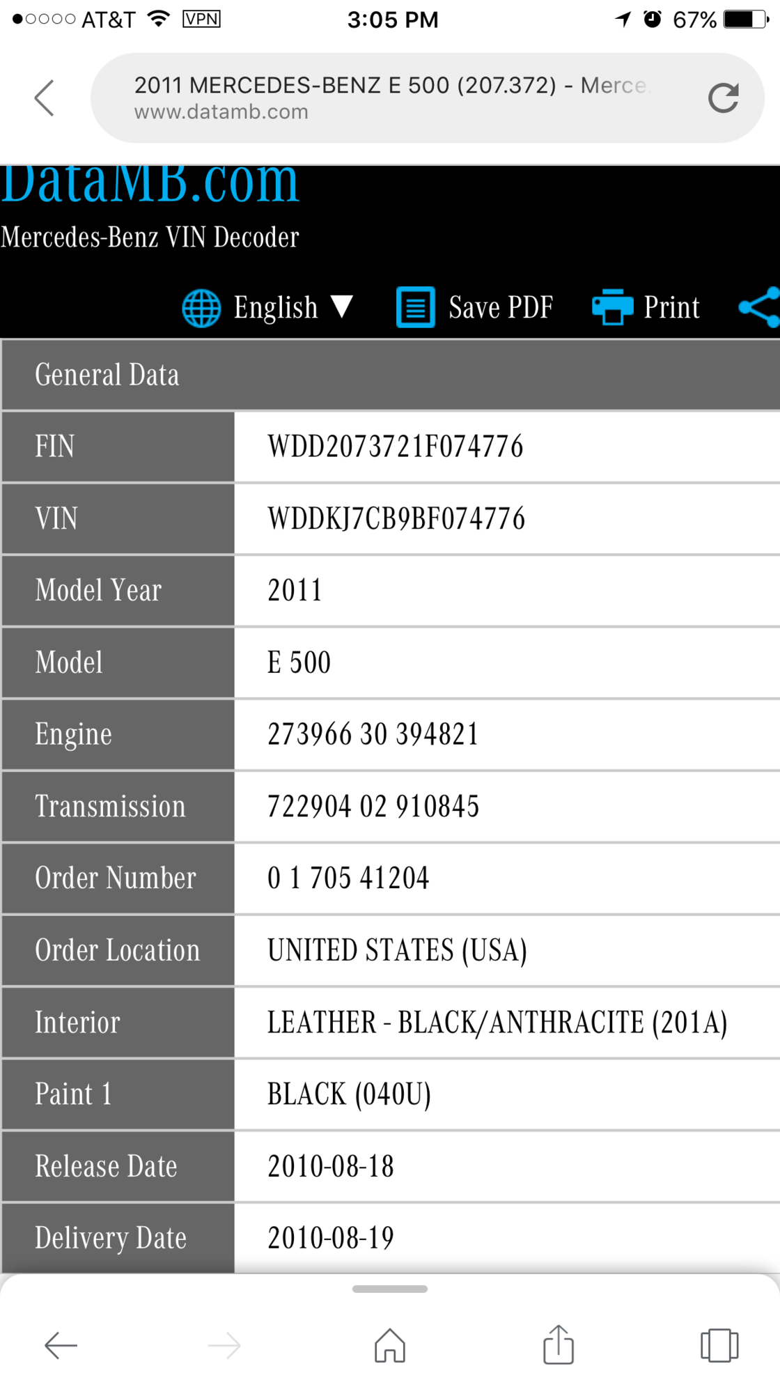

Definitive diagnose, if shop did not already process, is to quick test for fault codes using MB DAS (diagnostics). Front fender cover (120 in diagram) left shop 2076900130 or 2076901830; right 2076900230, 2076901730. Need VIN to provide control unit #.

Old Feb 23, 2019 | 06:06 PM
lee160's Avatar
Joined: Feb 2019
Posts: 7
2011 E550 Coupe
i will upload a picture of it. Thanks a lot!
Also do you have any idea which part to get for the front fender lining and rear lining too?
Old Feb 23, 2019 | 06:17 PM
lee160's Avatar
Joined: Feb 2019
Posts: 7
2011 E550 Coupe
Not sure why it said e500 on the first vin check. But it should be e550
Old Feb 23, 2019 | 06:25 PM
konigstiger's Avatar
Posts: 15,901
Likes: 4,630
From: North Scottsdale, AZ
'71 Pinto
Front fender (120) left used 2076900130, used/new 2076901830; right used 2076900230, used/new 2076901730. Rear (150) left used/new 2076901330, right 2076901230. Control unit left & right 2129007804.
