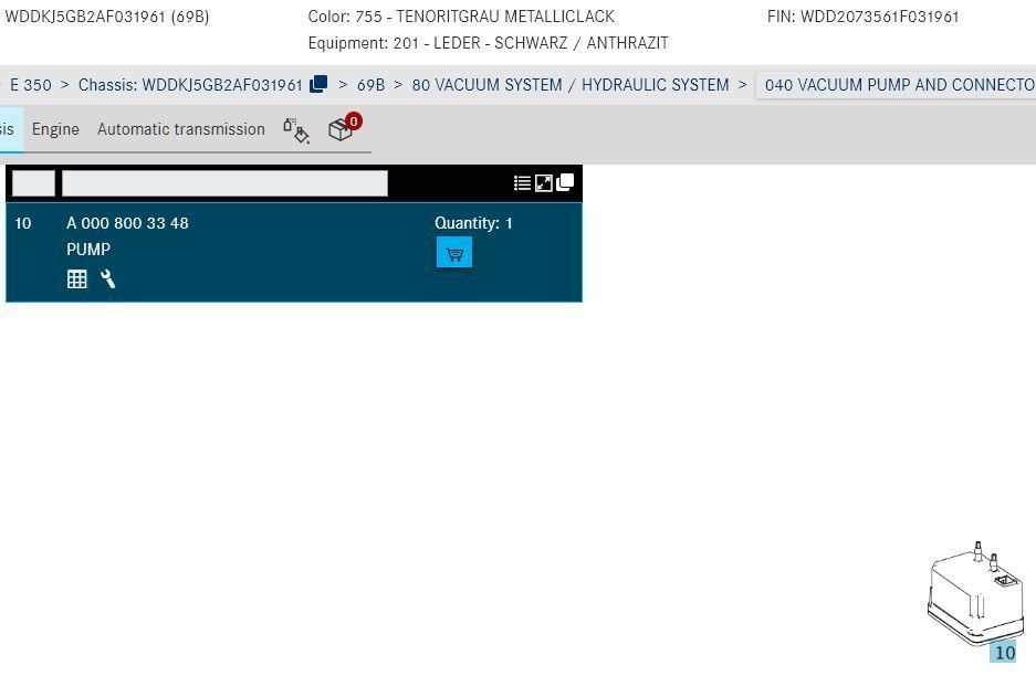

Old Jul 25, 2021 | 02:54 PM
Jjjenkins's Avatar
Joined: Jul 2021
2010 mercedes e350 coupe
Originally Posted by Plutoe
With your code 809 within the VIN the pumps are located on the left inside side of the backrests
Can someone help me please I'm looking for my pump also! 2010 mercedes benz E350 coupe vin#WDDKJ5GB2AF031961
Old Jul 25, 2021 | 04:38 PM
konigstiger's Avatar
Posts: 15,901
Likes: 4,633
From: North Scottsdale, AZ
'71 Pinto
File Type: pdf
File Type: pdf
Old Jul 25, 2021 | 11:19 PM
Jjjenkins's Avatar
Joined: Jul 2021
Thank you Thank you
It was right where you said it was so I took out the pump checked it with direct Power and it worked fine I also checked the 60 fuse and it was intact The multicontour function is still not working where should I check next? Or will the problem be in the motherboard of the pump? I will post a picture of my trunk fuse box because I don't know if a relay is missing or not.
Old Jul 26, 2021 | 10:00 AM
Posts: 15,901
Likes: 4,633
'71 Pinto
No relay. Leak may be causing pump not to operate, best to have someone pull fault codes using MB diagnostics reluctant to do so see attachments to disassemble seat, etc. to visually check.

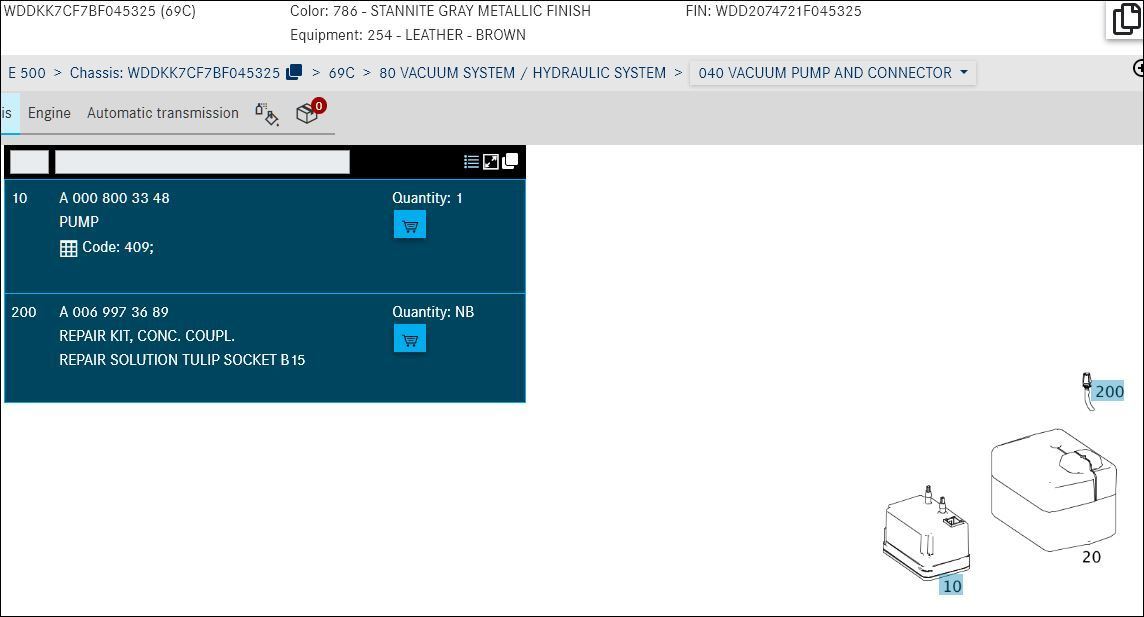

Old Nov 10, 2021 | 09:12 AM
BigMike62's Avatar
Joined: May 2016
Posts: 182
Likes: 34
From: Georgia
2011 E550 Cab
I'm getting ready to troubleshoot the multicontour seats not working. Since it is both seats, I'm going to start with the fuse and pump. I tried to look up the part number for the pump but had no luck. My VIN is WDDKK7CF7BF045325.
After the pump and fuse, I'll check the lines to see if they hold air. How many psi max should I apply to the lines?
Hopefully this is something simple.
Old Nov 10, 2021 | 09:55 AM
Posts: 15,901
Likes: 4,633
'71 Pinto
File Type: pdf
Old Nov 10, 2021 | 11:06 AM
BigMike62's Avatar
Joined: May 2016
Posts: 182
Likes: 34
From: Georgia
2011 E550 Cab
Thanks for the lookup!
Vacuum Pump - is it pressure or vacuum that activates the bladders in the seats?
Old Nov 10, 2021 | 12:05 PM
Posts: 15,901
Likes: 4,633
'71 Pinto
See attachment, 212 function same as 207.
Old Nov 10, 2021 | 12:26 PM
BigMike62's Avatar
Joined: May 2016
Posts: 182
Likes: 34
From: Georgia
2011 E550 Cab
Thank you again. EDIT - Is the pump located in the left side of the trunk behind the panel or behind the seat?
I checked the fuse and it was fine.
Old Nov 10, 2021 | 05:45 PM
Posts: 15,901
Likes: 4,633
'71 Pinto
Location discussed above. Pump is located behind amp in trunk. Attached instructions to remove trunk paneling and amp (relatively same for cabriolet).
