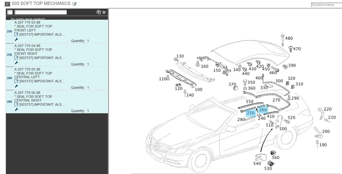

If you have not already done so first clean/lubricate seals. Cost effective alternatives to OEM: Krytox or 303. Should you decide to skip this process or it does not resolve matter attached parts #s should be correct for replacement if you want confirmation post VIN.

many thanks, ive removed the seals and applied revitaliser.
Just spoke to MB parts department and they've also set the drawing you've attached.
just waiting for a price.
