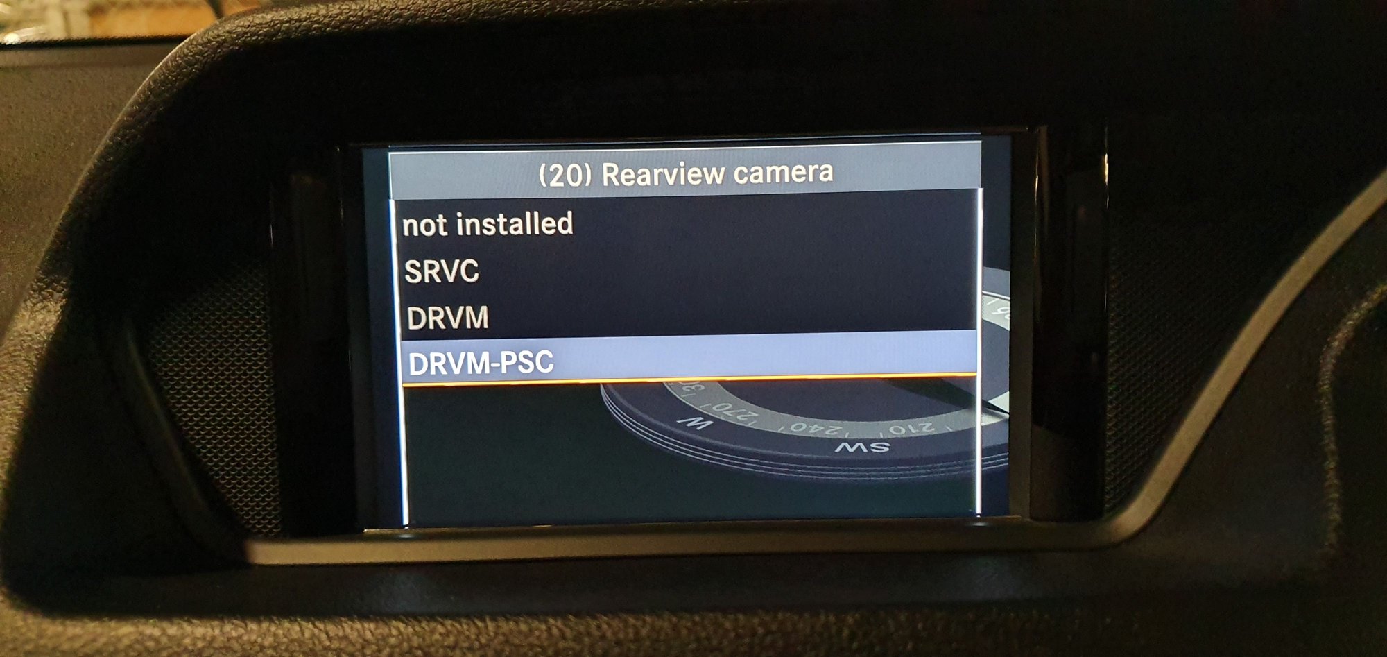

I am little late to this but my wife needs reverse camera. I have searched the forum and got useful information but I am stuck at enabling reverse camera in engineering mode.
As I understand once reverse camera is enabled in engineering mode blank image should appear on screen when in reverse gear. In settings, 'activate by R gear' is checked however when in reverse gear I don't see the blank screen.
I have attached some pics of my settings.
I have two questions;
1. Am I missing some settings that trigger the reverse image when in reverse gear? Please see images for options that I have when in engineering mode.

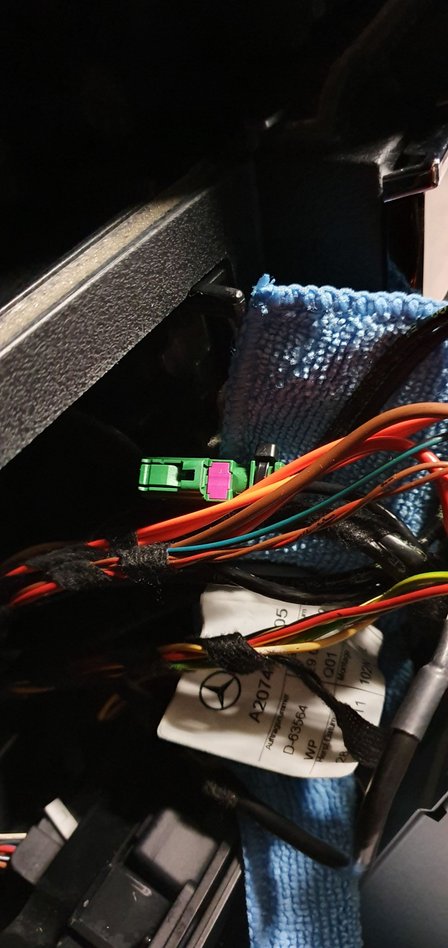

2. There is a spare green fakra sitting at the back, anyone knows what's it for? Is my car pre wired? Can I use it for reverse camera?
