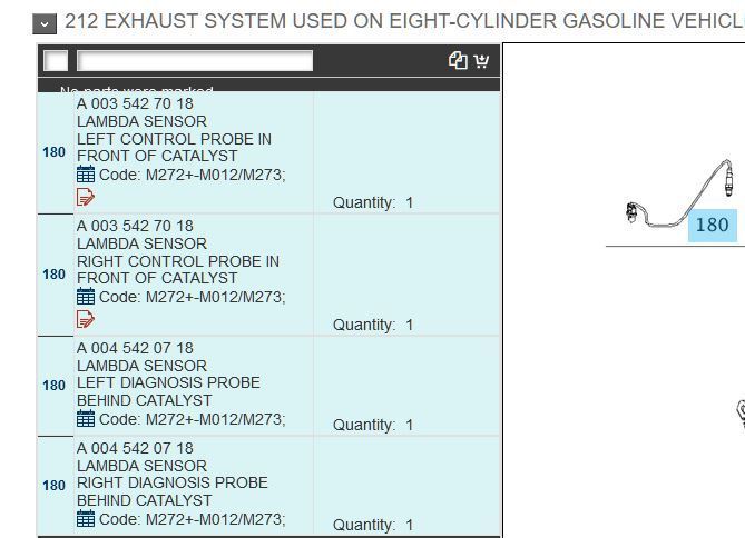

Question No rear O2 sensors on c207?
Maybe a dumb question, sorry if that sounds so, but I could not find a rear (after cat) oxy sensors on my vehicle. The exhaust system is bone stock but shorty headers. While working on the headers I have noticed there is only one pair of O2 sensors, right before catalytic converters.
C207 2010 e550 coupe with m273 engine.
Any idea if this is the way it's supposed to be would be more than welcomed.

https://workshop-manuals.com/mercede...onverter_left/
http://workshop-manuals.com/mercedes...eft/page_2356/

Oh well, I looked at the wrong spot then thanks so much I have them right there.
