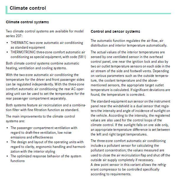

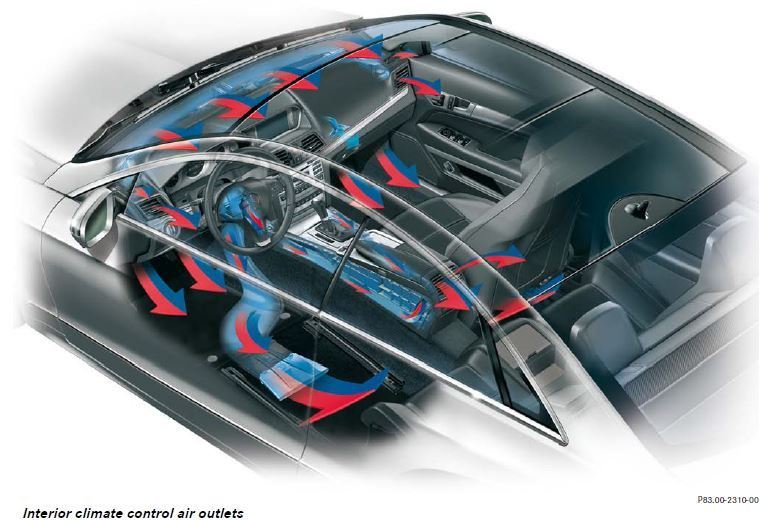

Could be a sensor, need to pull fault codes using MB diagnostics.
