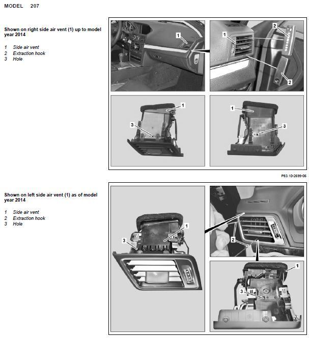

Folks,
My right passenger AC vent is stuck closed, looks like the mechanism is either broke or hopefully can be fixed. Does anyone have an idea on how to remove the vent?

Solved the issue.. Pulled out the vent and the control arm was disconnected. 5 second fix and back in business.

File Type: pdf
