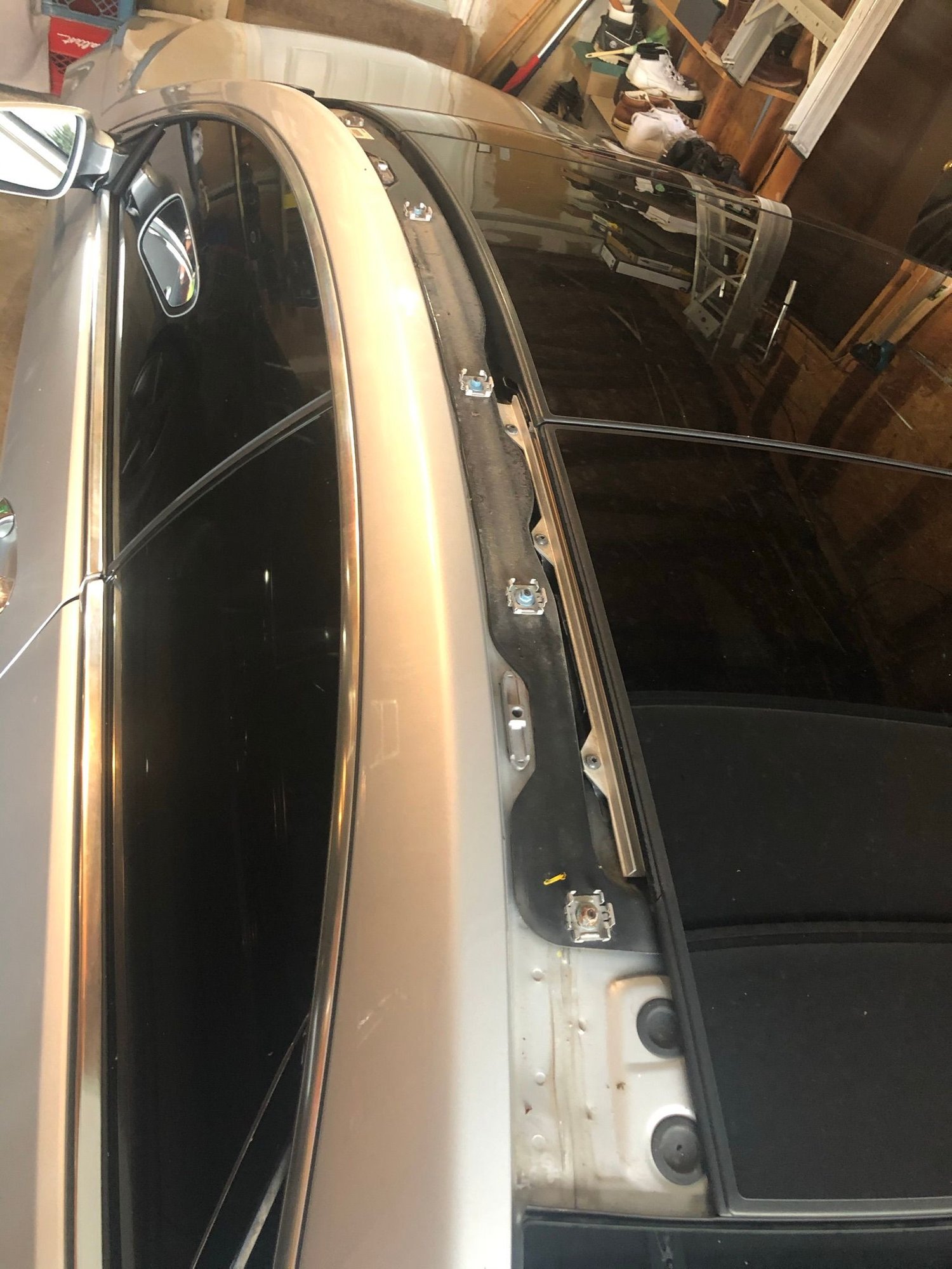

One of the 4 small covers (i believe to attach a roof rack) went missing the other day? Mercedes doesnt sell the plastic cover piece individually - have to puchase the side moulding/trim piece altogether for $233 CA+tax.
Here is an example: https://www.mboemparts.com/oem-parts...ing-2076900780
Any way/where to purchase just the small cover (read driver side) ?
Thanks for your time.

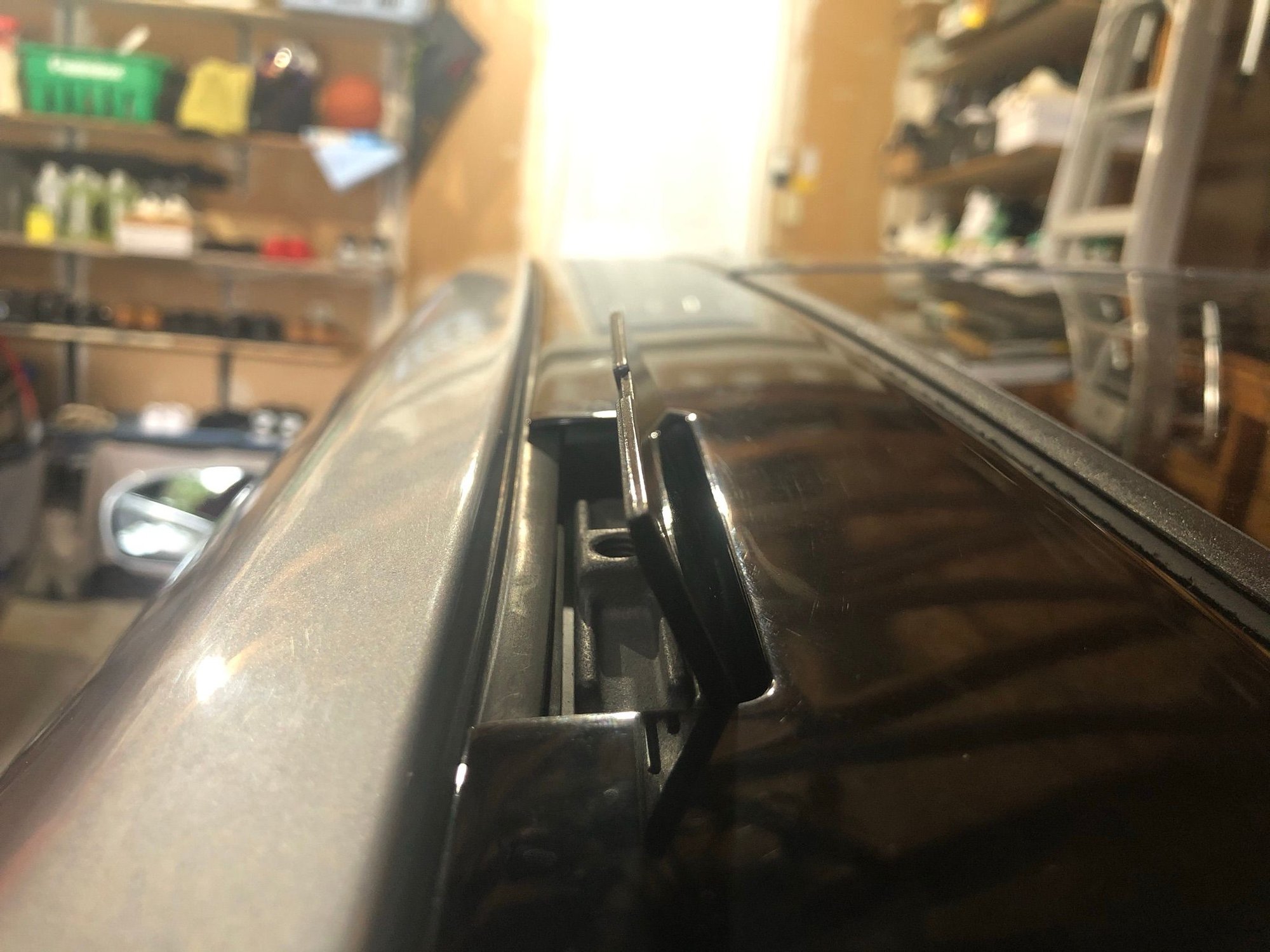

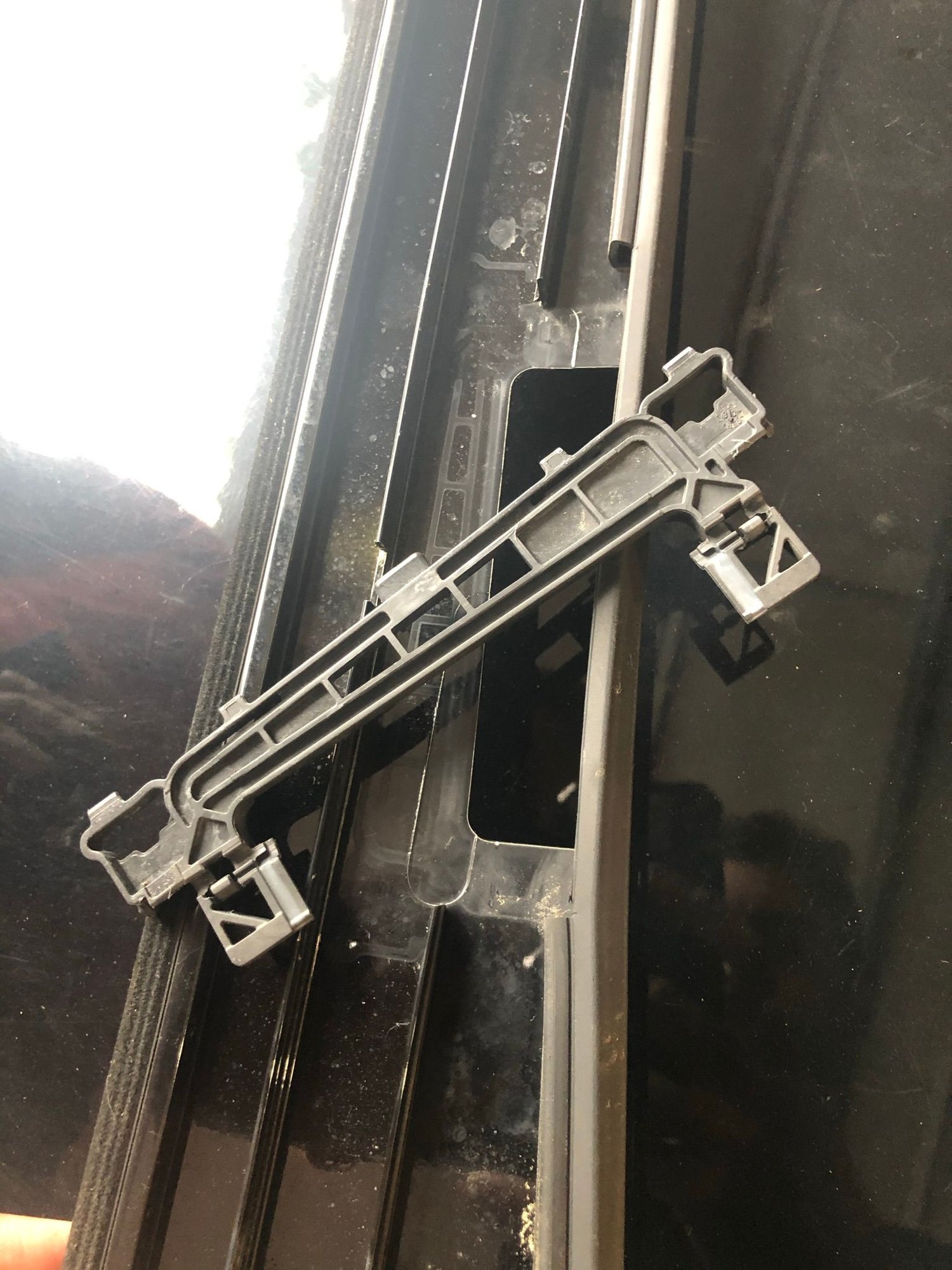

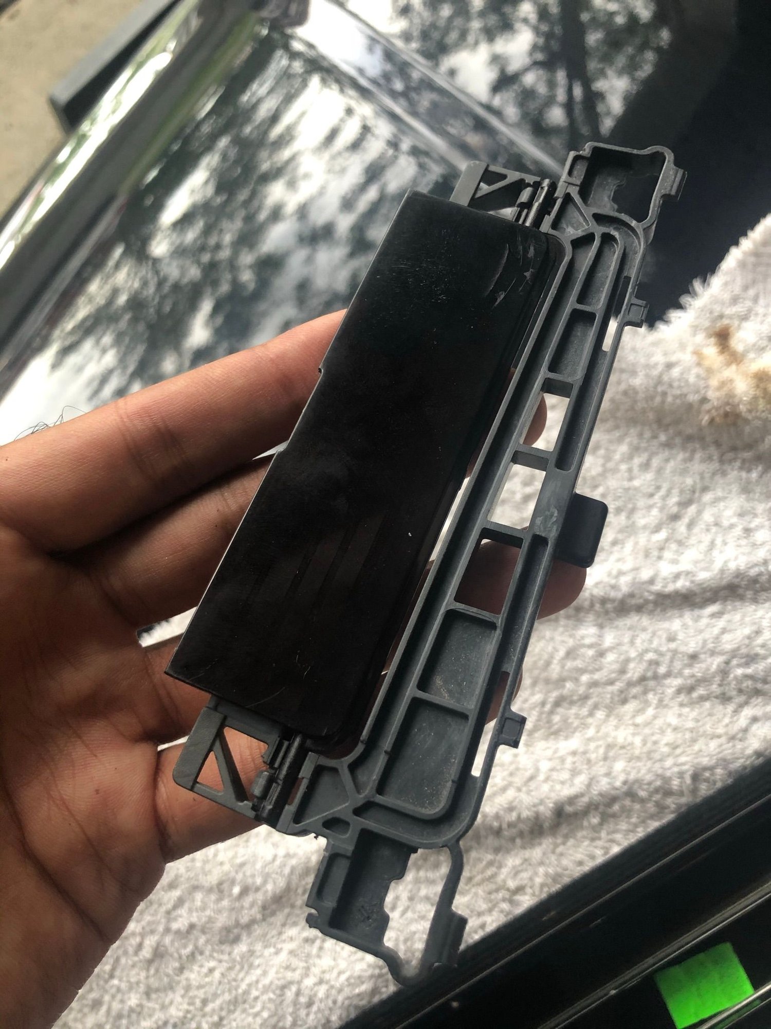

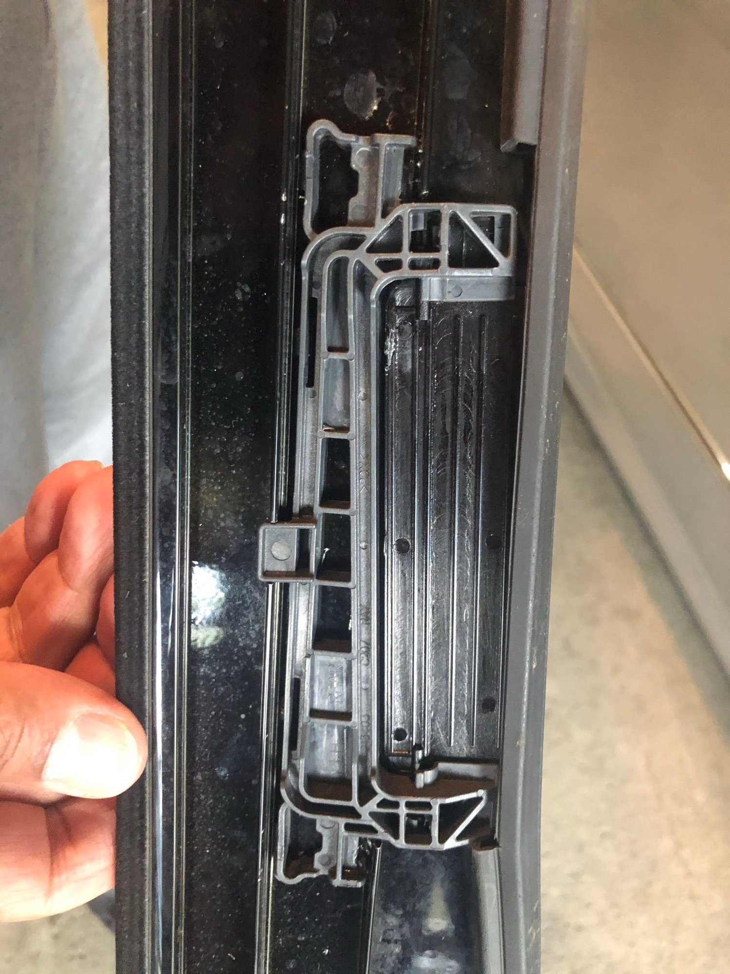

So I received the piece - installed it, and it’s almost perfect, except it doesn’t open all the way. If I push further I fear the tension will snap it. But at least it’s covered now. Added some pictures to help anyone else.
Using a wedge tool start at the rear to pop the mounding off working your way to the front
Once the mounding is off, use a wedge or screwdriver to pop the holding piece off carefully.
Add the replacement cover
Secure it back together
This is what it looks like after reassembling the mounding. As you can see it does not open all the way - I didn’t want to break it so left it as is.
