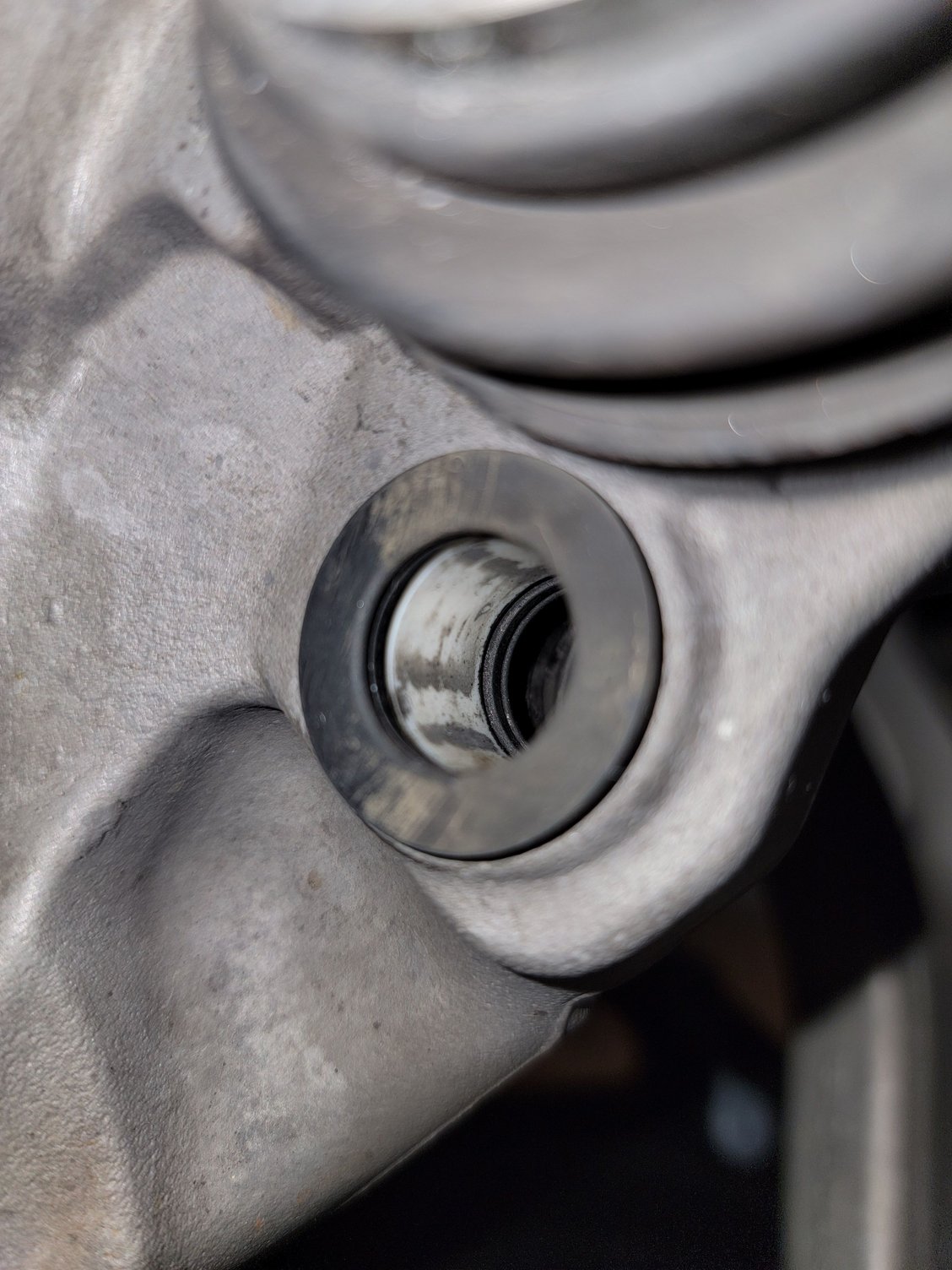

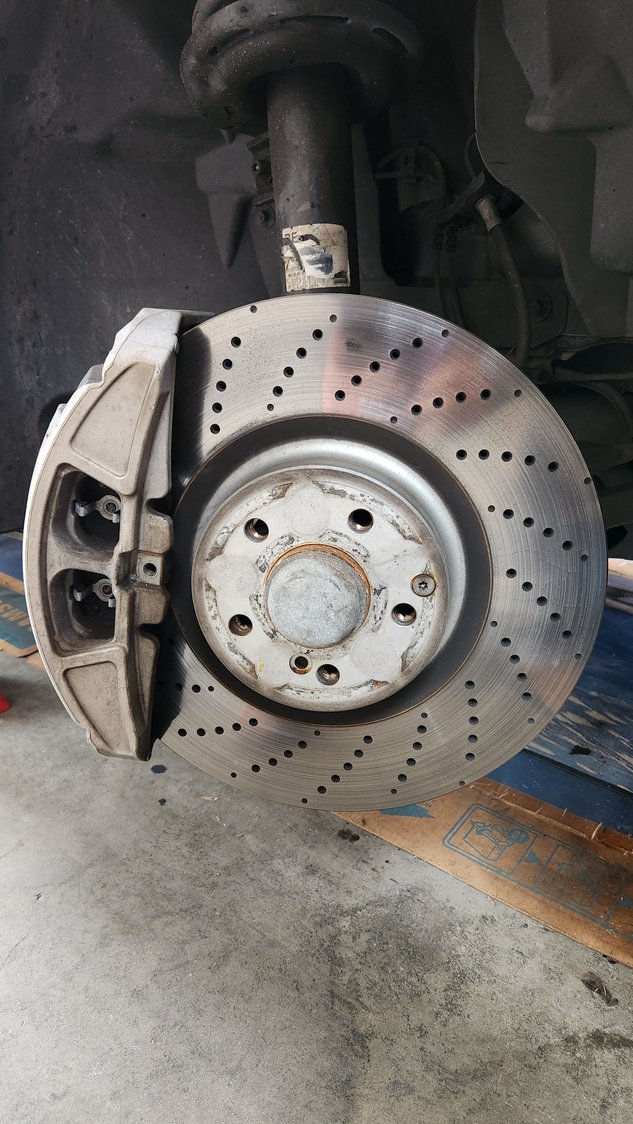

Hello everyone! I have a 2012 E550 convertible with the Appearance package that includes the cross drilled rotors. I was all excited today as I thought I'd be replacing my front brake pads and rotors but there's something hella weird about these damn calipers. When I went to remove the bolts securing the calipers, I could NOT put anything on there. I kept on trying any allen socket that seemed to be the pattern on the bolts but the 7mm should be the right size but it's a tiiinnyy bit too large, the 6mm is far too small. No matter how far and wide I searched online and on here, none of the calipers seem to match mine and none have that weird *** bolt. Has anyone swapped these before? Is there a DIY guide specific for this? Am I missing something/doing something wrong?!
Any help is VERY appreciated as this alone stopped me from being able to do this
Looks like it would be a HEX 7mm tool
But 7 is BARELY big enough and 6mm is far too tiny

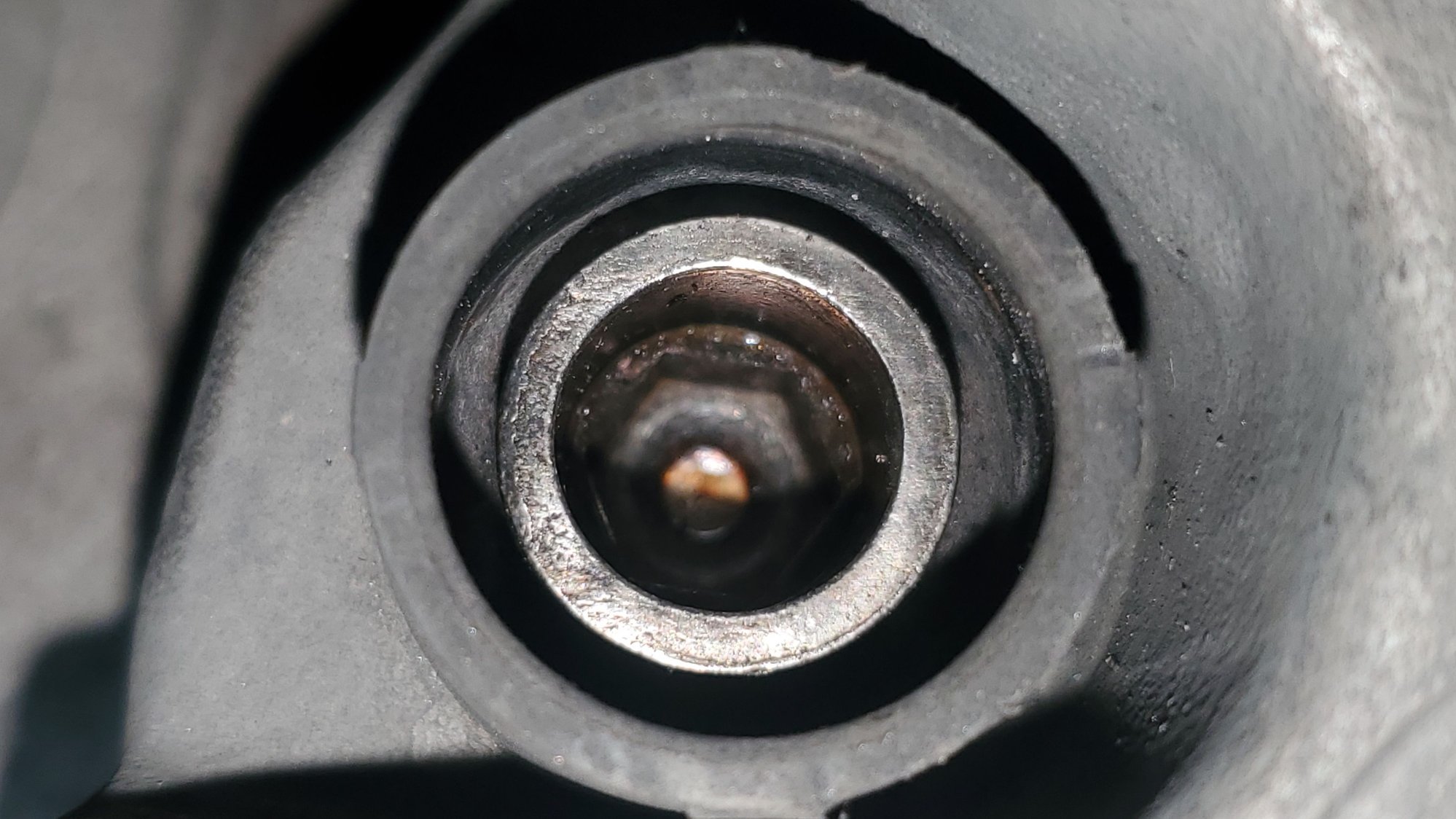

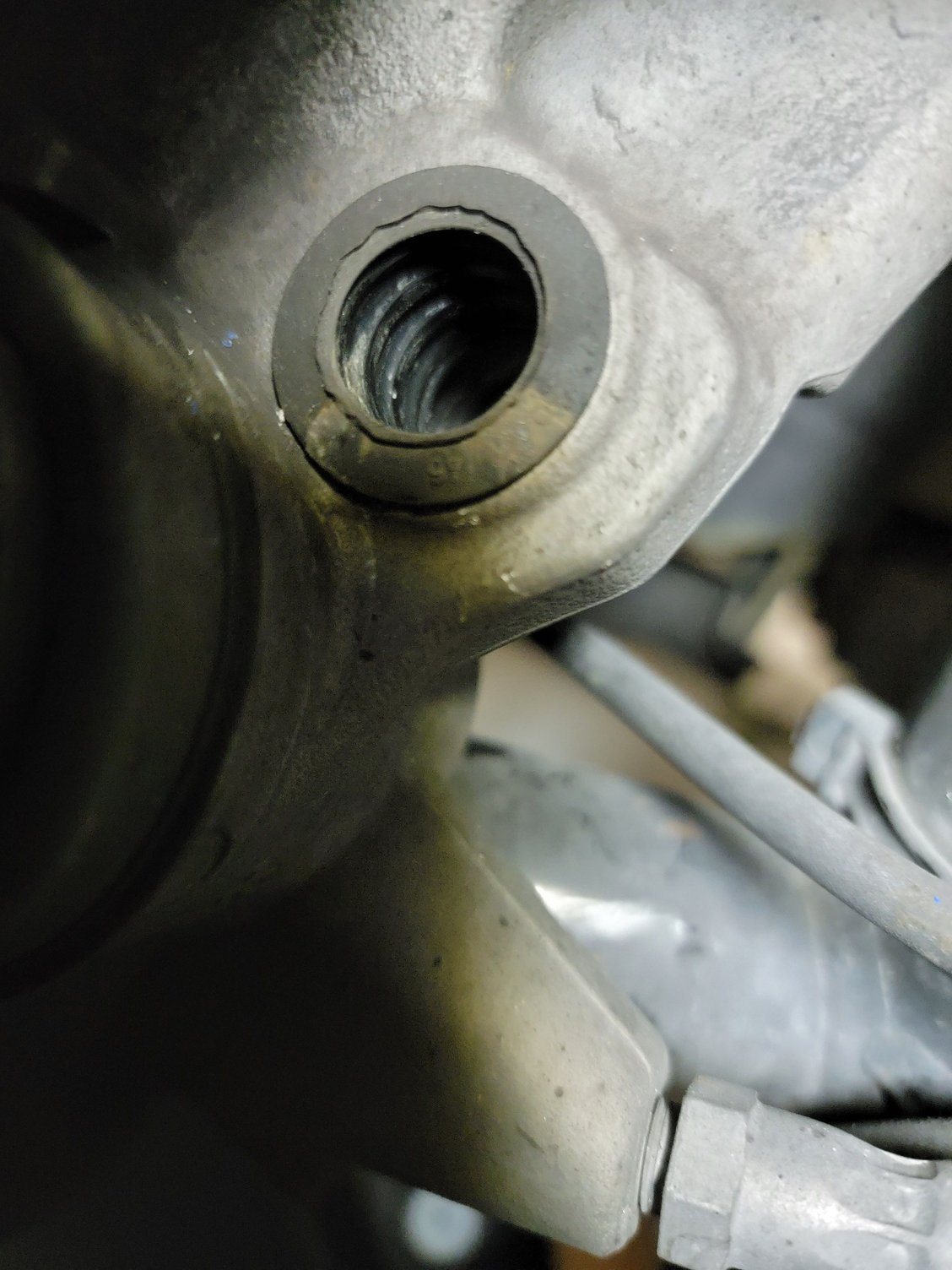

Just did mine Saturday
9mm hex wrench
Looks similar
I had a bushing in the bottom guide and nothing in the top. I would be curious if yours is the same, thanks
Top pin - no bushing
Lower pin with bushing inside.

Yep they're 9mm
