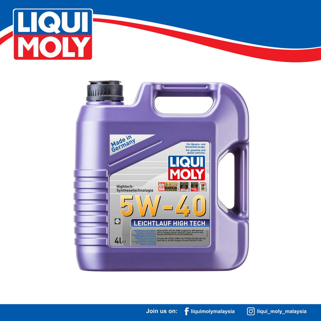

This is what I normally use as its MB 229.5 approved for M276 engines.

Consider Motul and Pennzoil as well with 5W-40.
