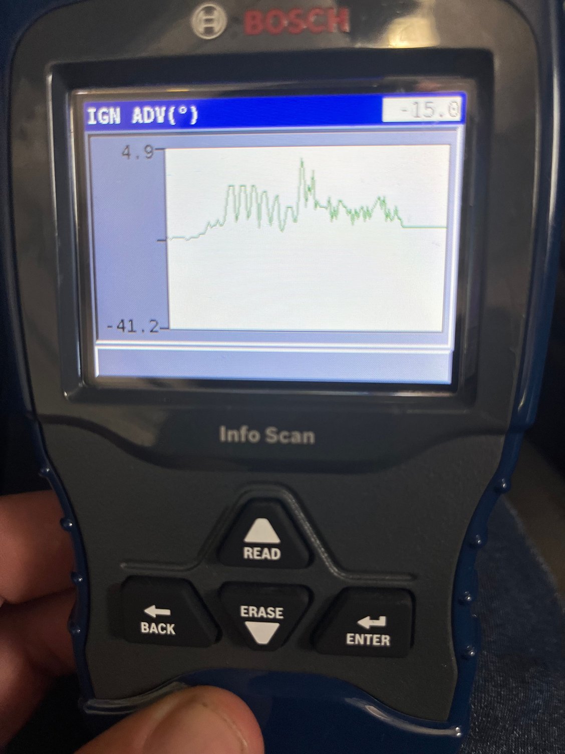

Cheap scanner
Start with getting a simple Bosch 1150 scanner like this. They’re about $55 right now and can see codes, data, and graphs. Simple and effective!
Get a graph of the ignition advance of startup.
