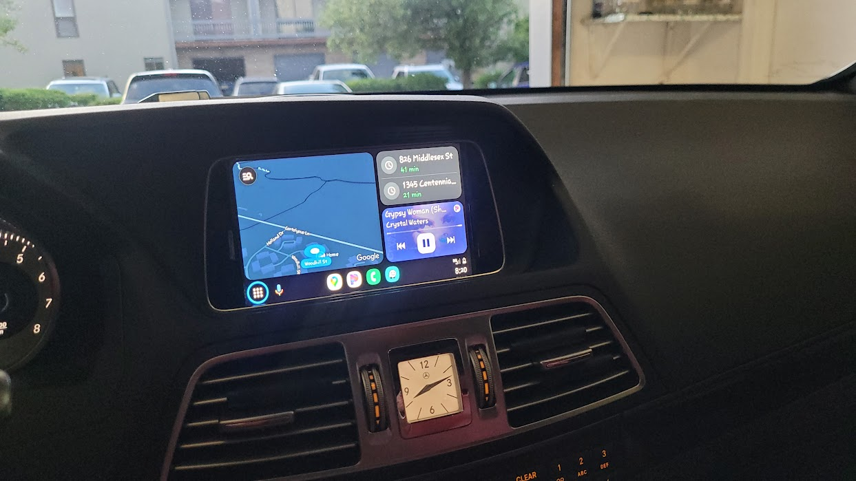

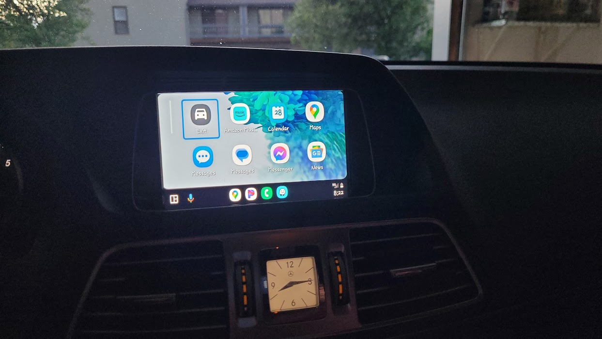

I have Android auto in my e Coupe and love it,,, Best upgrade that I added to the vehicle!!
which module you used? I am still debating if I go install then 12.3" android screen or just go with the module.
Old Aug 5, 2024 | 05:33 AM
e55amg00's Avatar
Joined: Feb 2005
Posts: 134
From: New Jersey
2017 Alfa Giulia gone, 2004 e55 amg gone,2014 E550 coupe white,2010 E550 coupe white, 2018 giulia ti
It's by Roadtoo I believe. I'll double check
