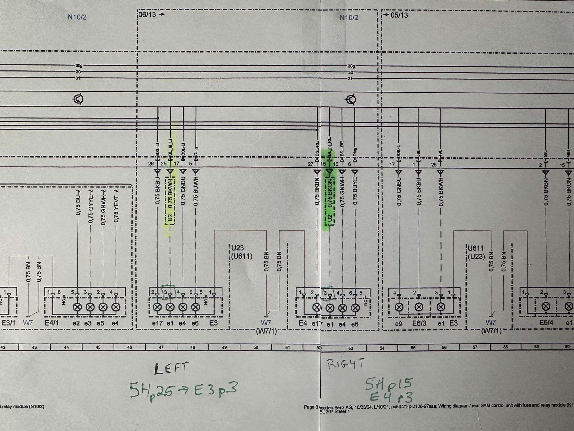

So now I am looking for help on which pins on the sam I need to run the wires.
Some people I have researched have said it is just reprogramming, but that doesn't make sense, since there is no wire in the US connector going to the EU pin in on the tail light.

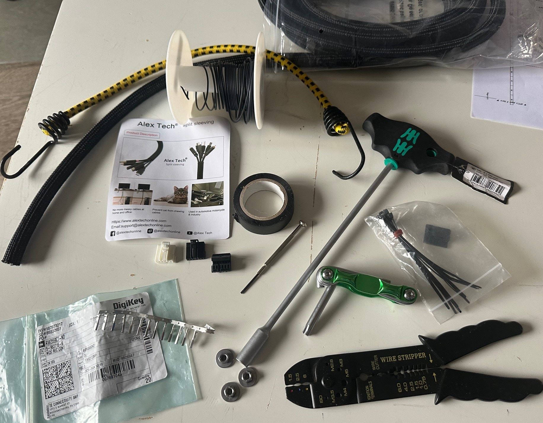

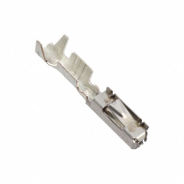

5-963715-6 TE Connectivity AMP Connectors (4 needed, buy extra)
A0255452226 Contact Bushing ( 2 needed buy extra because plastic can break) (Black connector in picture, Some people shave off the tab on the US version (White in picture) to fit the EU socker, but it is better to just get the right connector)
Automotive High temp wire 0.5 (20 gauge)
Tools in attachment Picture:
Liner removal T-40 wrench for removal of tie down, Bungee to help hold liner when folded back, Trim tool (not shown)
Long throw 8mm wrench (the forward light nuts are a pain , recessed, easy to lose extenders/socket into the frame)
Wire cutter/ stripper/Crimping tool
Small screw driver to release connector pins from sockets
Split sleeving and electrical tape for wire dressing

Prepare new wire with Connectors (Same connector pin on both ends) (Length from each Light to 5H connector in Rear SAM, leave room for routing)
Prepare connector - Add new Wire to slot three, and add other wires to same location in new connector
Run Wire To rear SAM 5H- Left to Pin 25, Right to pin 15
