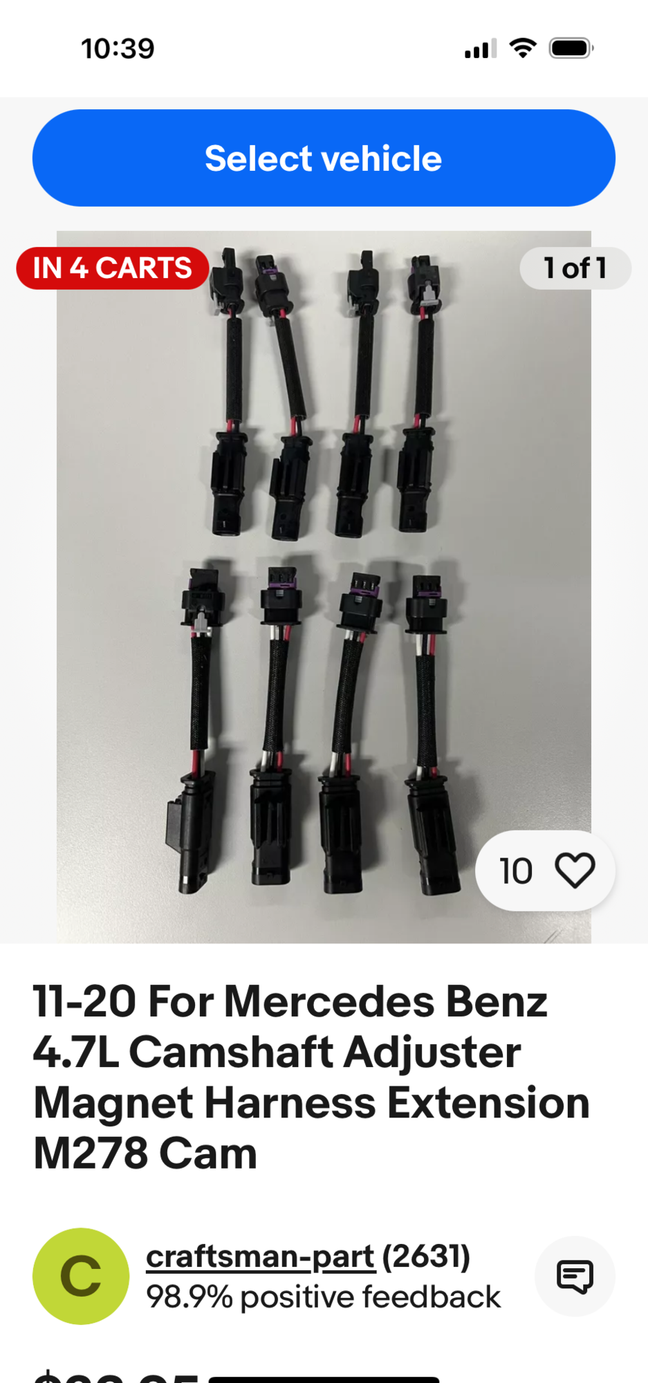

well I got an 8 piece set of pigtails on eBay for $25 and they fit! It says they for the 4.7 V8 but they still fit on my V6. Look em up on eBay 4 pieces 2 pin and 4 pieces 3 pin. I hooked up all the 2 pins and 2 of the 3 pins but I have no idea where the other two 3 pins go. I did not change out the leaking camshaft solenoids just put the pigtails on. How long does it usually take for the oil to get through the pigtails? Anyway, the engine seems to be running a lot smoother though that’s probably just in my head 😁here’s the page:

just be carful you hook them up right. Look for the little groove on the inside of one and the slot on the inside of the other.
Which pin configuration (2 pin or 3 pin) connects to the cam adjuster solenoids, and which connects to the cam position sensors?

2015 mercedes benz e400 4matic
solenoids 2 pin. Cam pos sensors 3 pin

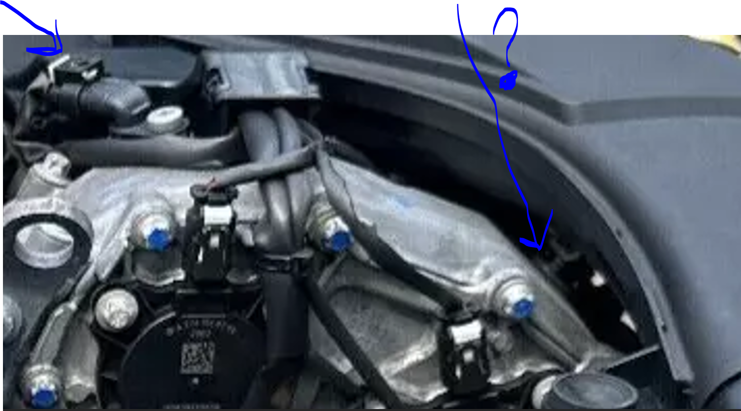

well I couldn’t find them so I assume they are probably hard to access 😁
Did you remove the air ducts on both sides? The position sensor must be at the top of the VVT, The two intake are obvious, the exhaust ones are a bit toward the air ducts
yrs I took off the air ducts. Might have missed that lower one though
