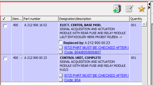

Greetings for the two body series you wrote, I can't find any rear sam that are interchangeable. I'm attaching two pictures with the EPC parts for each series. PS: Even if you absurdly change them without any modification ... they don't have the same configuration, only the code, only the software version or only the configuration may be different ... they won't work as long as you don't have the coding and the corresponding variant from your datacard. You can do the coding with vediamo if you know the variant you have very well and all the factory option codes, or, you can approach an SCN coding at a Mercedes dealer, this can be done either at the dealership or at an authorized Mercedes repairer. You can't do it at home.
If you want everything to be plug & play, look for a rear sam that has all 3 Mercedes codes identical to yours. LU; HW; SW. Even so, if we are talking about a second-hand one, the choice is a "lottery" because you have no way of knowing if the software and the written version of the rear sam you purchased are correct until you install it on the car.
Accepting the return of the product in case it is inappropriate is highly recommended if you want to be sure that you can avoid some discomfort.
NB: In the images you will notice the codes in the chronological order of their use in production A *** *** **1 - replaced by A *** *** **2 - and so on until the last version used.
I hope I was helpful. Good luck.
REAR SAM CODES FOR WDDKK5KF4EF252085
REAR SAM CODES FOR WDDKK7CF6BF074055

Thank you for the reply! I took a gamble and purchased. Fortunately, all functions are working properly minus intermittent issues with the wipers and telescopic steering wheel adjustments. But all my codes and warning lights have disagreed from the dash! Seems (for now) like i hit the lotto!

Hi, I'm glad to hear that but try to find someone to reconfigure the rear sam you bought. Maybe an intermittent error or two on unimportant modules for you might seem like nothing but keep in mind that the rear sam exchanges information with almost all the modules of the car on different CAN networks, even LIN.... Believe me you don't want to end up unraveling the hell that can be unleashed in the electronics of Mercedes cars )) All the best!
