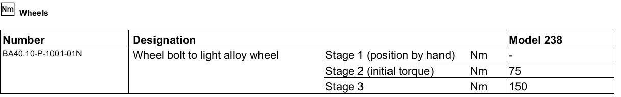

What is the wheel stud torque at?
Thanks.

So it is 111 ft-lb. It is almost the same torque as a SUV.
Thanks.
