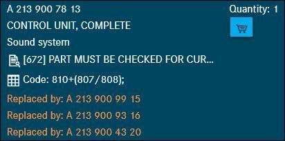

I have a channel down on my premium sound unit.
A2139009915
What do the last four digits represent? I see lots of units for sale but the last four digits are different. Can i replace mine with any unit as long as it starts A213900

VIN, I will check for compatible part #s.

No. Reluctant to post VIN here are compatible n40/3 parts #s. Attachment may assist in diagnosing.
