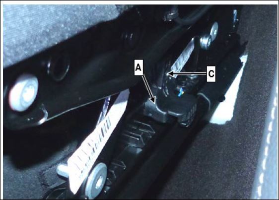

Suggest they revisit/check seat switches for proper signaling also if this is a North American vehicle Hall sensors (A in photo, located on seat adjustment assembly) to both seats.
