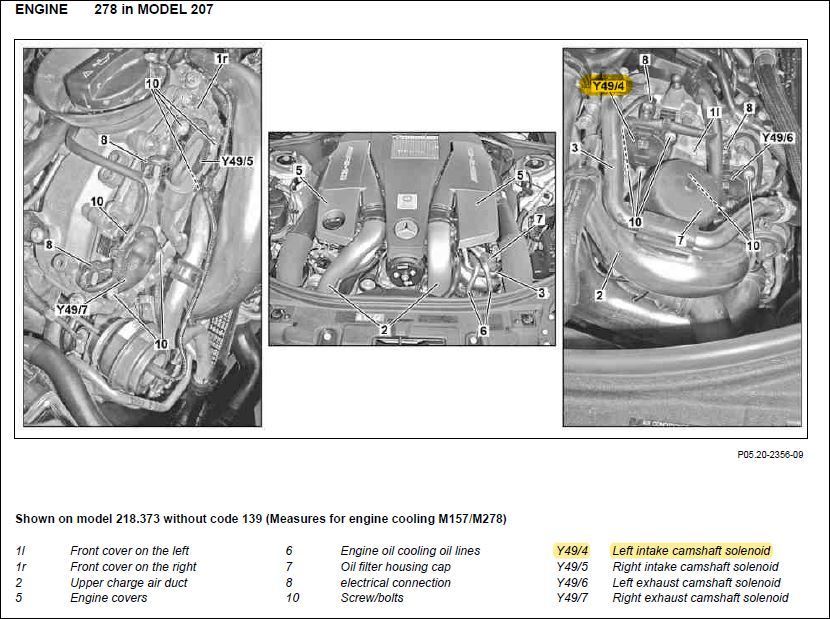

My engine light came on after changing my Oxygen sensor and code P0347 came up upon driving, from my understanding it is a camshaft sensor but I do not know where it is located, could someone point me in the right direction?

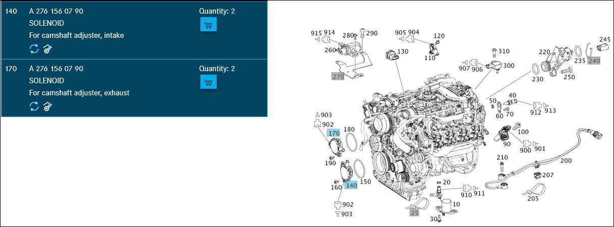

Intake solenoid (140 in diagram), bank 2 = driver side. Visually inspect connector/harness before replacing if found to be solenoid I suggest replacing all four 1x, your call. BTW 12 e550 Cabriolet = 207 should be posting here: https://mbworld.org/forums/e-class-c...brio-a207-141/
