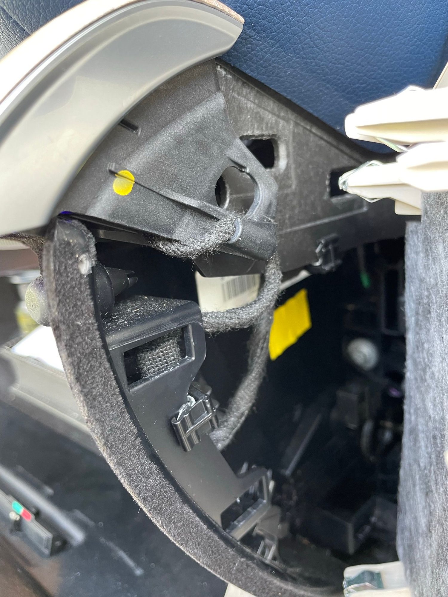

Biggest problem I encountered was a metal retaining clip from the left hand trim piece fell out and I had to remove the black lower panel above the drivers feet. If you ever have to do it the hood release will be the bane of your existence. Enough said or I'll just go start reliving it. Errrrrrrrr.

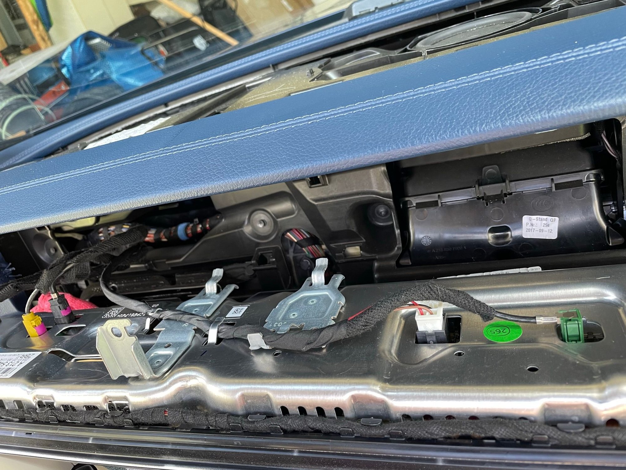

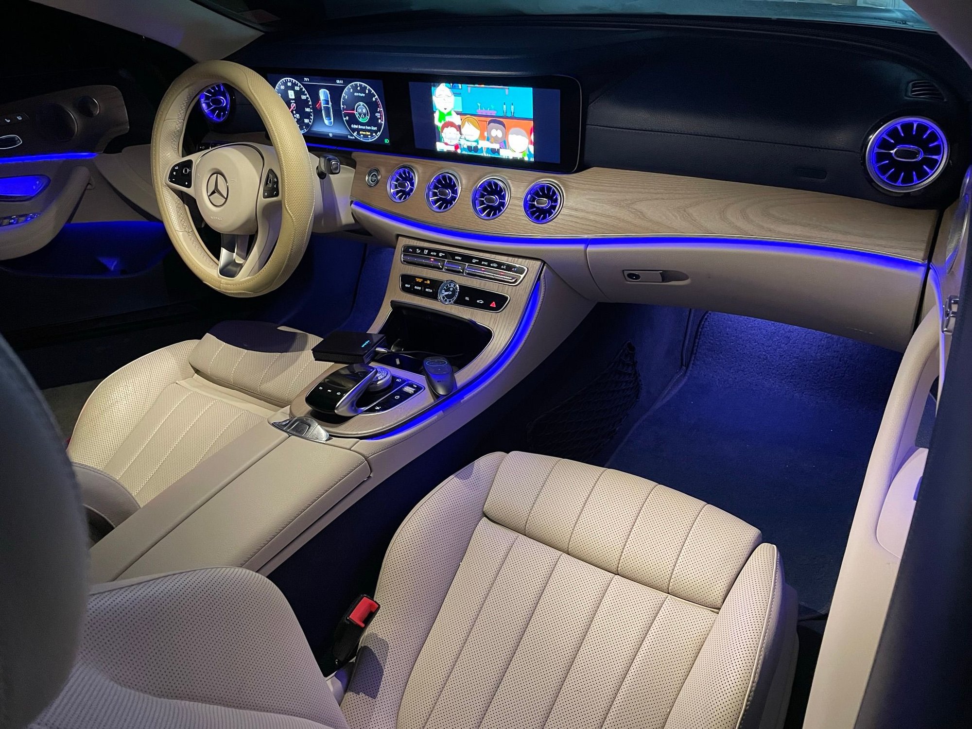

Here are some pics - Notice the DigiDash streaming HBO MAX to the Entertainment screen. Best toy ever!

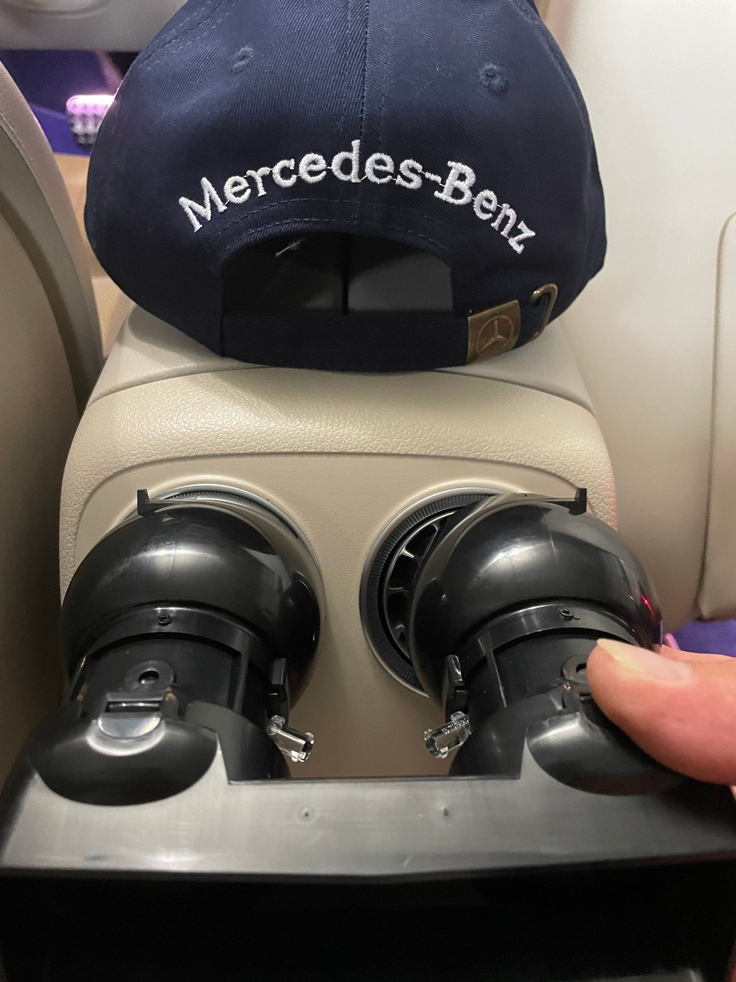

This is the difference between a sedan and a coupe/convertible. The diameter of the vents is correct but the distance between centers is larger on the sedan.
Wanted to take a pic before I took the RH end loose. The LED connecter has to be removed from the trim panel once it's loose in order to remove the trim panel. Notice it goes under the trim panel when reinstalling it.

Love the new look!

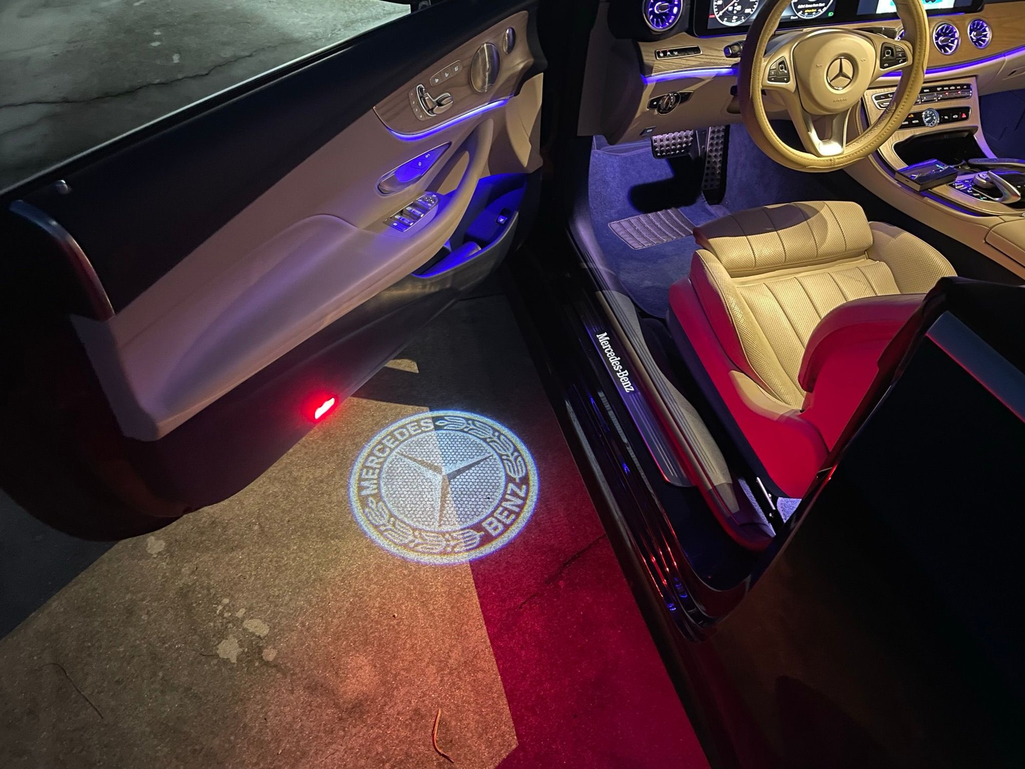

I also replaced the LH illuminated sill plate today. The last owner really abused it and it was all scratched up. Now it's new and the scratches in the sill area paint were also buffed out today.

what's that box and remote for in the center console?

It's a DigiDash. It's an Android based mini computer designed to work with Apple Car Play on your car. It allows me to stream video on the dash display. Notice the dash screen shows South Park which I was streaming from HBO from my home wireless network. On the road it hotspots to my cell phone for signal. It also allows a wireless connection to Apple Car Play from your phone. I just used it on a trip to NC. You can move it to any vehicle with Apple Car Play. The remote goes with it for non touch screen vehicles but it should be purchased as certain apps don't work without it the website states. A little pricey but what fun.
https://digidash.store/
Here's the website so you can learn more about it.
