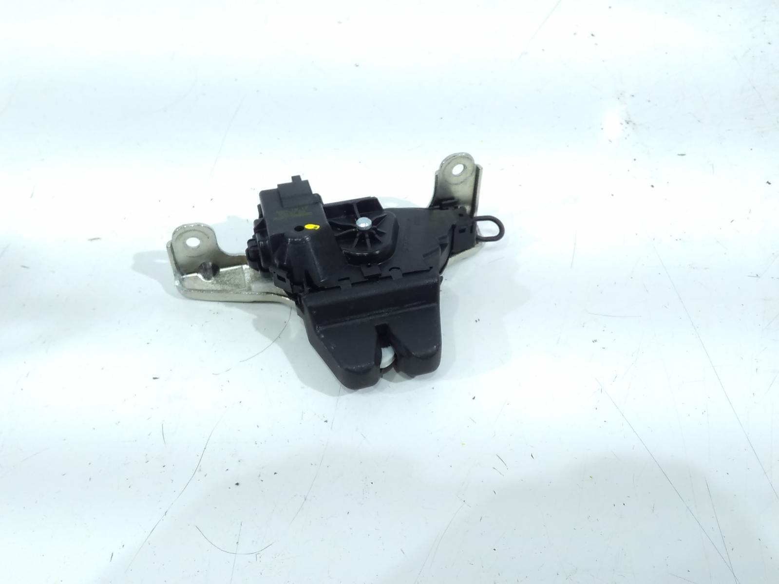

f435 (40A, control unit) @ rear SAM - lock, motor, drive, closing bracket need to be checked. If you want associated part #s provide VIN.

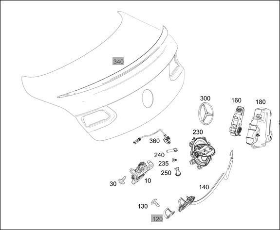

I did check F435 as it was a hefty size fuse and it looked OK. Might change it just to be on the safe side. Is the tail on part 140 a cable to manually pull or is it an electric cable? I can undo bolt 130 probs from inside but not sure that will help. Just easier to mess with back of badge with boot open. I did change it for like for like part number and it was fine. Changed it as the spring wasnt springing back once it had been opened! Manually trying to open from the outside also makes no noises or attempts

Old Apr 5, 2023 | 01:04 PM
konigstiger's Avatar
Posts: 15,901
Likes: 4,633
From: North Scottsdale, AZ
'71 Pinto
Assembly cable to motor.

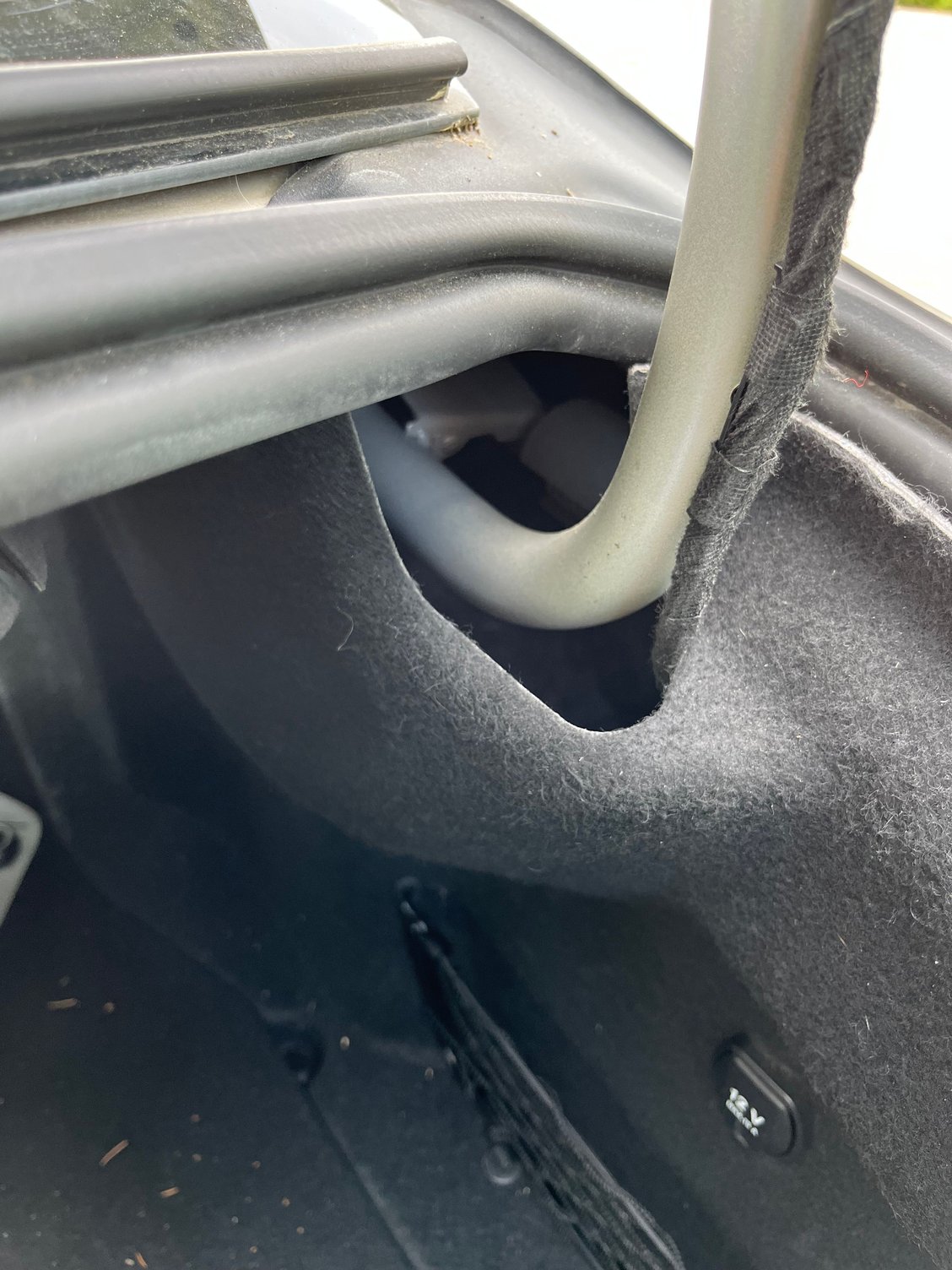

So I have been crawling around the boot again all day yesterday. I have no button as per the picture though it is hard to make out. Only thing I can think of is it maybe behind the warning triangle? I have nothing else otherwise. And in the UK cars doesn't look like I have that switch either for the separate boot locking. This is a nightmare haha!

Hours of crawling again and cannot locate that button at all. Going to say UK spec doesn't have this. Car has started doing a weird thing where when the front sensors go off I can hear the rear camera open up, but not show on screen. NEver used to do this. Unsure what the hell is going on but very, very annoying not having an emergency boot release

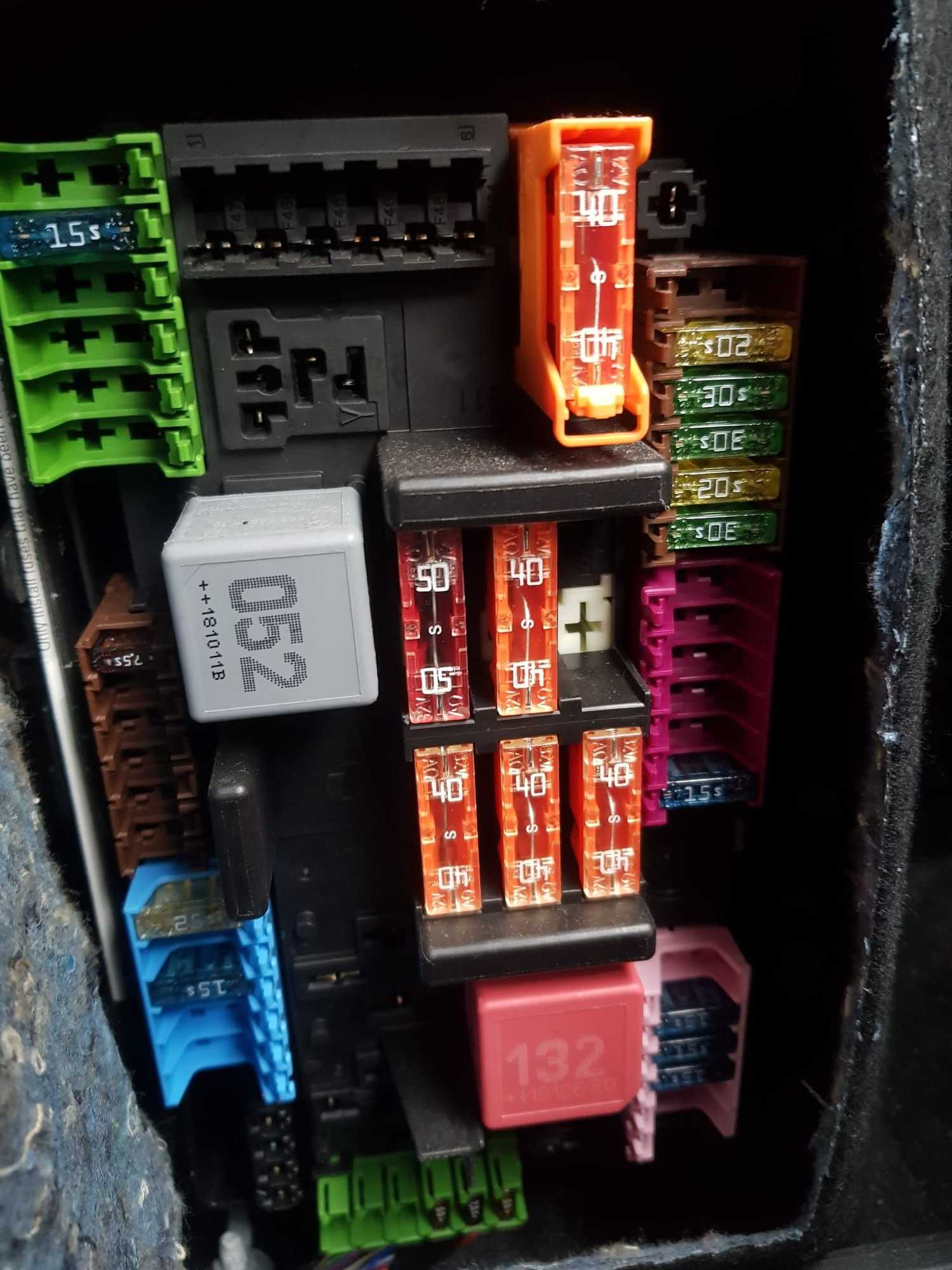

hi just wondered if anyone can tell me which fuse is for the boot please see photo, the boot opens but then immediately closes tia for advice
Old Mar 25, 2024 | 08:06 AM
curlyman's Avatar
Joined: Mar 2024
e class w213 estate
hi all found which fuse it is its the 40amp top right pulled fuse to reset system but boot still does not stay open any ideas anyone ?

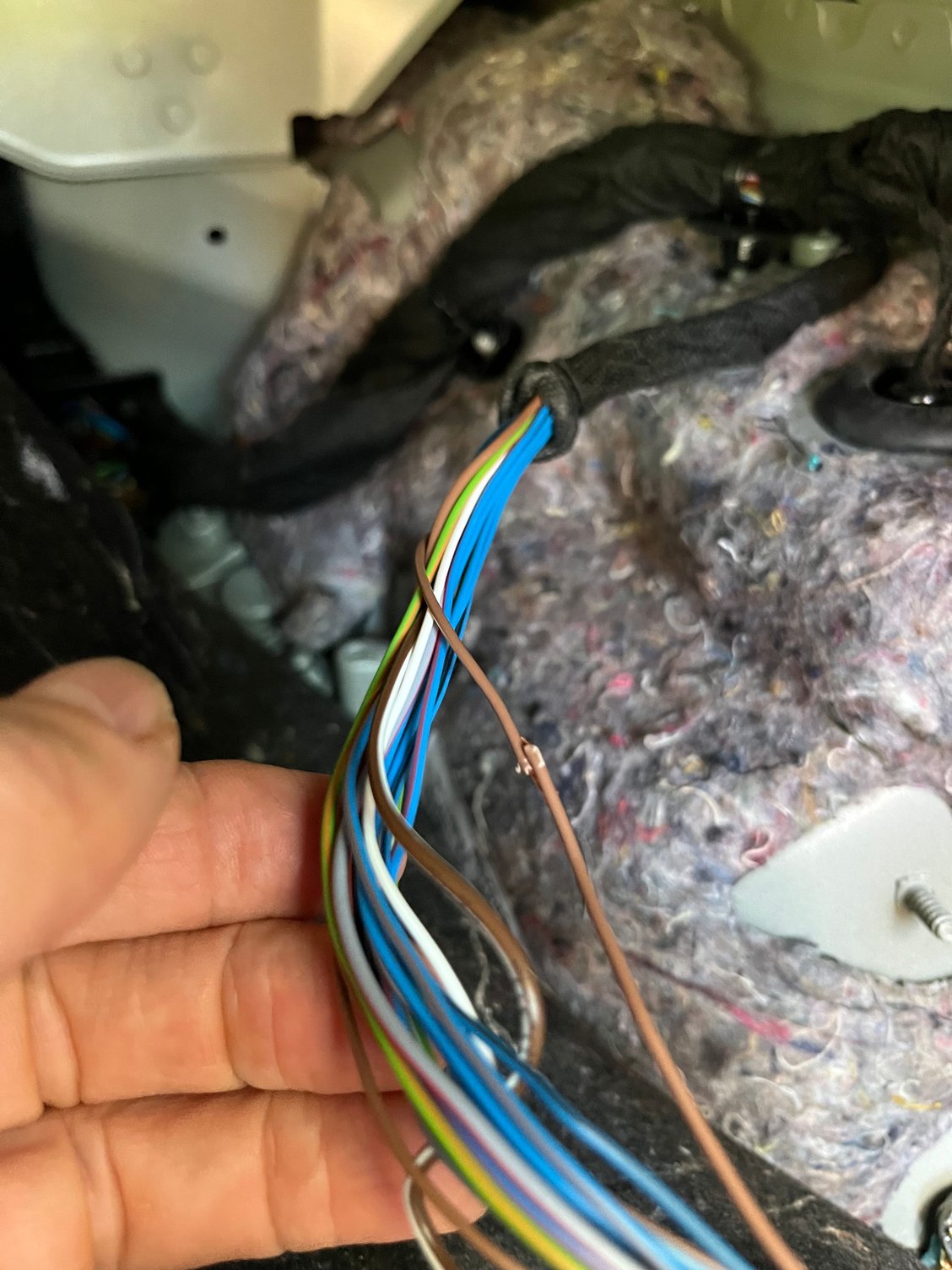

On my C238 trunk didn’t open or close. At first the trunk opened normally but wouldn't close using the trunk lid button. Without thinking about the outcome (stupid me) I closed the trunk by hand, only to find out that it didn’t open anymore
After searching the forum I found this video and crawled into the trunk through the back seat. Inside the trunk I unfastened the 4 clips on the plastic trim at the trunk lid. After 15 minutes of searching I finally found the small clip to open the lid. When the trunk was finally open, I noticed that the trunk light didn't work either.
I then checked the wires on both sides hinges and found a broken wire on the right hand side, just inside the plastic "hose" that allows the wires to twist when the trunk is opened.
In my case, the brown wire was cut off like with scissors. For testing, I temporarily connected the copper wires and everything worked
I also had an intermittent problem with the reversing camera, which was caused by another damaged wire. This was one of the blue wires. I think it is power or signal for the camera flap as the image was shown only for 1-2 seconds and then turned black. Fixing this wire fixed the problem with the reversing camera.
