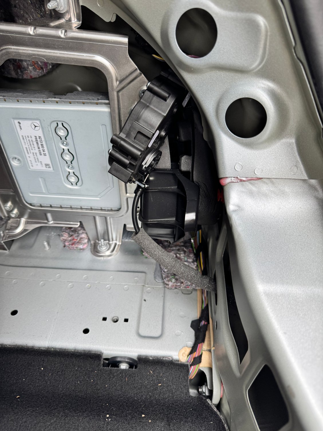

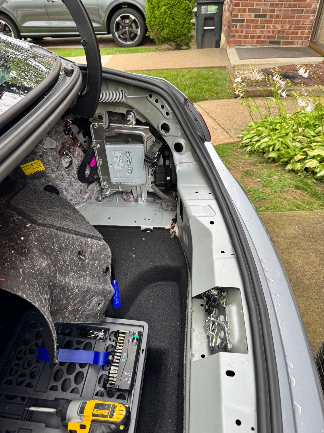

problem solved. It was the the trunk lid lock actuator part# A204 750 0060 which fits lots of models and years with soft close option. Pictures show the location on 2021 E450 coupe, easy access and diy. Thanks.

Hey guys, thought I’d post my experience with this as I have had this exact problem twice now but both times have fixed it without needing a new part.
As you can see in the photos posted by the OP, it is the actuator which may be the cause of the problem. In my case, the motor itself was working fine however there is a small wire with a ball on the end which is wrapped tight around this part of the motor. When the motor operates, it pulls this wire back which pulls the boot lid down that last inch or so. Well in my case the little wire had just popped off of this bit of plastic and wasn’t being pulled, which has happened twice now and both times I have just hooked the wire back on and it works fine. I have circled the wire in question on the OP’s photo and attached below.
That being said, others may have the problem of the motor itself failing and not pulling the wire at all however I thought I would share this so others can have a look to see if it’s the same problem as I had and may save themselves money on a new part .
