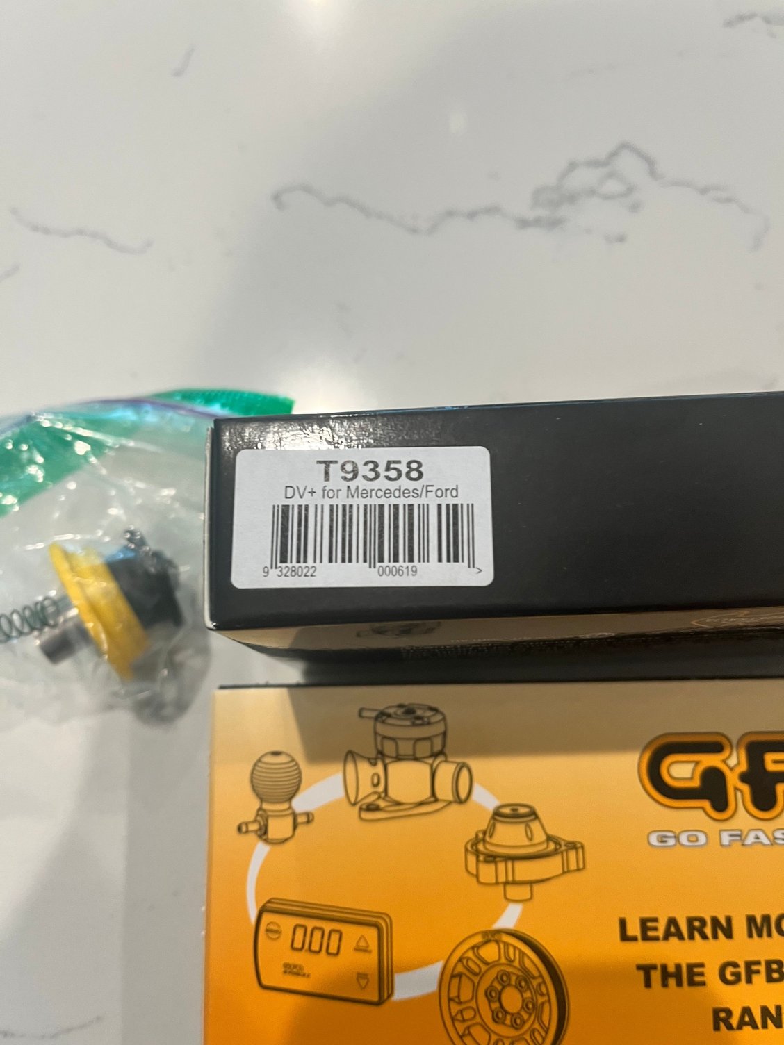

Here is the part that I bought
EDIT: I bought two of the T9358 for my TT

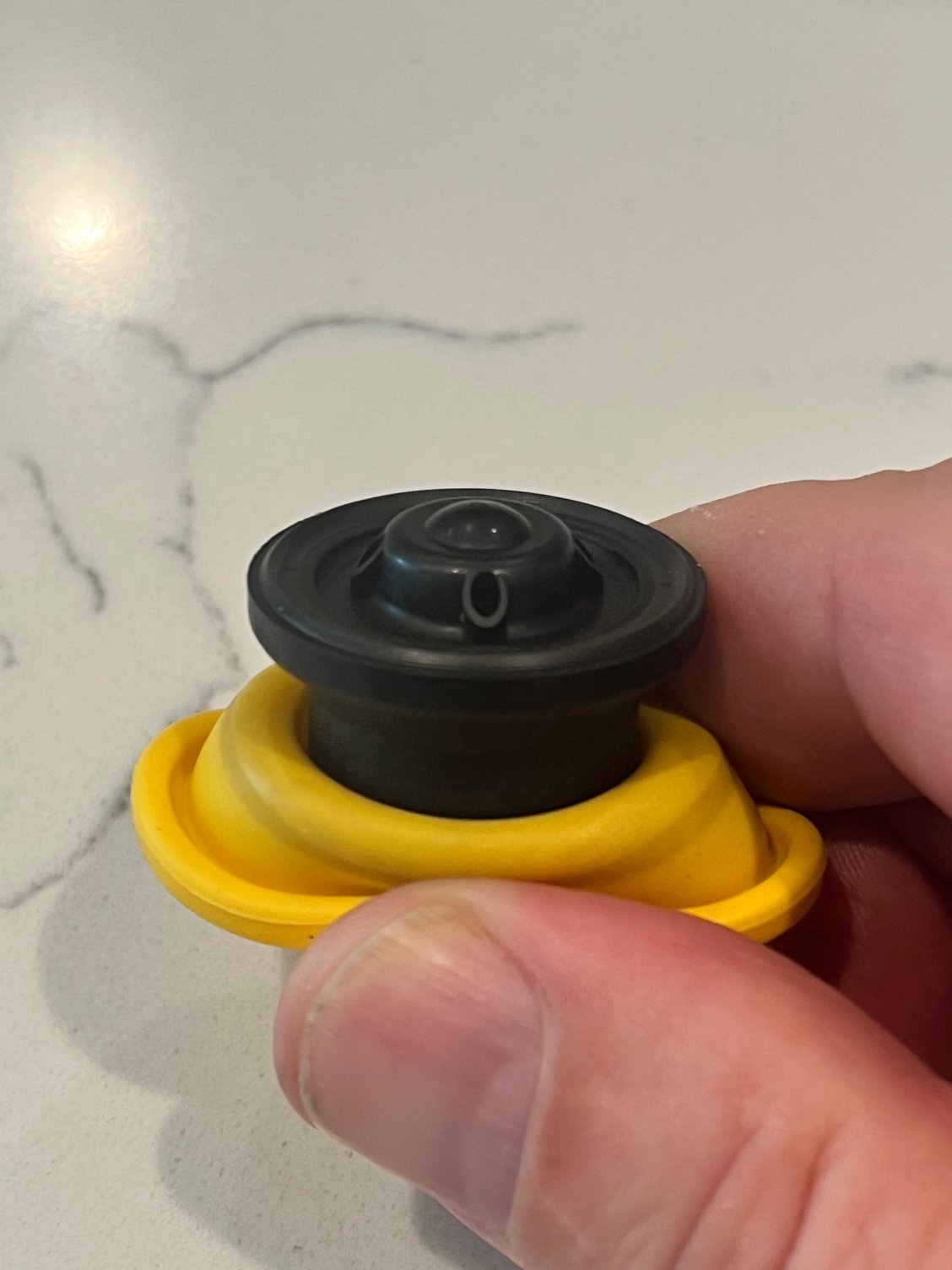

This is the stock part that is replaced

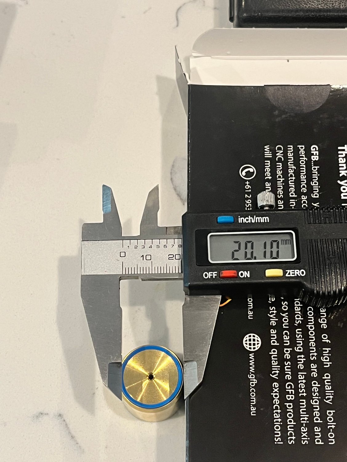

The new DV+ seal O-ring is smaller at 20mm
The original O-ring was 24mm
The DV+ is smaller but it is sealing fine in my E400. I didn’t measure the surface in the turbo but based on my results it seems to be able to accommodate either size.
