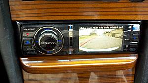

I have been toying around for a long time with installing a new stereo in my car. I have finally (after 4 months of gathering equipment) come to what I feel is a drastic improvement over the stock stereo, albeit my 14 year old son and wife disagrees, he really liked the push button am/fm tuner, and wife feels I ruined the nostalgia of the car. Although both have points, I just had to do something more as a self proclaimed audiophile I just wasn't happy any longer with the sound that the stock stereo was putting out.

-Kenwood KIV-BT901
-Kenwood CMOS-200 Rear View Camera
-Kenwood KCA-SR50 (Sirius Satellite Tuner)

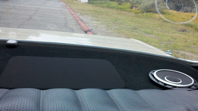

-JL Audio C2-350x 3-1/2" Evolution C2 Series 2-way Speakers Front Speakers
-JL AUDIO C2-525x 5.25" Coaxial Speakers 2-way Rear Deck Speakers

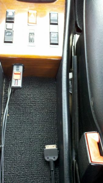

-Plugable USB 2.0 2 Port Hub

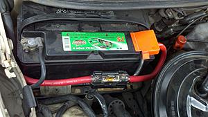

-25 feet of KnuKonceptz KCA Kable 0 Gauge Power Wire Red
-Monster 300 Series PowerSplit 2 Distribution Block - One 1/0 Gauge Input/Three 4 Gauge Outputs (MPC P300 CPS2-2)
-Monster MPC I304 4C-5M Extra Low Noise 4-Channel Car Stereo RCA Cables (5 meters)
-Monster MPC I302 2C-6M Extra Low Noise 2-Channel Car Stereo RCA Cables (6 meters)
Xscorpion Manl02p Fuse Holder w/ 150amp mini ANL Fuse
I chose the Kenwood head unit for its ability to work with my Zune, IPOD as well as a USB thumb drive. All controls for these units are through the head unit. It also has an optional rear camera installed that works really well.
I wanted speakers that would fit in the stock locations, and the JL Audios fit the bill.
The subwoofer was a real challenge as I really wanted to save as much trunk space as possible, and able to get to the spare tire if need be. The 8" subwoofer puts out great bass and takes up minimal room. The box was fabricated with 3/4" MDF sealed built to JL Audio Specs for this particular subwoofer. The first aid kit was pulled out and the opening works perfect for this installation.

Pictures of Install
Attached Thumbnails 82 300D Stereo Installation-kenwood-kiv-bt901.jpg   82 300D Stereo Installation-kenwood-kiv-bt901-backup-camera.jpg   82 300D Stereo Installation-amps-power-distribution-block.jpg   82 300D Stereo Installation-dual-usb-port.jpg   82 300D Stereo Installation-inline-fuse-battery.jpg

More Pics of Install
Attached Thumbnails 82 300D Stereo Installation-jl-amps-sealed-sub-box.jpg   82 300D Stereo Installation-jl-auidio-rbc-1-bass-controller.jpg   82 300D Stereo Installation-rear-camera.jpg   82 300D Stereo Installation-rear-speaker-cloth-grill-over-1st-aid-kit-opening-sub-.jpg   82 300D Stereo Installation-subwoofer-opening.jpg

Nice install. The wiring on the amps looks so clean, you do good work. I like the screen on the first aid kit lid. That's a great idea to get the sound from the sub in. Keep up the good work
