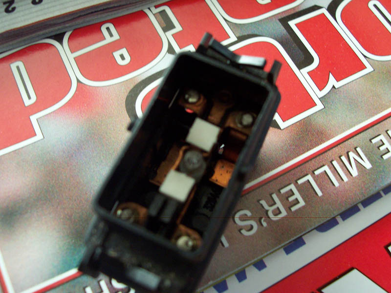

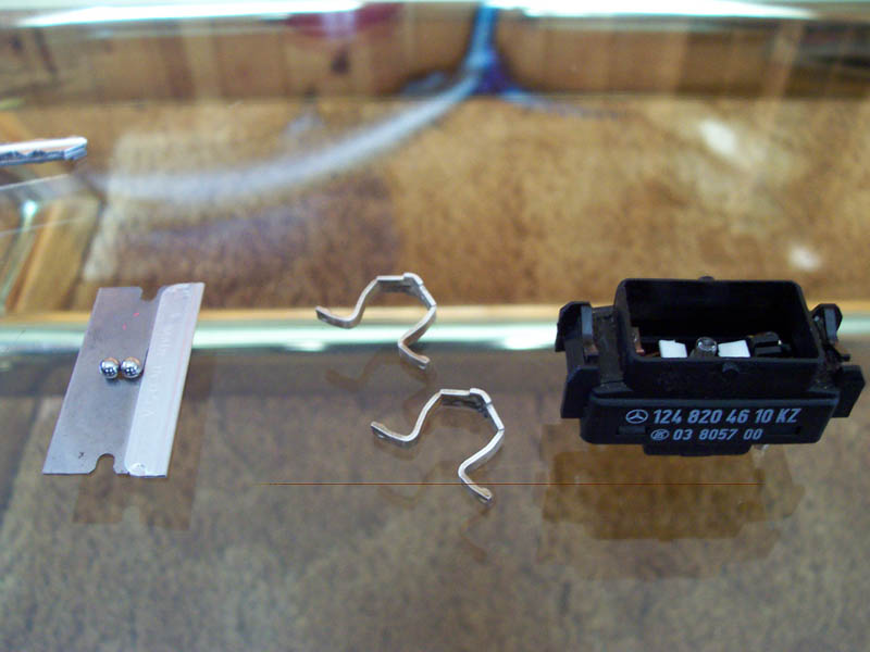

got them out. i was afraid, but all you need to do to actually take them out is just wiggle them out. there is no wires attached to the actual wire. but i dismantled the inside of mine to see what was still wrong with it. how are the little metallic ***** supposed to be arranged?? here are some pictures

I'm noy sure, but I think the ***** go on the end of the springs shown in the second photo.

yea, they do. i opened up a good one and i set it up the same way but it still performs the same way... when i push up, it doesn't click correctly. when i do push up, there is no click and does work well. im hoping to find some on the internet. and is there a way to replace the bulb inside? 3 of mine don't work, one does. odd

How about swapping the good one with the bad one - assuming the connection geometry is the same and not left-handed. This should help isolate the problem.
