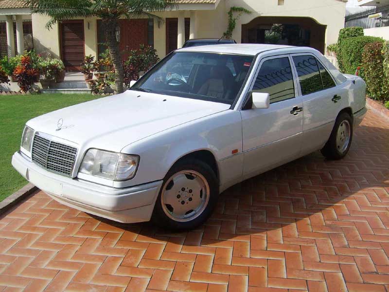

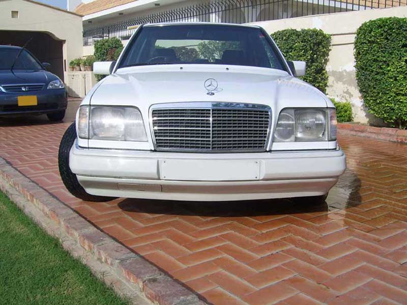

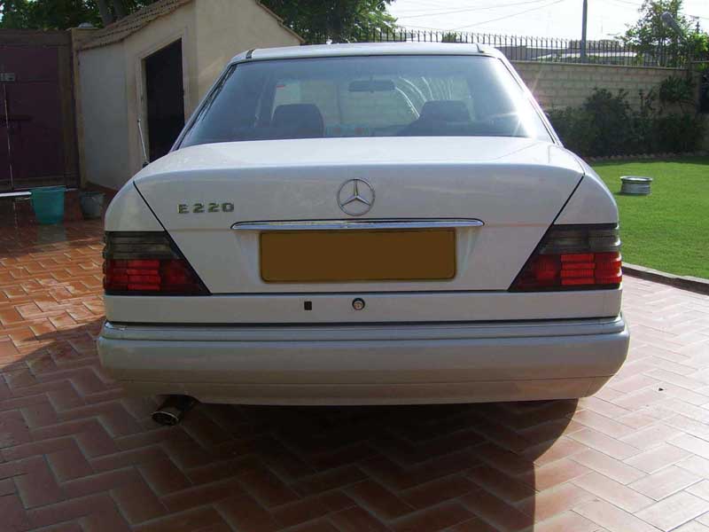

I live in Karachi, Pakistan, where the roads are beyond pathetic. There are pot holes and speed bumps all over the city. The muffler and probably few other parts of the body are always grinding against the these bumps. Specially if I have two big bodies sitting in the back.
I am attaching pictures of my 124, as you can see it rides very low, which normally is a good thing but I really don't want to subject it to the grinding that it goes thru every day on the roads of Karachi.
So whats the best way to get it up? I will settle for 2 inches if 3 is not possible.

you may need to get custom springs and longer shocks, but you may be able to use springs from a v8 model which may raise it more. and ue the thickest spring pads.

Bilstein Heavy Duty shocks may help your situation. They have been known to increase the ride height on many owners’ vehicles. At the very least, they should help support the weight of passengers.
For the spring pads, just check under your car to count the little bumps on the ones you have now. The little bumps are at the lip of the rubber cup that sits on top of your springs. They can be hard to see, if they are rotated in toward the suspension, but you should be able to find them if you look carefully. If you do not have 4-bump pads, then you should be able to add a little height to the vehicle by increasing to 4-bumps. The pads come in 5mm increments and a change of 5mm (1-bump) in the pad can translate to about 7mm at the fender lip.

Yeah definitely the 4 bump pads while switching out any shocks. You might get more than 7mm each though. I had switched 2 bumps down in the rear and it was more like 11mm each at the fender on mine... depends on what you have to start with though. I had 3 bump OEM.

He has an e220 which is a 4cyl car. if he put in springs designed to accomodate the v8 model which is a heavier engine, I would think that would raise the car up. Longer shocks would be if he was able to even find some.
And the statement that shocks do nto raise a car up is BS, I put bilstein hd shocks on my car and my car does sit a bit higher than before I put them in.
So they do help raise the car a bit, but the springs combined with shocks raise the car. probably because the shocks have a stiffer compression so they don't compress as much as a softer shock will which in turn in effect raises the car.
before I put in my bilstein hd shocks, I couldn't even fit my pinky between the rear tire and the fender lip, since I installed them I can put my middle finger inbetweent he tire and the fender lip.
