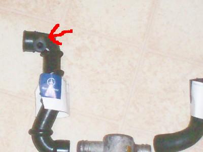

whats this hole for?(ICV hose)
I just purchased some new rubbers for my 89 300CE's ICV...I'm not sure if this hole belongs... .I took out my ICV and put in a plumbers valve awhile ago...To tell you the truth I dont remember anything attached to this hose.What goes into this hole ?Sorry about the bad pic...

Found out the cold start injector....I hope this helps with this funky idle issues I been having.

Not quite sure I understand what the answer was.
I have the same question.
What is the hole for?
BR
Viggo

Hi there,
you are correct, the cold start valve will fit into the hole.
I know for sure!.
