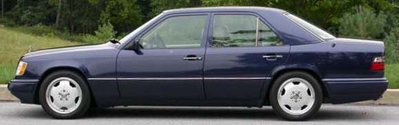

Old May 25, 2007 | 06:48 AM
ksing44's Avatar
Joined: Mar 2002
Posts: 826
From: Southeast PA
2010 VW Golf TDI
http://www.bnzsport.com/forums/showthread.php?t=4477
Here is a suspension thread from another site. There are all kinds of models, not just W124, but I think you will start to get an idea of what folks are typically selecting for the brands of springs and shocks and whatever.
Just note that whatever you choose, it may take some trial and error to get the set-up just right on any specific vehicle. You might get lucky and get it right the first time, but you may also have to go back under the car to switch pads or add camber adjustment or who knows what.
If I had to start from scratch, I think I would try:
H&R springs
Bilstein Sport shocks
Sportline swaybars or maybe “Sportline Plus” (Limo front & E500 rear)
K-Mac eccentric rear bushings
Plan to sort out spring pads (1-bump to 4-bump) to get a symmetrical drop.
17” x 7.5” ET42 with 225/45/17
I love my set-up now, except I still need the swaybars. It is not the above set-up, but I think I would try the above if I were a noob.
On my 1995 E320, I currently have:
Eibach springs
Blistein HD shocks
Stock swaybars “STILL!”
K-MAC eccentric rear bushings
1-bump front pads & 3-bump rear pads
16” x 7.5” ET37 with 205/55/16
Side view of mine
