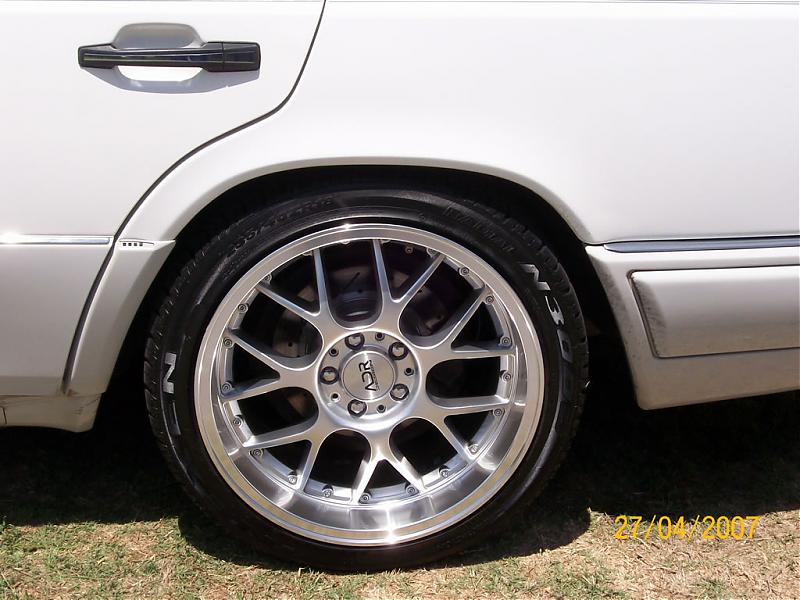

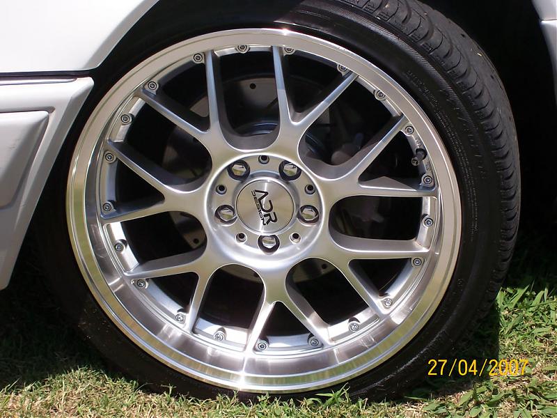

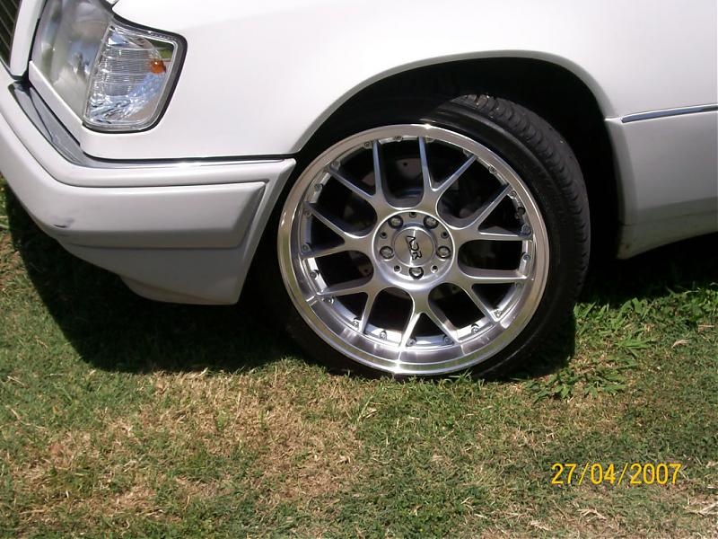

By the way, your car looks awsome, what type are the rims. Any pics? Have you lowered it? Personally, I always loved W124, particularly the E500/500E. And would love to get one someday.

Thanks! They are 18" ADR M-Sports. I like the TUNER style wheels.
Not lowered yet, trying to get some money for Albert's(AS Design's) E500 Carbon Fiber Hood & Body Kit, then I'll lower it. But first, the car is kinda dead right now. So I'm negotiating an E420 from someone and then I'm fixing the E320 later as track car.
Just taking the plans step-by-step.
