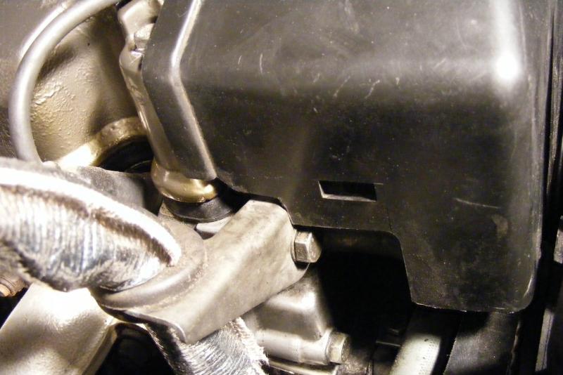

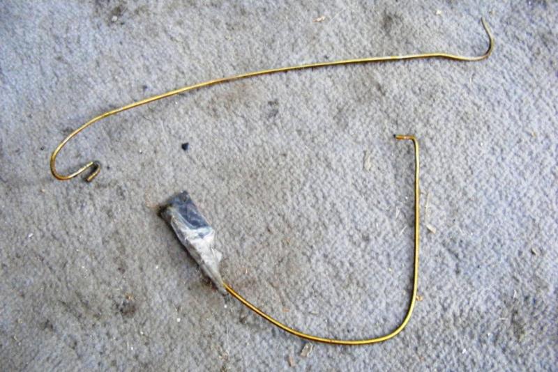

Originally Posted by rivcal4life
Haha I did the same thing with my engine mount bolt when I changed the mounts.
Even after reading GEDgagget did it too. A magnet tool got it out fine though.
My magnet tool is too straight with a 2" long magnet so it wouldn't fit. I taped a magnet to a wire but it wasn't strong enough to lift the bolt so I moved the bolt to the 1" drain hole and hooked a wire to it and lifted it up to where it fell in.

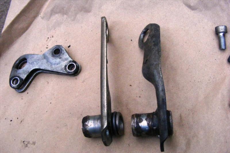

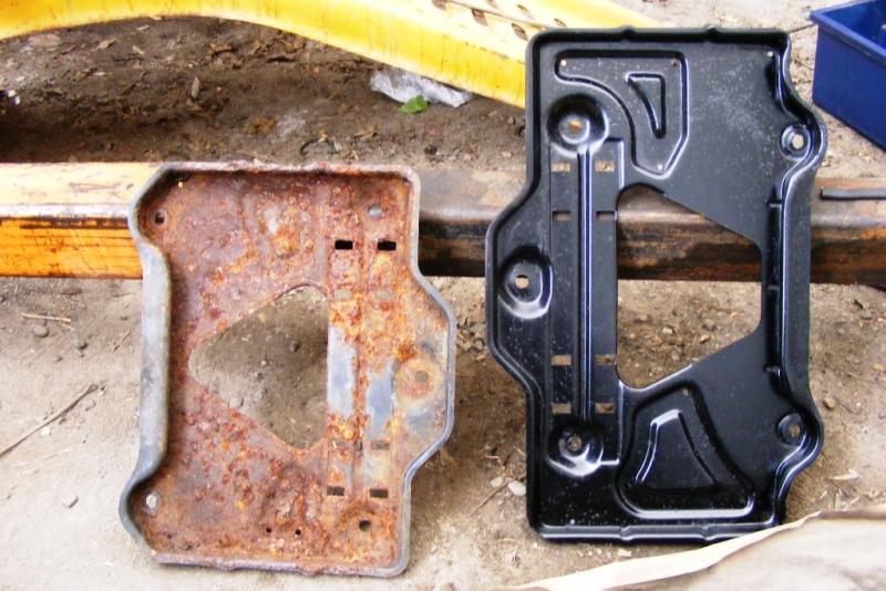

  • Found battery tray was very rusty and I sold a perfect one from my wreck a few months ago
  • Found my steering dampener is leaking, damaged during engine removal
  • Was surprised how much the driveshaft can slide front to back
  • by not keeping the shift rod attached to the trans, also need to replace the bushing on the lower shifter arm
  • I'm concerned I bent the condenser tube, there's not much flex in them which is why the tubing on the original broke

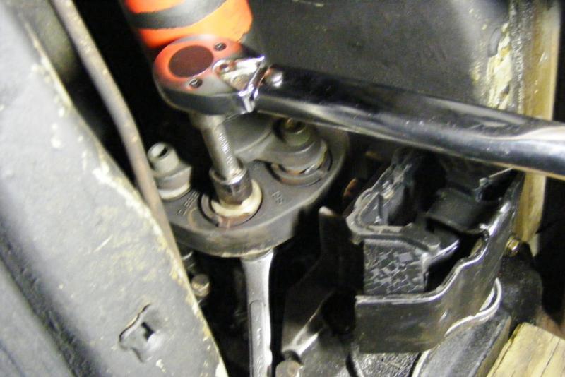

  • Bought another torque wrench and tightened flex disc bolts to 44 ft/lbs, hope it's correct, the book was not clear
  • Finished bolting in the driveshaft, trans mounts, exhaust, now I'm ready for a beer to wash down the oil and dirt. After I finish attaching all the wiring and installing the radiator, she'll be ready to fire up!
Attached Thumbnails Bought an '88 300TE for my RENNTech 3.6L!-dscf4366c.jpg   Bought an '88 300TE for my RENNTech 3.6L!-dscf4374c.jpg

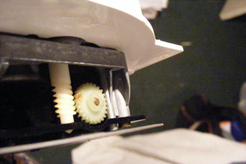

It rained today so I didn't get as much done as I planned. I only dropped a screwdriver and bolt on my head working under the car so it was a good day.

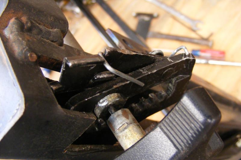

  • Removed the shifter assembly and installed a Zebrano knob. I found other subtle difference in that the top cover snapped in, even though the holes are there for the 4 screws. I was going to replace the Zebrano shifter panel with one from my '87 but all the buttons are held to the panel. In all the 300E's I've owned the window buttons are held in a plastic frame on the console. I cleaned the console carpet, I always wring out alot of coffee...
  • Replaced the firewall top padding that was damaged during engine install, routed the battery cable and starter wires
  • Installed the shifter lever linkage, I found the adjustable end needed to be rotated 180 degrees or it would hit the flex shaft. I also tried to fit the spring clip with 2" of clearance until I realized I could unbolt the lever at the transmission...
  • Installed the AC condensor and radiator, still need to recheck all the connections and clamps
  • Found a nice battery tray but it was the long version because there was only one 300E in the yard
  • Replaced the bent engine hooks and put a new o-ring on the heater side

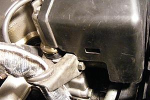

  • Another issue was the distributor cover wouldn't fit on the bracket for the SLS line so I had to notch it. When I got the car, it didn't have a cover or the plastic holder.

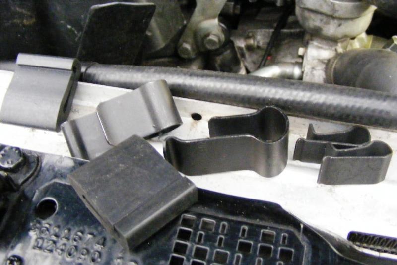

  • Installed a new rad clamp kit, given the rubber pads were missing. The clamps were a pain to spread while pushing down

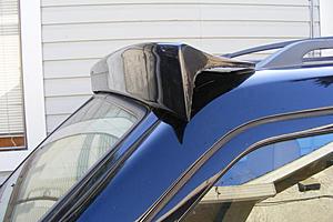

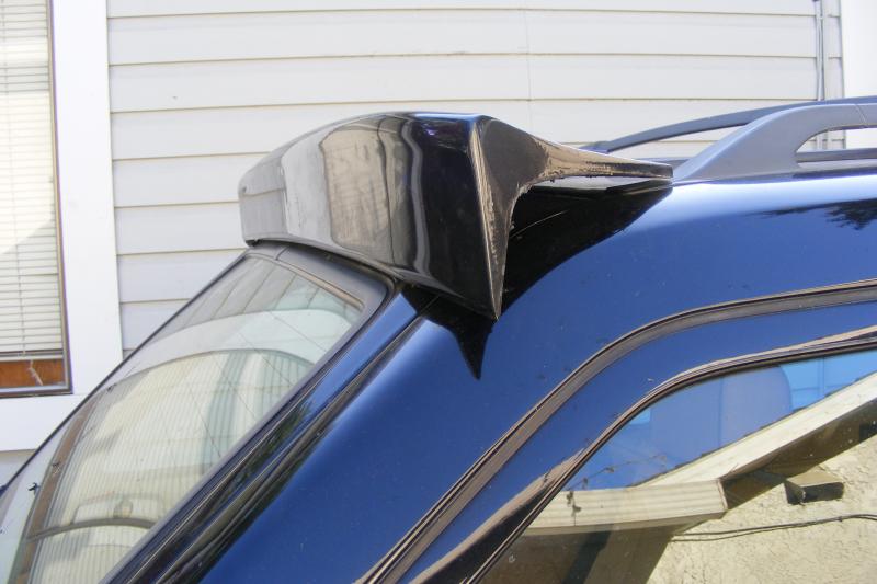

I got the later cladding on (I spent $100 on only half the clips that weren't reusable) and most of the little details fixed. Need to find R12 as i don't want to convert to R134a.
Thought I'd put it out there and so far have 3 possible buyers, oh it's going to be hard to let go...

I placed my AMG spoiler up on the rear hatch for a mock up and the arc was a close match. I can either make a splash mold and modify it or form a polyurethane foam piece. I realize most wagon spoilers have foils that divert the air down but I'm going for aesthetics...
I postponed selling the car as I'm having way too much fun with it. Acceleration is exhilarating. It will be even more fun when I stiffen the suspension.

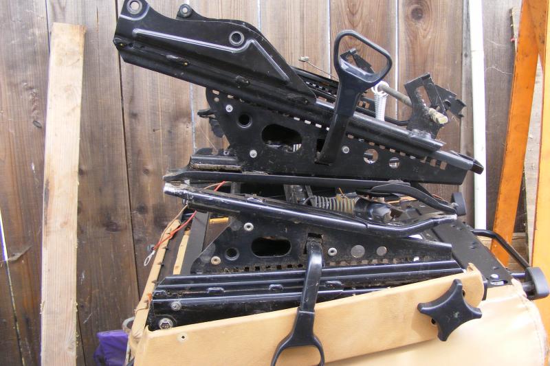

Recaros are Awesome!
The feel is so supportive with multiple lumbar adjustments, heat...
I was very fortunate to find rare manual seats in a dismantler yard thinking I could adapt the factory sliders. As it turns out the Recaro adapters bolt directly onto the factory sliders. I already have factory sliders on the Recaros but there are several versions with different brackets including different L and R so they did not fit. The drivers side adapter was modified to accept the knob angle adjustments but restricts movement so it's a useless feature. The passenger side Recaro adapter was not modified at all so I'm going to cut off that feature on the factory slider. The level and angled slide features are all that's necessary. Some have adapted the power bottoms but given how high it places the seat, the vertical adjustment is not practical and the recline is redundant. Factory plastic finish side panels were drilled and screwed onto the bracket but I plan to secure them for a better fit. I also need to adapt the factory seatbelt receiver so the SRS light turns off.
Here are the hole pattern on my '88 +/- 1/16":
Front left to right: 18 13/16"
Rear left to right: 18 3/16"
Front to back: 11 15/16"
My Keiper Recaro bracket PN are:
Drivers 362472
Passenger 362316

Odometer & Recaros
I finally took apart my instrument cluster because my odometer and tripmeter never worked, I'm afraid to check how long it's been stuck. I actually swapped one in from my spares but the lights wouldn't work. I was going to swap the rheostat when I noticed the gear was pulled out and not engaged with the screw drive. I pushed it but am not sure how long before it slips out again. Seems there's nothing to keep it in.
I acquired 3 drivers Recaro Ideal C basket cases and began to test the air bladders and heaters to see if I could build a pair by moving the seat tilt knob and controls to the opposite side for a passenger version. They're missing the hinge covers and a pair of knobs I'll try to duplicate since they are NLA. I also got a headrest with speakers.
FYI, I weighed the stock power seats at 64 lbs and the Recaros with manual sliders and adapters at almost 71 lbs. Why so much more without motors? The factory sliders have two ranges of adjustment, actually 3 but the front tilt knob doesn't work with Recaros and weigh almost 12 lbs. The adapter is thick gauge metal weighing almost 7 lbs. The seat itself has only 1 seat back angle motor but also has a pump and all the adjustments have brackets and linkages to weigh over 52 lbs.

On ur speedo meter do you carfax report so when you det it working gain its not mark with tampering of odometer.
Your will will slip out again. Remove your gear and slip a toothe pick (i used a hose from a wd40 can) And pull ur gear and shaft out. takesome dikes and ruff up the shaft. push the gear back in.when you get to the last gear it will be a mmm getting in. I used two flat tips to hold the numbers and pushed the shaft back in and then your odometer is fixed.
