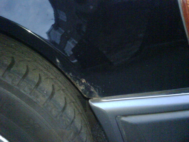

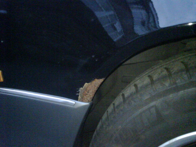

OK, tonight I decided to give the car a quick wash, used a jetwash.... and the paint blisters came off.... The car does need a new wing on the passenger side, the rust really is bad, on the driver's side it seems to be surface rust in the corners, where the wing (fender) meets the front bumper and where it meets the plastic trim. You can see the rust on the passenger side on the attached images (remember I'm in the UK so it will look like your driver's side :-D)

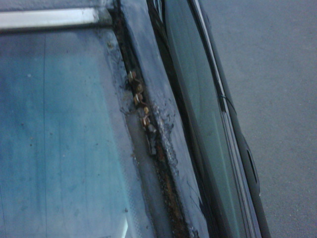

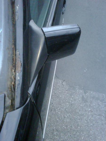

My major concern is rust on the A post and roof. Looks like at some stage the car has had a replacement windscreen (windshield) and it wasn't done right. It looks to me like they didn't seal it right and ended up squirting some extra silicone that was keeping moisture where the chrome/platinum coloured trim goes around the windscreen and on the roof. I've also attached some images of the A post rust.
I took the trim off and it doesn't look good. I think ideally I'd need to cut out the windscreen (windshield), do the repairs and then fit the screen once it's ready.... Has anyone done it on a w124?

I've done a ton of rust repairs on older cars and I can tell you that to fix that windshield pillar rust, I personally would cut the windshield out, sandblast the area clean, then weld up any holes that might be present, do a little bodywork where your welding/blasting took place, then paint and put the windshield back in.
I would do the same with the front fenders, blast the rust areas super clean, then fix any rust holes and smooth out the area. I wouldn't replace a whole front fender for that little rust spot. Then I probably would repaint the whole car including the lower body cladding so it's all one color. The cars do look much better all one color instead of the two tone which I have never cared for.

Well, I wasn't looking to replace the fender I posted pics of.... that one can be repaired.... The other fender has lots of rust holes and it's not worth patching it up, a new one will set me back about $60.
Wish I had access to a sandblaster! All I did so far is I cleaned the bulk of the loose rust.... applied some rust inhibitor and then a bit of primer and top coat.

Do you think it will be possible to blend the new paint on the side of the A post and on the front section of the roof (where it meets with the sunroof)? I REALLY don't want to paint too much.

Is it a big job to cut out and refit the windshield? I don't want to damage it when I take it out. In the old days I used to replace windshields on cars where they used to sit in a rubber seal.... never did a new style windshield that is glued onto the body!

try some merc breakers to see if the have any good wings in the same colour and just get a get the the one area painted A to C pillar, personally I think you should leave it two-tone but thats just my opinon. The chrome trims are really easy to remove for the cladding if you have the right trim tool
I would leave the screen to a pro get the screen taken out where the car is being painted then put back in after- keep us updated

Once the garden is looking good, I may spend a few days getting the car up to scratch.... I'll probably cut the windscreen out myself, otherwise it will get all too expensive.... If I do the prep work myself (and I have done it on several cars in the past with good results), I will just have the cost of materials and that's not that much, if I start subcontracting work, it will get expensive.
