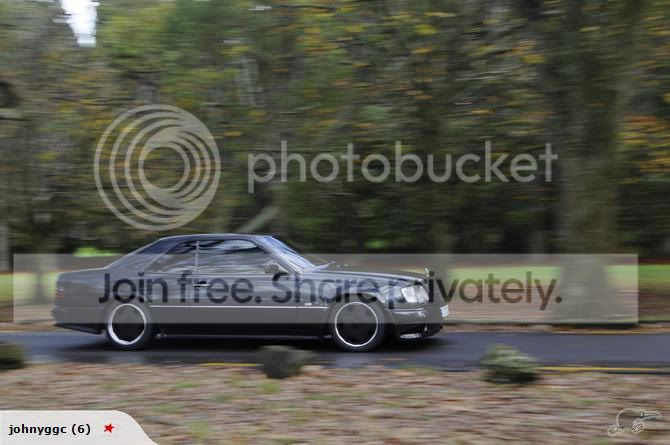

Hey Guys
Well as some of you know I bought a 320CE Benz about a month back which was reportedly a 3.7 Brabus engine - odd as Brabus never made a 3.7, haha!
I have confirmed it is in fact the 3.2 Mercedes Motor, with a Brabus tuning kit - cam and control module which takes the motor up to about 180kw and 340nm.
Now while this is OK and it is certainly no slouch, I am already missing the power and torque of the AMG 3.6 motor, so here begins my hunt, and hopefully a project!
What I aim to do is as closely replicate the original AMG E36 coupe, with a few twists for superior performance.
Obviously I already have a full genuine AMG Gen I bodykit, and genuine staggered 17" AMG Mono II alloys (although I wouldn't mind finding an 18" set again) so the car is almost there exterior look wise.
What I do need/want to add is the AMG ducktail spoiler and genuine AMG exhaust tips, colour code the wheel centres, and leave the lips polished.
I plan to replace the cloth interior with a black leather coupe interior - all 4 seats, headrests and door cards - I know of a blue one for good money that I might just get redyed...
And of course the important bit - the 3.6 AMG engine - which I think I have located!
I plan to keep my 5 speed transmission rather than the 4 speed from the C36/E36, and 3.06 ratio diff vs the 2.82 of the C36/E36, this means I will have considerably better acceleration while still enjoying low motorway revs.
I will get some nice tubular headers made up for it to replace the cruddy log style ones, and have a true dual 2 1/4 exhaust system with x pipe crossover made up.
Other things which would be good to do are a P&Ped head, and adapt E34 M5 manifold and E36 M3 ITBs, to the motor which Carlsson successfully did on their 3.7 motor, but shall see when the time comes!
Suspension wise the car is good and it already has nice 4 pot stoppers with decent sized discs - although C36 brakes would be nice.
This will not be a quick project, more of a long term goal, as I see myself owning this car for a long time - one of the coolest looking cars ever IMO :P
Currentish pics of car:
Wheel Plans:
Any feedback, suggestions would be great.

CAR LOOKS GOOD!!!

that does look beautiful, do you have any pic of the interior?
I like the brabus exhaust tips, if that were mine all i would do is debadge it.

It really does look great. I don't get why someone would misbadge an actual Brabus modified car tho.
